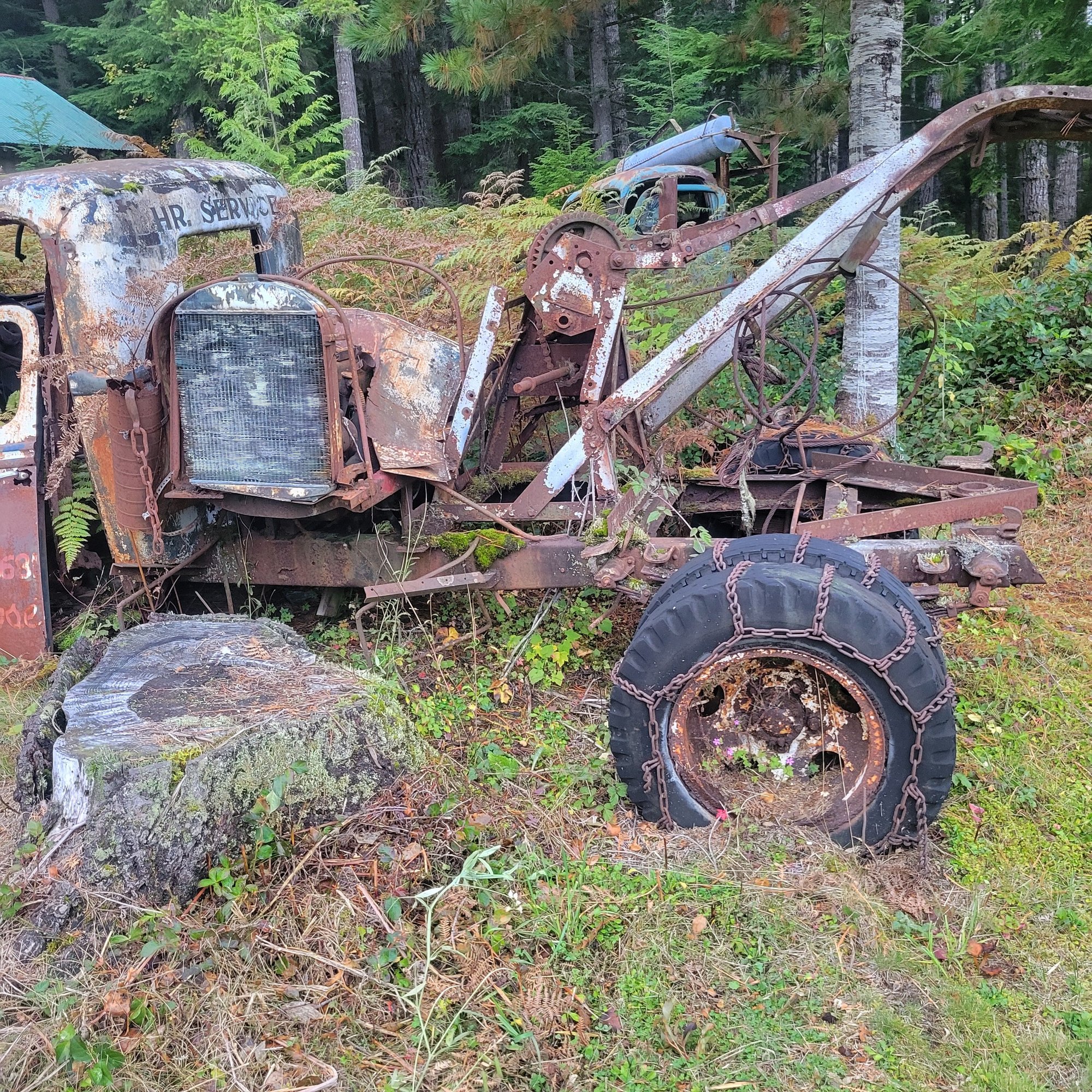

Can someone please help me identify the year and model of this truck. thanks in advance.

Looks like a 1941 Ford Regular Truck to me at a quick glance. Engine and Wheelbase determine model from 01T, 09T, 018T, or 098T.

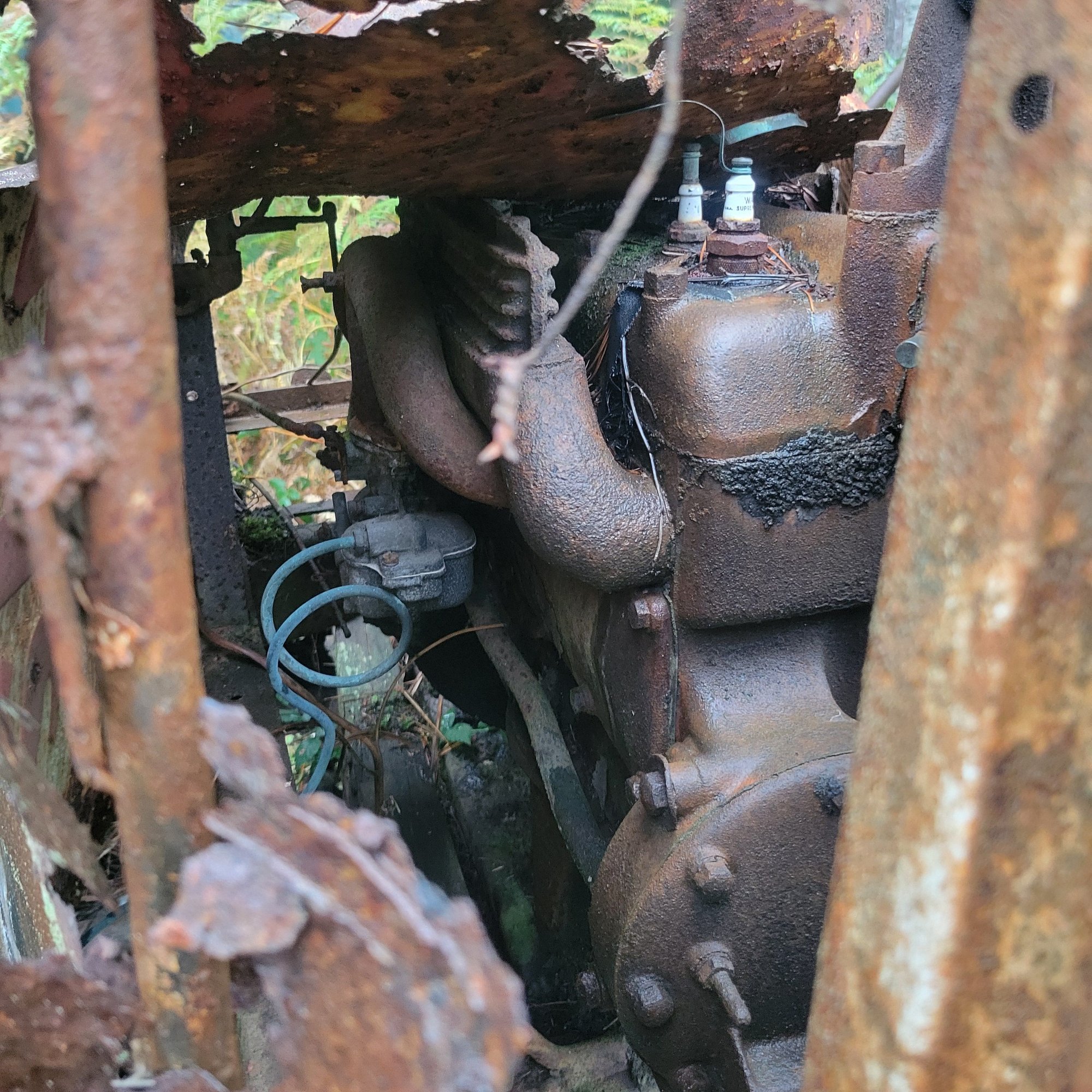

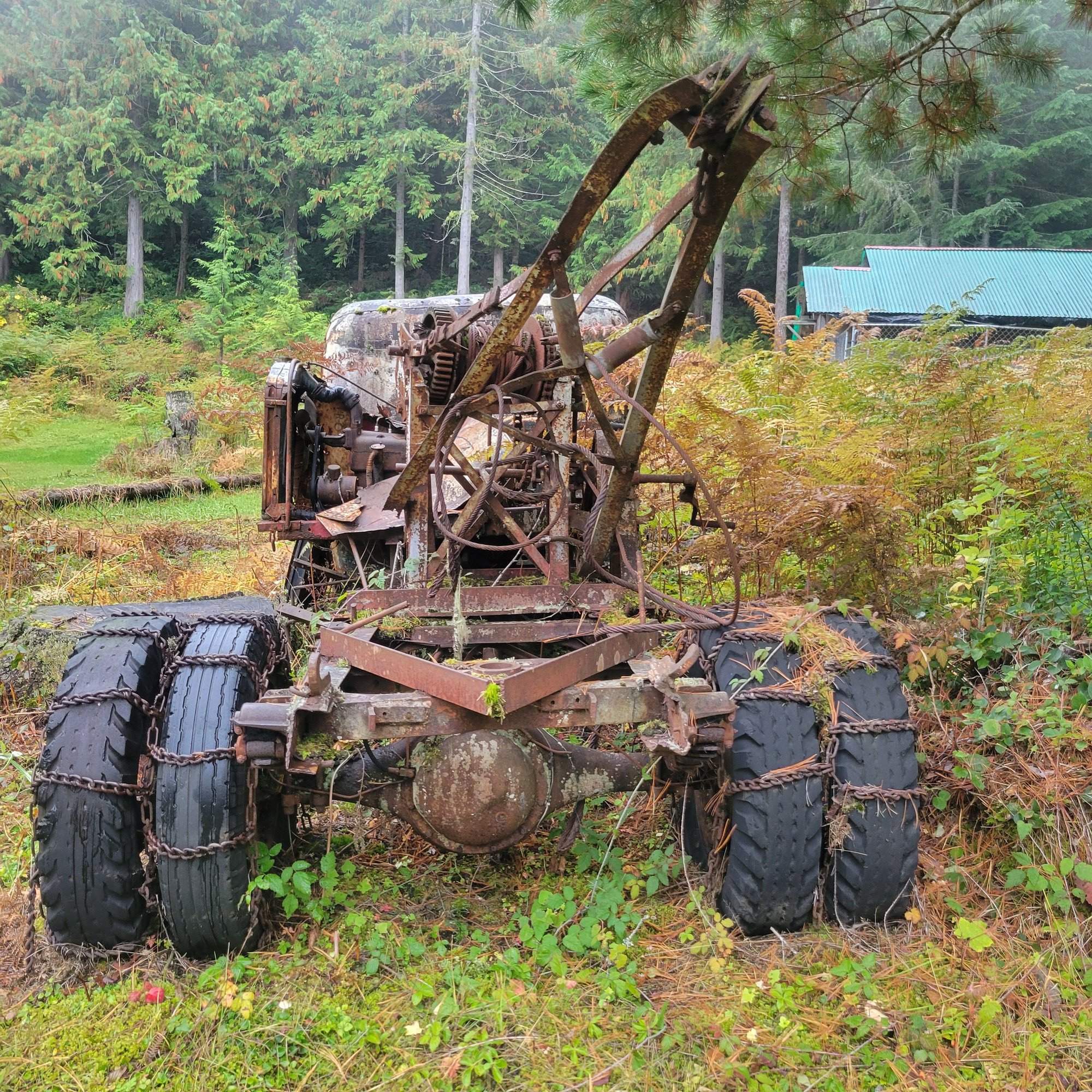

Definitely a 1941 Ford as evidenced by the waterfall hood ornament and the hood itself. The dual rear wheels make it a 1 1/2 ton. The wrecker assembly on the rear would have some value to the big truck crowd. The engine assembly behind the cab is interesting as well. Maybe a welder or compressor using a flathead for power?

Fantastic – thanks for the quick response. OK, first step accomplished. Raining here now. I will post more photos tomorrow. This truck, and what I believe is a 1948 1.5 ton or larger truck behind it, were originally out of Bremerton, WA. The ’41 was used customized into a log skidder. The ’48 was used to haul logs. I was told the water tank on top of the ’48 dripped water onto the brakes to cool them while driving downhill with a load. Both engines and transmissions are likely good as they were parked running, carbs and some motor electronics pulled and motor covered with plastic. Intake looks good inside. But they need attention now to stay that way. I hate to see them rust away as yard art but I realize the trucks themselves are beyond restoration. I would like to rebuild at least one of the motors as a learning experience and fun. I don’t have a use for it and would just sell it afterwards. I need to make sure I won’t lose money in the process first. I’ll post more photos of both and questions tomorrow. Really looking forward to doing something with the parts of these trucks that are salvageable. I would prefer to see someone use what’s useable than watch them rot. I love the wrecker/skidder – sad it so far gone. I’ll be back…

And yes, that’s a 4 cylinder flathead on the back driving gears to winch logs. It was pulled to the side and broken – likely why it was retired.

Looking at the photo of the hood again, the waterfall and latch assembly look to be in great shape. These are a one year only item and specific to big trucks 3/4 ton or larger. The center stainless strip looks good as well as do the hood whiskers.

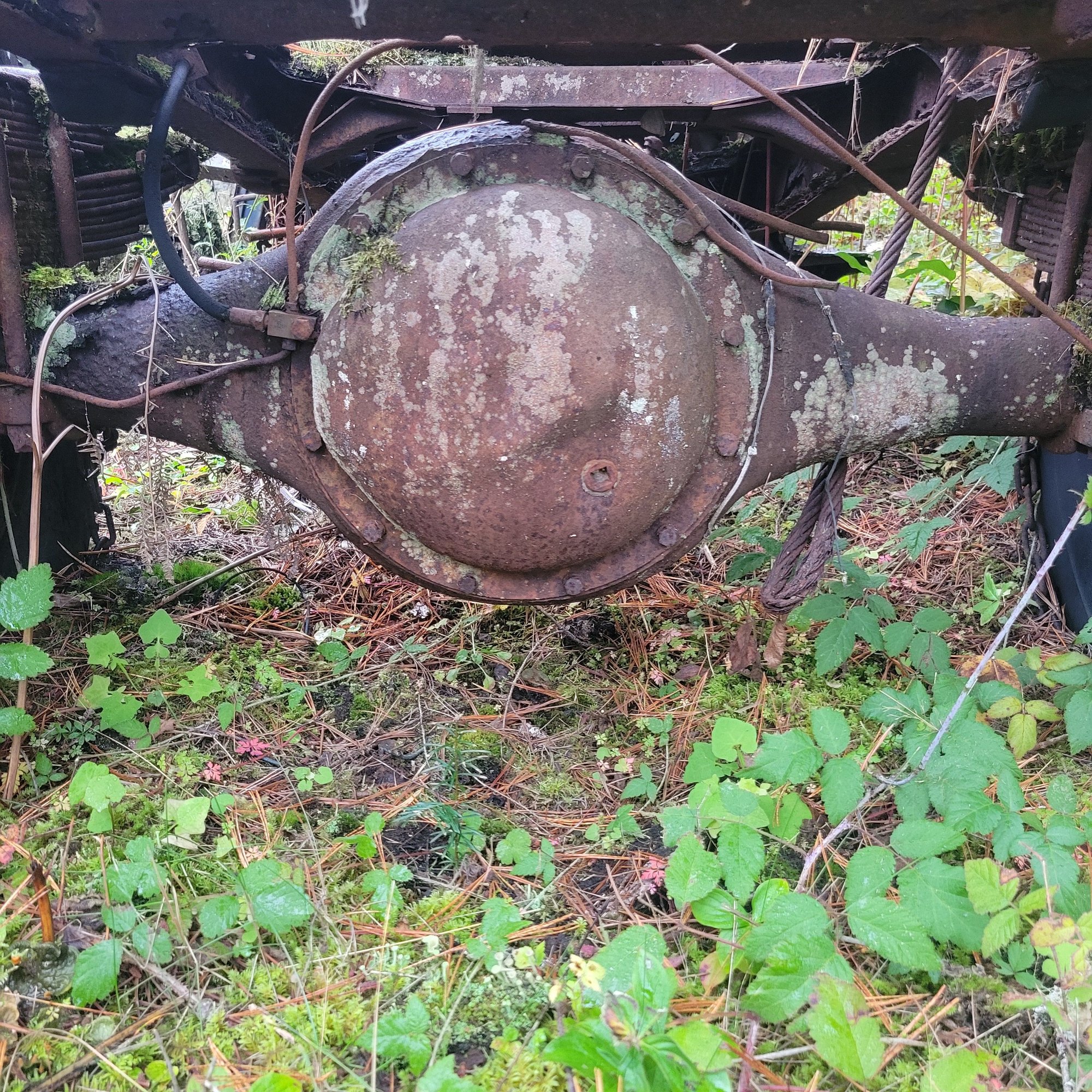

Read End and Winch. Any feedback is appreciated. Hoping the rear end can help determine the exact model. I’ll have to poke at that rust on top – looks bad.

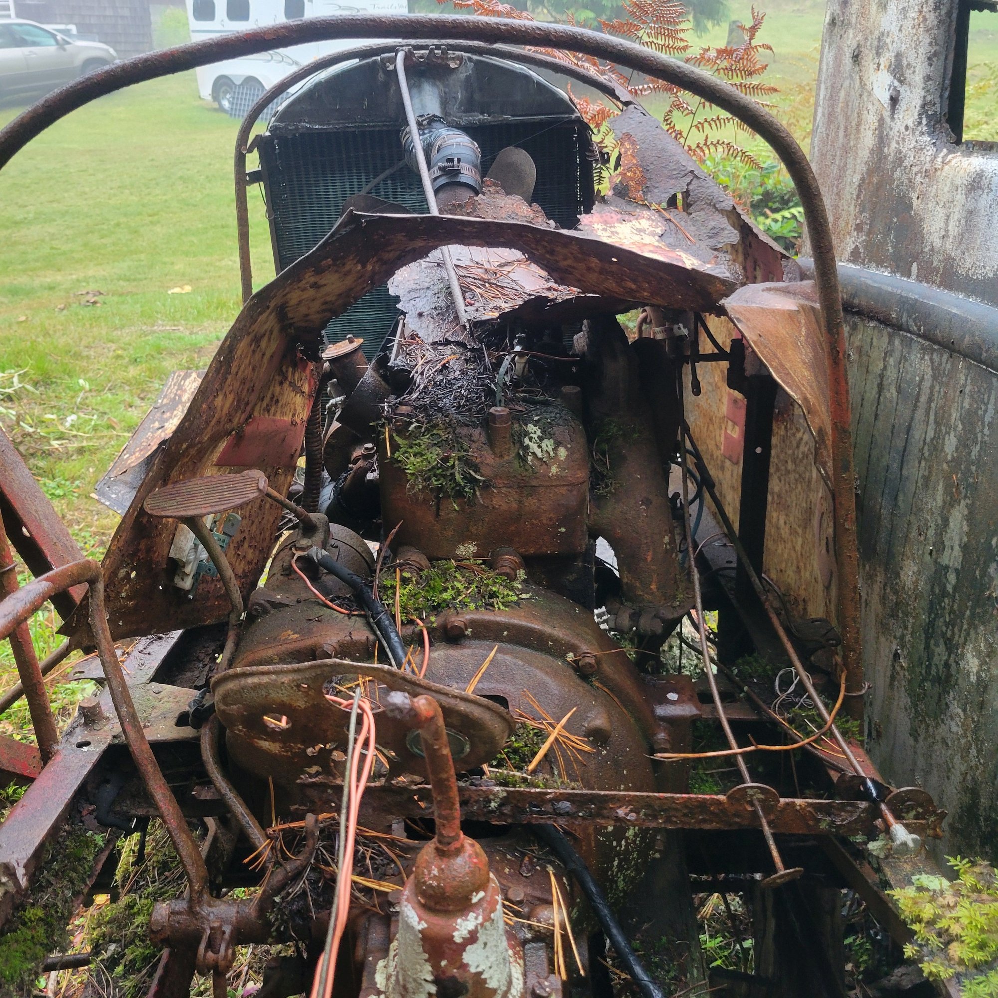

4 cylinder driving winch.

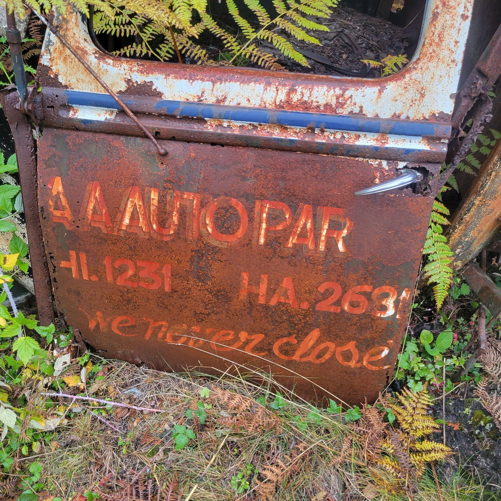

interior and cool info of history. I just love the customization on this truck - so sad its so far gone. the pacific northwest is a harsh environment for vehicles new or old.

Rear end seems to be a cable operated 2 speed. Think it might be from a later year but not positive. 4 banger is from a Model A from what I can see.

The 4 cylinder looks to be in decent shape - but that's relative to the rest of the truck - not to what's available. Intake and carb look to be kind of protected there on the side of the motor. Assuming the truck as a whole is not of value, should I remove the 4 cylinder and put it in my garage for now?

Based on the damage to the winch rig I would guess the motor was running when retired. I'm gonna clean the junk off it and post more photos.
