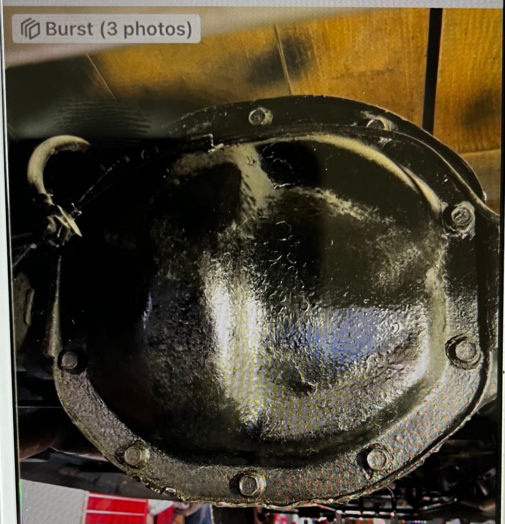

A picture of the axle and diff cover would help.

Old Oct 16, 2024 | 10:29 AM
wardair's Avatar
wardair
8th Gear
Joined: Jul 2024
Posts: 8
back end of differential cover not sure what else to try to show?

not positive, but i think that is a ford 8.7 rear axle

what vehicles would of used a 8.7 axle then if that is what it is? I think the pinion nut is 3/4 by 20 ? I thought it might of been a 7.5 or a 8.8..... the differential gaskets look different from each other. Do you happen to know anything more about the 8.7 axle then? thanks

With that bolt circle it's a car axle.
What are you installing it in? It would probably be unsuitable for truck use

8.7 was only used for a few years, 75 to 78 if i remember correctly. it was basically the test bed for the 8.8 axle. they were used in the granada that i know of. \probably also the 6 cylinder LTD's too
