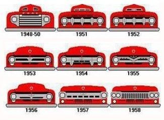

The glove box door (actually called dispatch box back then) looks more like a '52 than a '53.
An F6 is pegged as a "medium duty" 2-ton truck.
Here is a look at the fronts, to help you figure it out:
