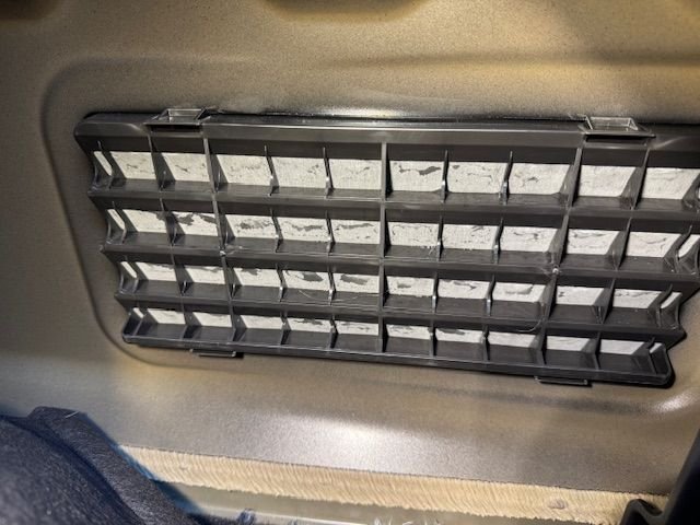

Sure, here are 5 pictures from the inside. I tried to take a picture of the outside rubber seal that was pushed away from the outside cab wall but the camera wouldn't focus on that spot as it's too narrow and far away for the camera to see it.
Inside view of the vent. I think this is the passenger side one and had water all over the top and dripping inside.
Drivers side.
Here is the vent after I used silicone caulking all the way around. You have to apply it with your finger for the bottom and the side closest to the door. No room for the caulking gun. These vents move a little bit when in place. The caulking secures it.

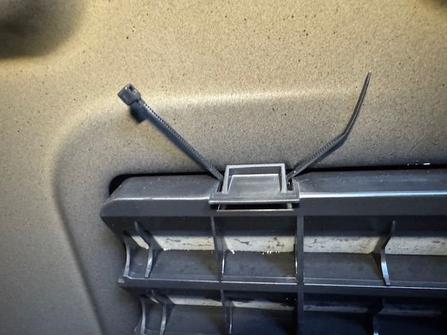

A trick I saw on the internet is to put these zip ties under the clips as they can sag and not stay up to keep the vent in place and it starts to leak. It won't be going anywhere after the caulking anyway. The carpet is easy to pull back from the rear wall behind the seat backs. Just plastic push pins hold it in place.

This is great, I'll be doing the zip tie and silicone later this week to mine! Thank you!

I'll cut the strip lengthwise, then press it along the edge and into the crack between the plastic and body. Seems like it would be easier to handle, than trying to smear some RTV silicone around the bottom, blind.
Good tip, regarding the zip tie. I'll do the same, to keep the vent from being pushed out while I apply the silicone tape.
