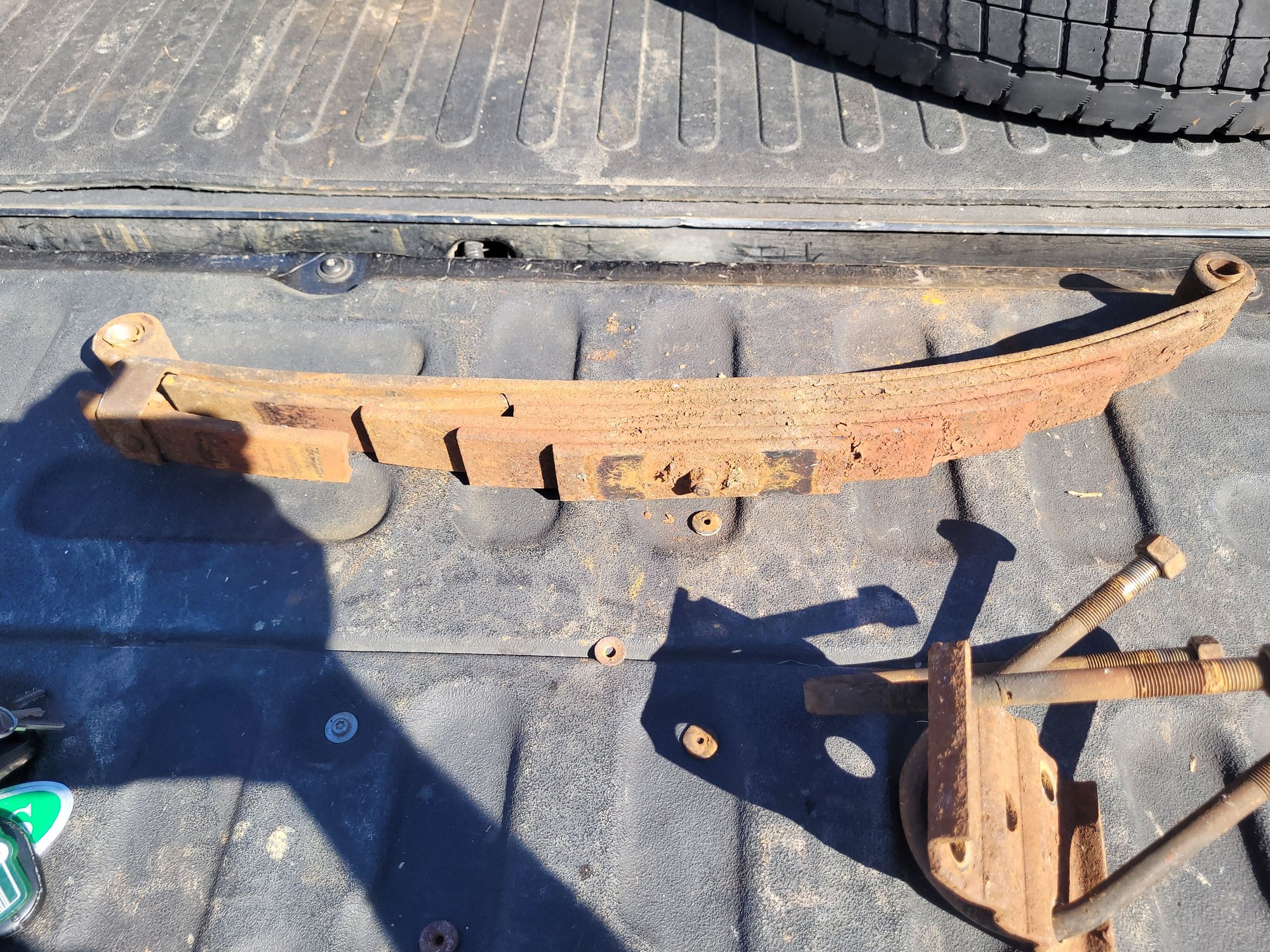

Well was working on the underside belly replacing the screws and putting on bigger washers to hold up the underbelly and much to my surprise I have one broken spring pack.
So these are on dexter 7K axles, anyone have a extra set with U bolts too? Idea's on best source?

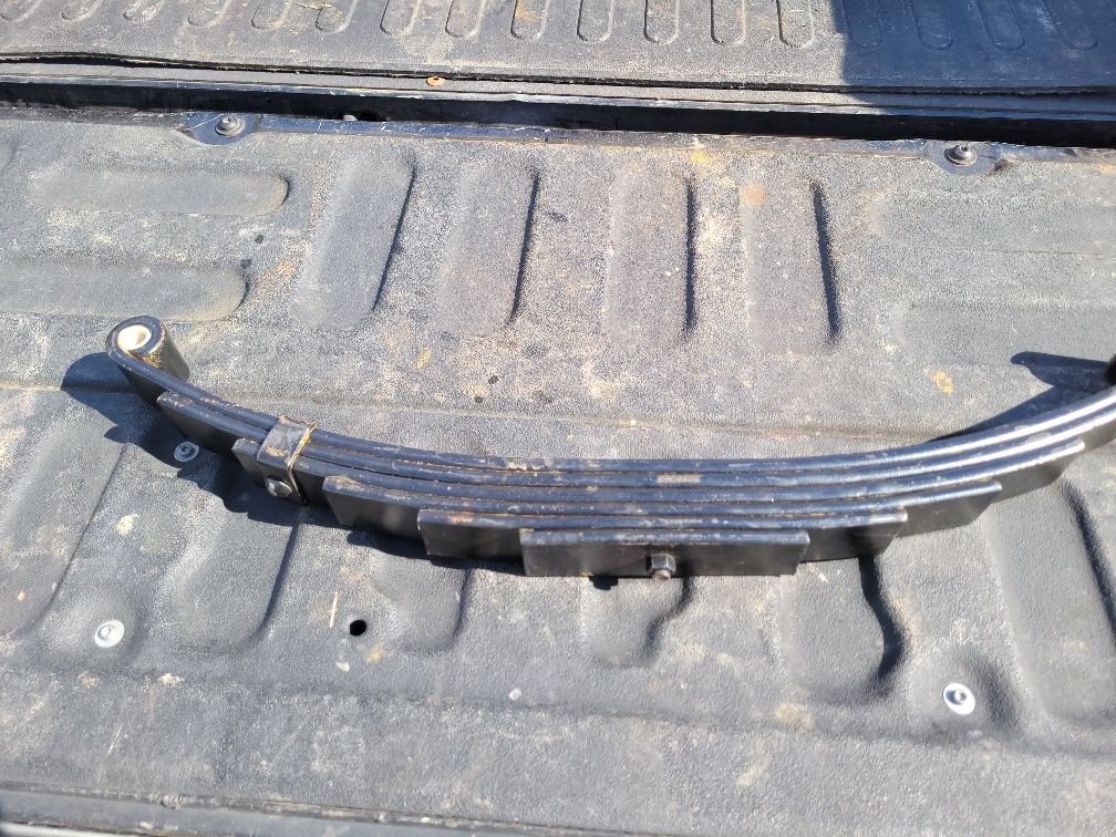

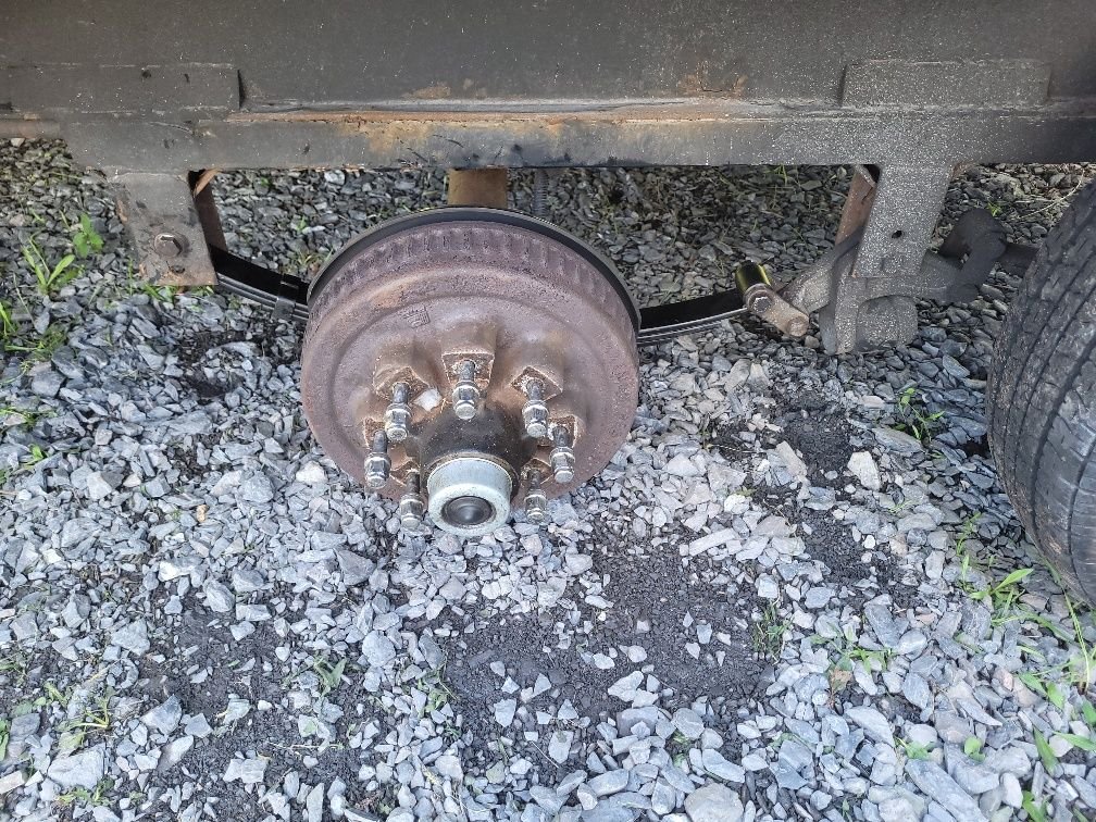

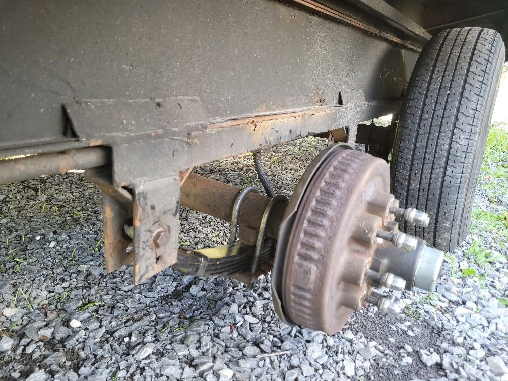

here are some pics.

Scrub that rust dude and hit it with some paint before it gets any worse.

Yeah, good idea! Put the tire on and did a test drive and it all looks good, ready for our winter trip over new years..
