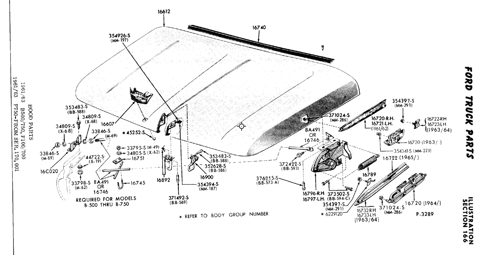

Interesting. Did they come from the factory with rubber behind the hood trim? I'm starting to put mine back on after getting the truck painted. When I removed the trim, I didn't see any indications of there ever being any.
Based on the parts book, looks like there were no rubber pads....
