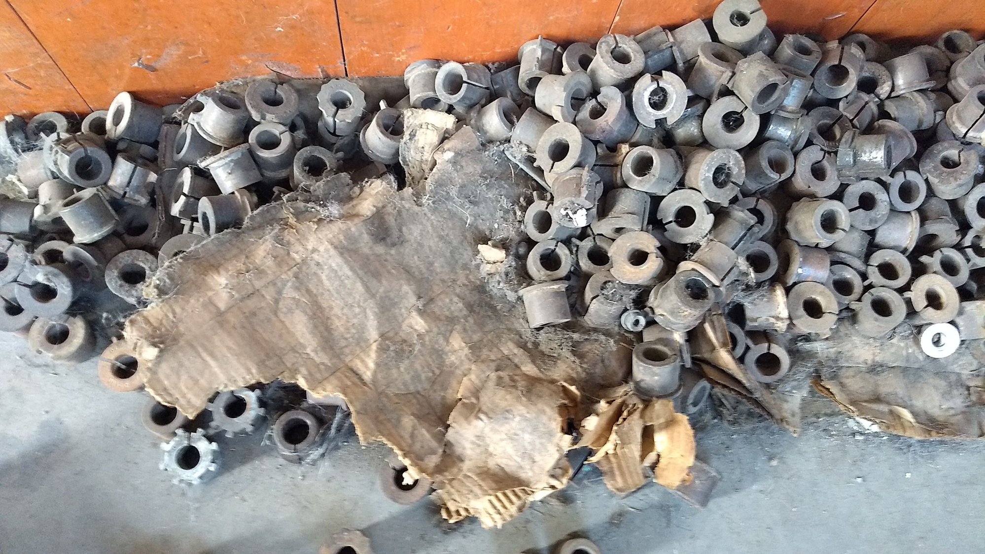

I mentioned that the alignment specialist had a pile of bushings (hundreds) I asked, 'if my truck rarely needed a different bushing, where did all those other bushings come from?' He said 4WDs.
EDIT The bushings

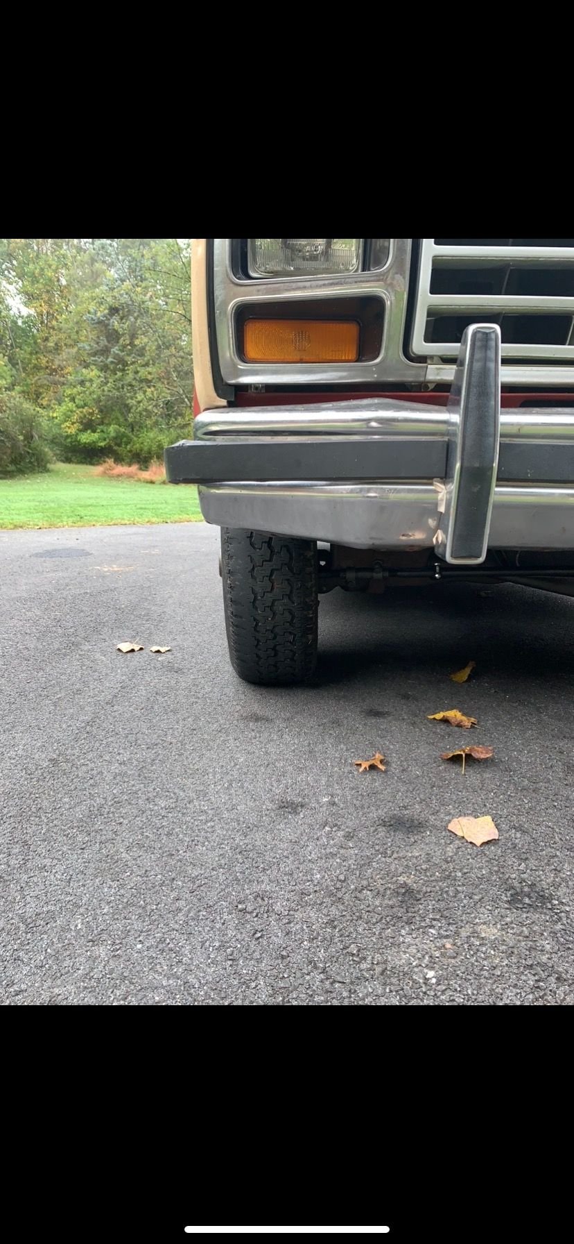

Old Oct 4, 2024 | 07:58 AM
Mountain_anderson's Avatar
Mountain_anderson
Joined: Feb 2021
Posts: 180
Likes: 10
Mountain_anderson
Joined: Feb 2021
Posts: 180
Likes: 10
thats what the wheels look like now along with the current bushings

So you only changed tie rods and this happened?
How far have you driven it since the rod were replaced?
Normally you need to drive it even if you just jacked it up and let the front suspension hang for the wheels to move back where they were.
Put 5+ miles on it, left & right turns and over bumps and check again.
