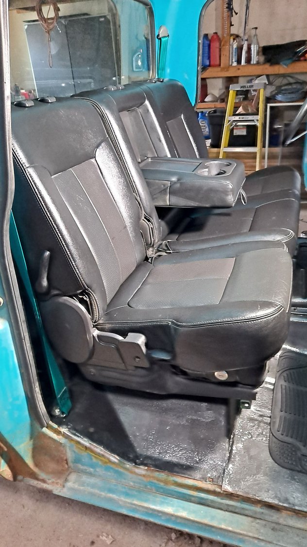

Installed rear leather seat out of a 2016 Ford F250, bought it for $250. Seat is practically brand new as most people rarely use the rear seats. Quite a bit of modification to the mounting bracket, but not too difficult. Love having a cup holder and storage under the seat.
