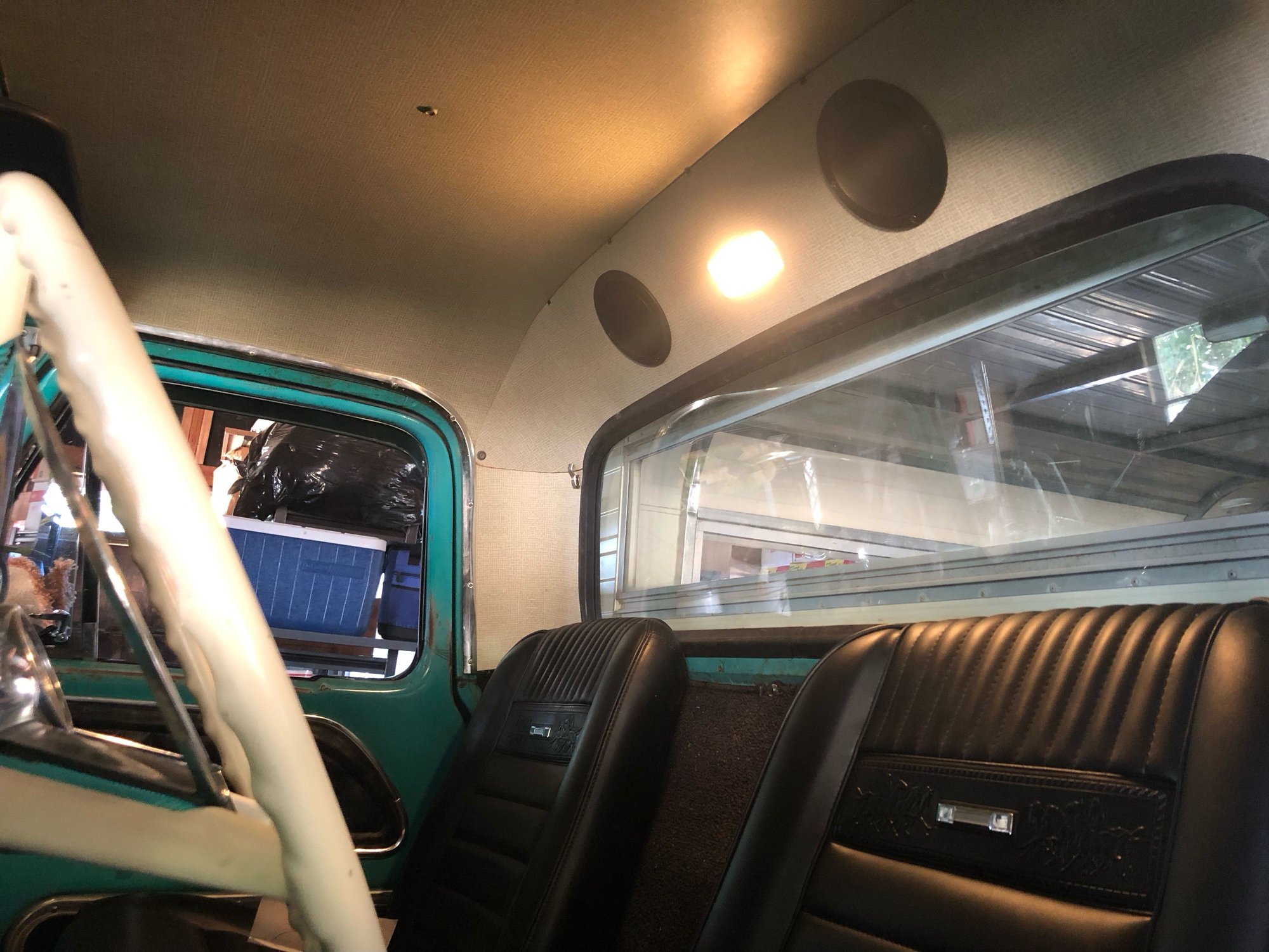

In addition to repainting the camper shell, I also managed to install a new headliner in the cab. Just went with a reproduction of original from Dennis Carpenter. Didn’t have a second set of hands, so it took all day, but I managed to get it shaped and installed without breaking even one piece (quite the feat, judging from all I’ve read and the YouTube videos I watched). Altered the rear panel to accommodate a set of 5” speakers for the small mp3 player in the glovebox. The truck hasn’t had a headliner in the 15 years I’ve owned it so it was time. The dome light lead was still up there, and hot, so that was probably the easiest part of the install.

Really looks nice! That’s next up on my agenda, too. Just installed cab clearance lights , son is coming this weekend to help put in the headliner. I just had to get rid of that Roddoors ABS one .

I thought about the ABS headliner as well but decided that I’d prefer to make it look a little more “correct”. That, and I thought the black ABS might make the cab a lot darker, which wouldn’t be my first choice.
So… for the installation, if you’re doing a reproduction of original, here is my input from my experience… do check out the couple of videos on YouTube; I personally found them to be pretty useful. If possible, warm up the headliner in the sun for awhile… warming it up seems to help with the forming the contours. I would, after my experience, recommend a second person. Fill and use that spray bottle of water on the backs of the headliner pieces! I used maybe 3/4 of the bottle in total. I was thinking I was using too much, but it turns out, not. Take your time and use your patience when manually “pre-bending” the (dampened) pieces, by hand, to accomplish the needed contours for the cab. The two videos disagree on the installation of the top rear panel (with the dome light)… one says to tuck the bottom of the panel into the rear window weatherstrip first, then snap the top of the panel into the clips on the ceiling piece with a hook tool (which to me seemed at first like the more intuitive route); the other says to press the top of the panel against the ceiling clips and work the bottom into the weatherstrip. I personally went with the latter after trying both…. I felt like I was going to damage the rear top panel by trying to snap it into the ceiling clips. I had to trim a little off the bottom of the rear top panel, and also off of the two corner pieces at the rear of the doors.
Anyhow… just some input. Use or disregard as much or as little as what works for you. Only, no matter how much you disregard, heed the part about patience! Good luck.

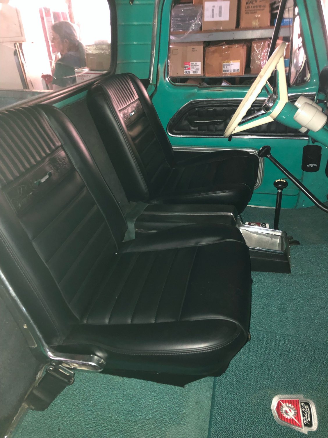

What seats are those?
Great job on headliner! Couldn't help noticing the seats. Love how thin the backs are. My buckets are too thick. What brand are they?

first thing I noticed too. I switched to a late 80's f150 bench in my 66 because it was overall "thinner" than the stock seat. The ones in the OP's pic look like they are out of a 60's car of some kind.

On the seats, my truck is a Ranger clone so they’re just the “correct” ‘65/‘66 Mustang seats; only I had them recovered and re-foamed, and I used the “incorrect-but-cool” Pony interior seat covers. Not right for a Ranger but a little fancier and I like the look of them.

Yes, Norm's seats are Buff.
There are probably some '60's and '70's vintage bucket seats stored away in Bommer's shop lofts.
I remember some of the late '70's Dodge power wagons, and Jeep gladiator pickups had some similar bucket seats.
Those were in special packages, and are SCARCE today.

Finished installing mine today, with the assistance of my wife. My son was to have driven from Santa Cruz to assist, but he’s been working 13-hour days , I couldn’t in good conscience ask him to get up on his day off, drive 175 miles then begin working in 100F + temps. Wife and I got up at first light yesterday, worked till it hit 90F. Then finished off this morning.
A few hints I learned from other members here:
1. Use a mixture of 4 parts water/ 1 part (or a bit more) ammonia to pre-wet the warmed headliner, we warmed ours with a heat gun since we didn’t want to work in the heat of the day. The ammonia temporarily makes the fibers more pliable and less prone to snapping. Thanks for this tip from member tbm3fan, Mike. Apparently, this method is done when steaming and shaping certain wooden parts. No residual scent from the ammonia.
2. Wet well the sail panels, then ever so gradually, form them around the radius of a 5 gallon bucket. Once fully conformed to the radius of the bucket, as tightly as possible secure it, with 3-4 straps, bungees, whatever you think will work, till mostly dry. We did one at a time. This really helps. ! Not sure where I stole this idea, maybe Chad? Thanks to whoever it was.
3. Buy and add some additional clips when you buy the headliner, for the front edge near the visors rear view mirror. Avoids a warped and uneven edge. Watch that YouTube video, linked previously, several times and pray you have patience and don’t snap the delicate fiberboard.
I cannot believe that Carpenter will not sell separately, the sail panels and piece that goes above the rear window - the easiest pieces to snap/damage. They’re also relatively small and would cost little to ship, compared to the very large main piece. The approx 200.00 price tag, plus another 150.00 shipping, is sure to have you sweating bullets at install time, out of fear of damaging it and having to buy another.

Really good input! I take it that your install was fully successful? I didn’t think of the ammonia, but that’s a good tip. Good tip for the sail panels too. I bent/worked mine over the sides of the hood; top rear panel edges too. That seemed to work okay but I like the bucket & bungee idea better. The extra clips are also a good idea, if there aren’t any still up there above the visors… most of mine were still up there (headliner itself was long gone), and I utilized the old clips with the new ones, for just the reason you suggested. Carpenter and the other companies should definitely sell replacement parts for these. I was extraordinarily fortunate not snapping anything, especially installing by myself. But you’re right… I was sweating bullets, and not because of the heat!
