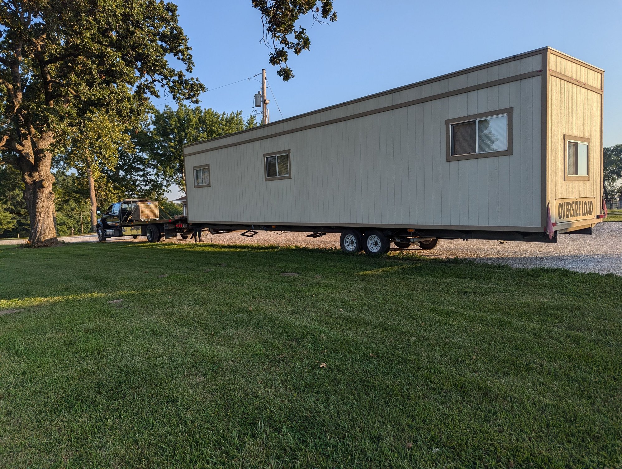

Here's my 2019 HO derated 6.7.
Imagine driving pulling this around town.... LoL
650 Rollback with 10x60 trailer.
