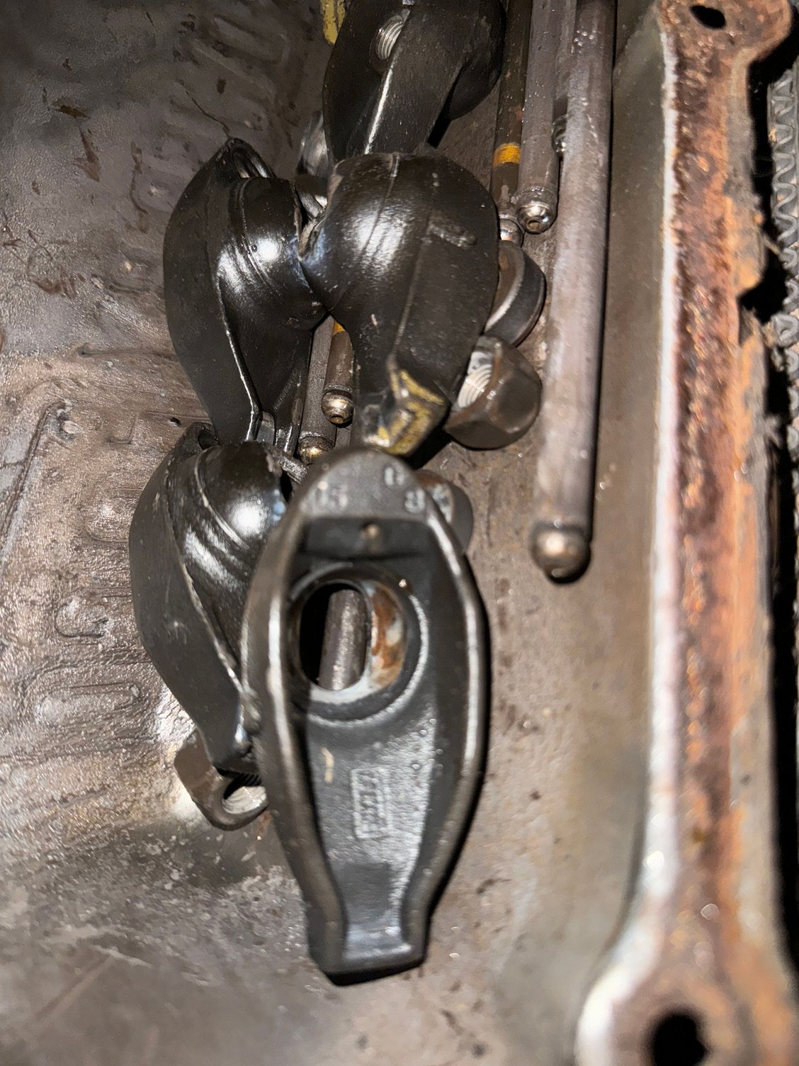

Anyone know what the stamping numbers on these rockers are for? 69 429 (C8VE-E heads)

I don't know what the "stamping' number is but that style rocker can be a little hard to find. I don't think that they are available through aftermarket sources. Just recently a customer was looking for a few of those for his 1968 460 because some of his original rockers had the little foot where it contacts the valve stem worn quite a bit. I think he found a set off of an old engine and got some good ones. What's interesting is when I looked in my 1970 Ford shop manual they say that the rocker arm ratio is 1.75 but they don't give a part number.

Those are rail-type rocker arms. The 'ears' on the valve tip end of the rocker arms keep them aligned on the valve tip and used positive-stop rocker pivot studs with a ball-type pivot, without the need for pushrod guide plates. Earlier Mechanical cam applications used rocker studs with pushrod guideplates, Later non-adjustable rockers used bolt-down rocker fulcrums that indexed into square cuts in the fulcrum boss.
The early mechanical cam as well as the hydraulic cam engines with guide plates also used hardened pushrods. The rail rocker style engines didn't have hardened pushrods otherwise the conversion would be a bolt on installation.
My one buddy has a '70 Torino GT N-code 429/4spd. Those rail-type arms in the stock positive-stop non-guideplate heads did not like his initial cam swap... That engine now has FMS CJ aluminum heads on it, roller rockers/guideplates...
They're are some engines that came with the rail type rocker arms on studs that were adjustable and not the bottle neck non adjustable type but they must not be very common. The 1968 460 heads that I recently worked on for a customer had the non adjustable type and it was a really early engine so who knows. Oddly the engine shown in the Ford shop manual shows the rail type rocker arms on the adjustable type studs.
