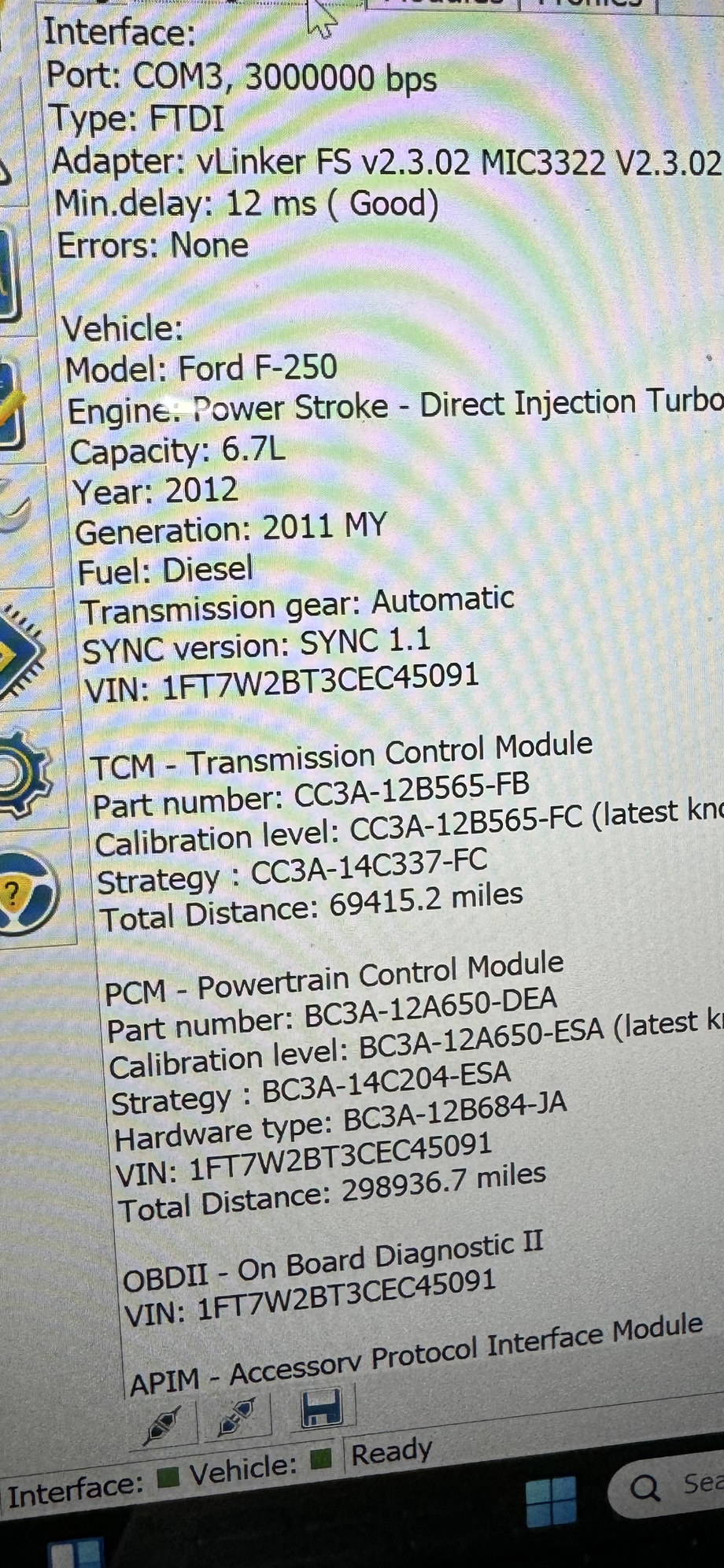

Can you post a pic of the module as detected, maybe the part number will give a clue what could be changed.

Posts: 12

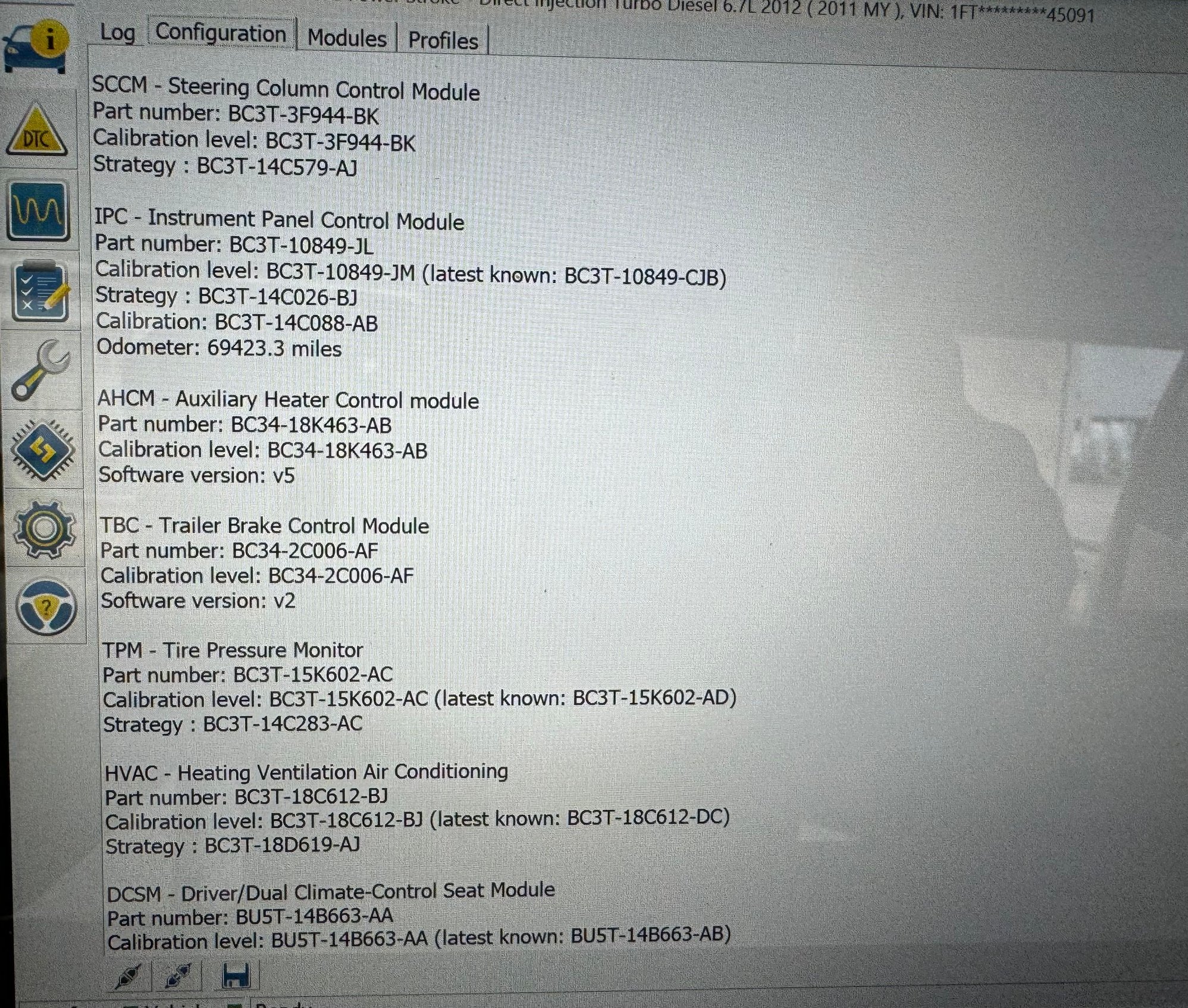

Can you post a picture of the IPC numbers, your PCM has a build date of 2011, TCM has a build date of 2012, that’s all I can tell you from that picture

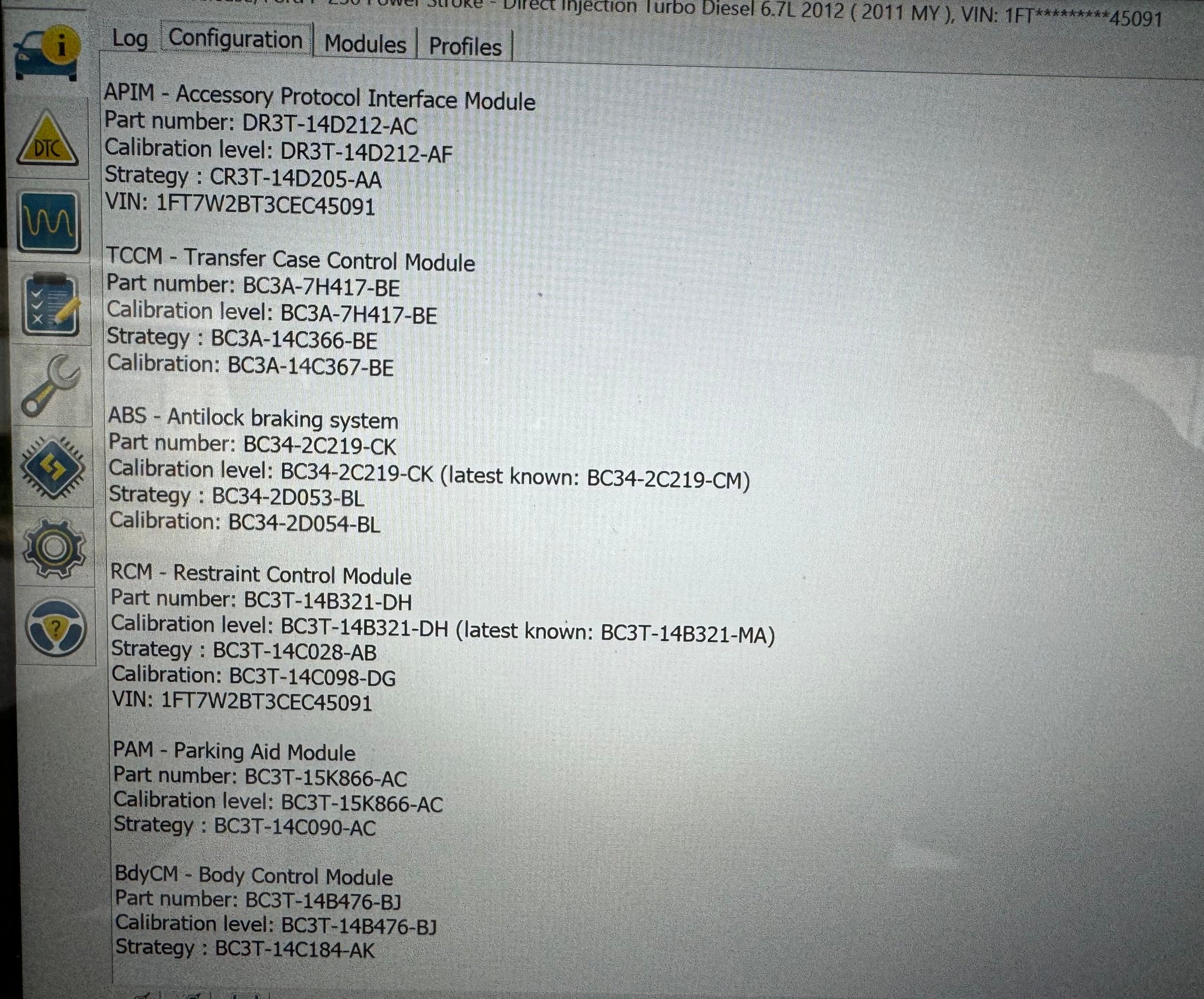

This is the information I can obtain on all of the modules installed that I can read with Forscan

Nothing part number wise is popping out as odd to me, still have a red flag about the PCM mileage, I’m not sure where the engine hours are stored on the 11+ trucks, I know the 08-10 trucks store the engine hours on the cluster, Ford may have moved that to the PCM in 2011.
