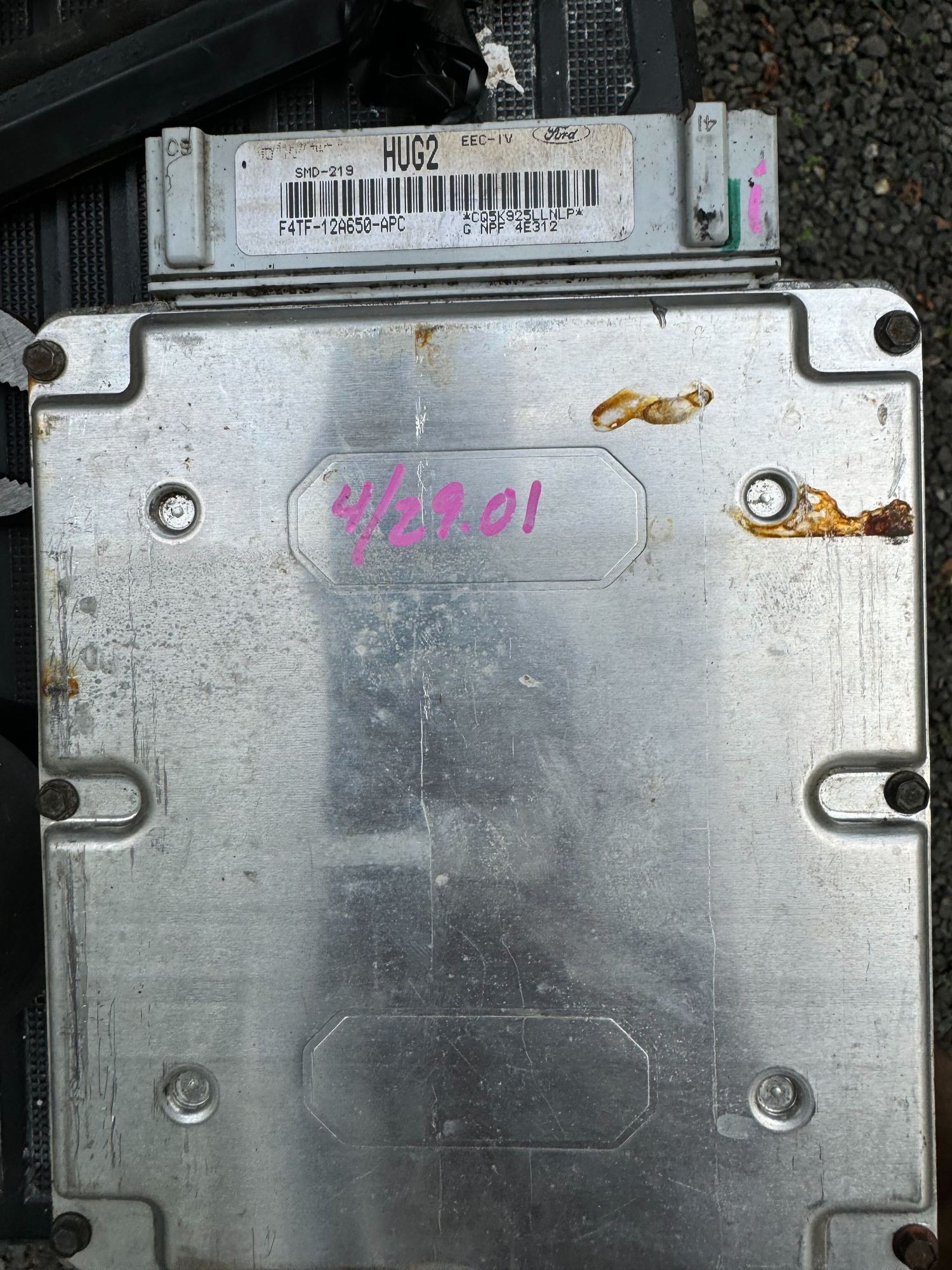

Hi all,
1994 Ford F150 4WD 5.0 302 – E40D
Long story short, after towing this truck from the woods (where it was for 1-2 years, I was told by previous owners) and slowly working through issues, my latest issue (debugging some strange / hard / sluggish shifting) showed something very strange – I'm consistently getting a 639 code - "Insufficient input from transmission speed sensor." A forum member said that it's not supposed to be *possible* to get a 639 code from an E40D, since there is only the Vehicle Speed Sensor, and no Transmission Speed Sensor.
This leads me to believe that the PCM that I replaced early on in my work (old PCM seemed to be causing issues) may not have been exactly correct – and is giving me an error that's not meant to even be possible for my setup. Maybe this is crazy, otherwise, how would the 639 be possible?
I'm hoping to do two things:
1. Confirm that the PCM I bought will work OK for my truck – I'm wondering if it was maybe from a truck with a different transmission (hence the 639, and other issues)? Otherwise what the hell?
2 (if it turns out I have the wrong PCM). Find out where I can get a proper PCM to eliminate that from the possible causes of issues.
I'm attaching an image of the configuration code from the door jamb, as well as the sticker on the replacement PCM, and hoping someone knows how to confirm that it's a viable PCM, and if not, where to get one that is compatible.
Thank you sincerely, don't know how any of this would be possible without this forum.

Yeah, that's not the correct computer for your calibration code.
I posted what you should have in the other thread, F4TF-12A650-AAA, or F4TZ-A12A650-AAA
Correct code or not that it's throwing, I wouldn't sweat it & just find the correct ECU
And yes, verify you have a Mass-air meter in the intake tube & an E4OD transmission.

Just went back & looked at my ECU stash.
If you find a AAA version, its "catch" or "batch" code on the original label will be HOG0
Like the one above is HUG2
