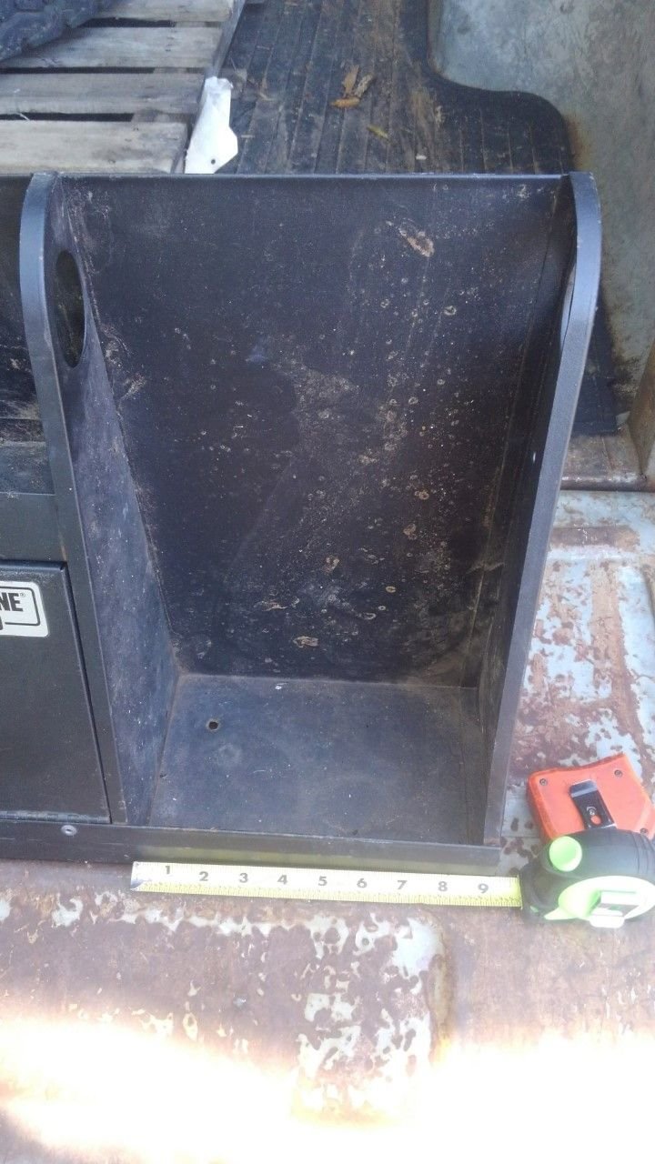

Here is a behind the seat old school storage idea made by Stowline Outfitters. If you have a local HVAC shop they should be able to bend you one up pretty easy. I have all the measurements w/pics some where on my computer.

Yup, that's the behind the seat storage I was picturing in my head.

I have/had 3 and yes I searched high and low on Craigslist and FB market place. I just sold one to a good friend. Found those pics.
This is the depth of the bottom of the tray.

What are the holes at the top of the up rights for?
I have one in my 81 F100 that has a little different lay out.
Dave ----
I wondered that same thing last night and my initial thought was for fishing pole storage?

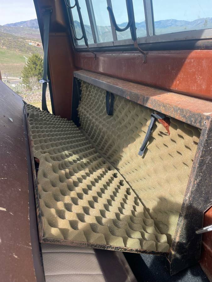

A different gun case version.
And the none gun case version V1.
V2
