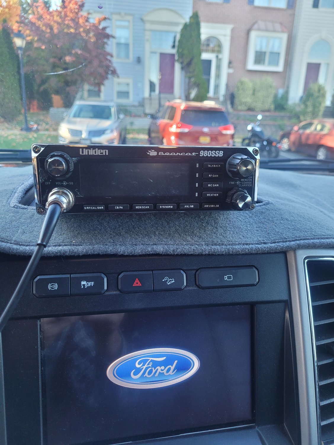

wireing generally runs along the door channels with the sill plates covering it.
If you are looking for power you can run the hot wire out to the upfitter switches and the other to a ground. Being in the center it should be fine to run it straight to the dash since no one really sits there.
Or you can set it ontop of the dash and run your working down the center stack. there are mounting hardward to mount it in the tray area.
