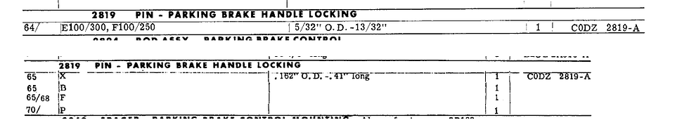

The aluminum handle says it comes with a new drive pin and an Allen head set screw.
The trucks used the same pin as the cars but some variance measuring that outside diameter. Plus, cars listed in decimal and trucks fractional. Consistency is highly overrated...
Might be able to drill it but a drill press and good machine vice would probably help if you knew anyone with one. A little accuracy might go a long way in this case.
C0DZ-2819-A
