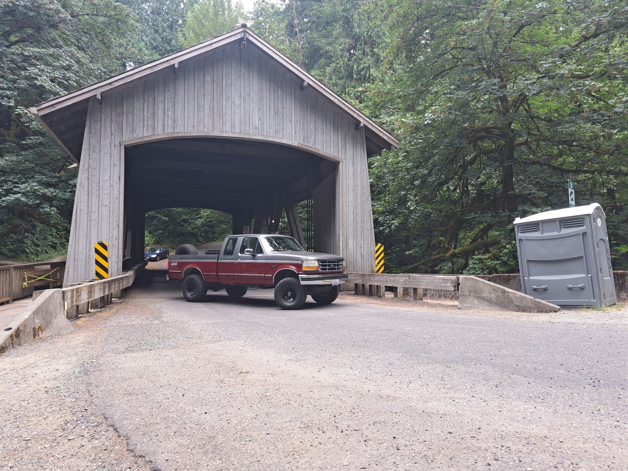

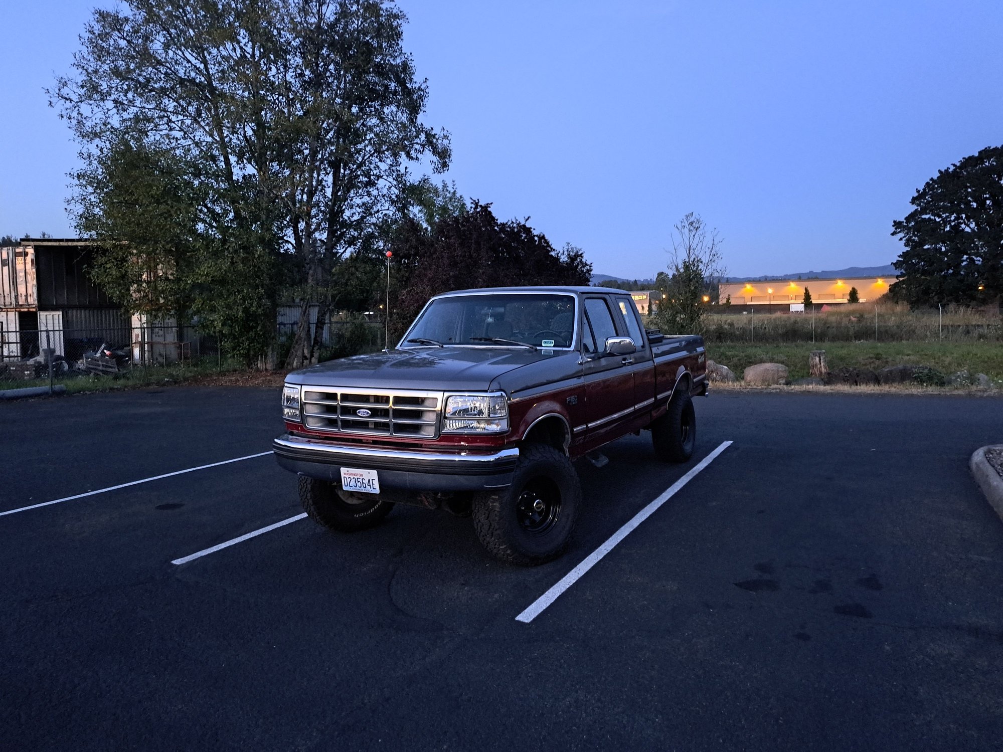

I have a 1992 351w F-150 that I bought a couple months ago. I have been watching this forum for a few years now but I finally joined to ask a question about some vibrations I have been getting in my truck. They only used to happen between 65-70 but now they have been starting around 55 and continuing to 70. Anyone have any ideas. (This is my truck btw)
