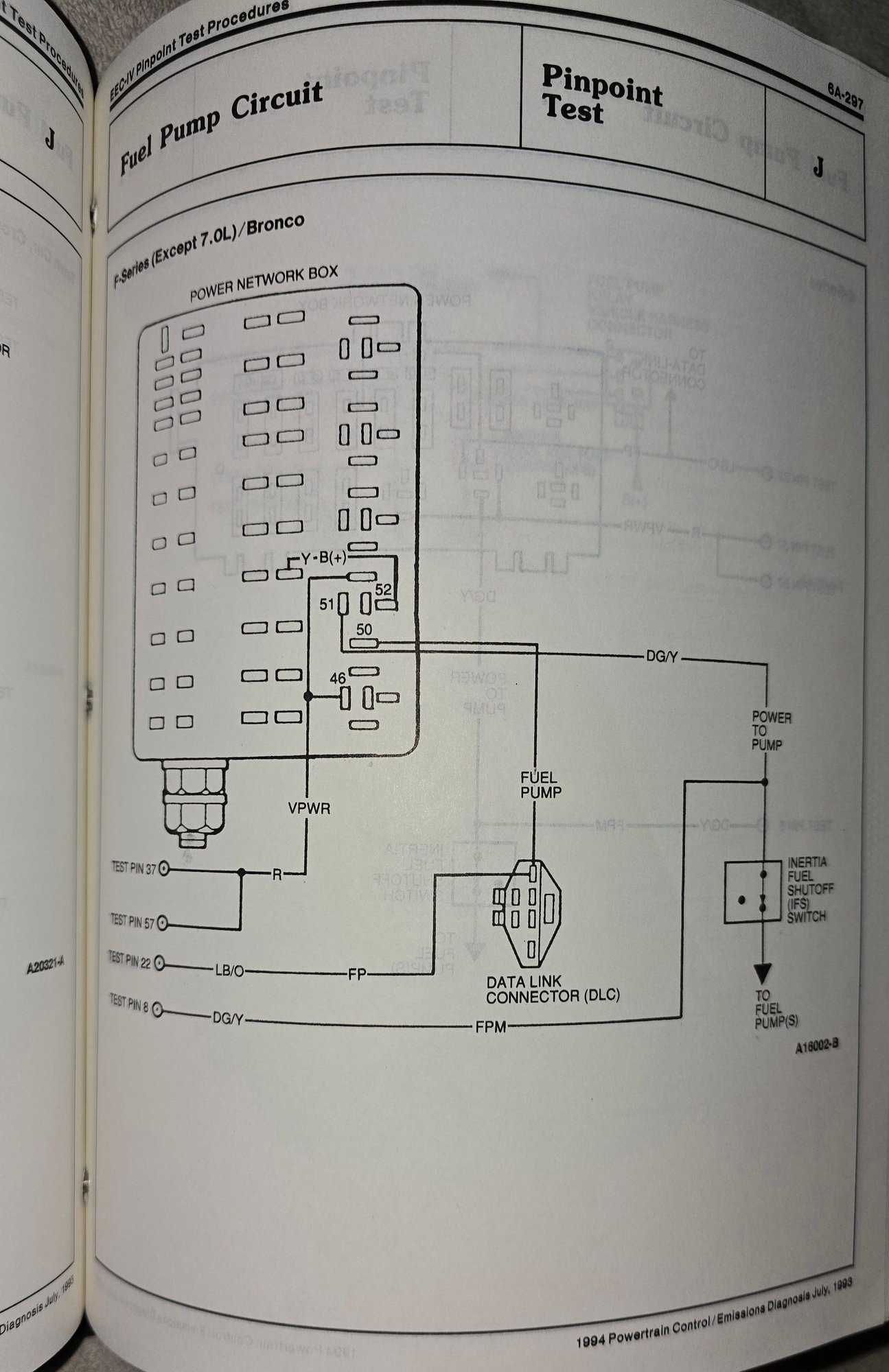

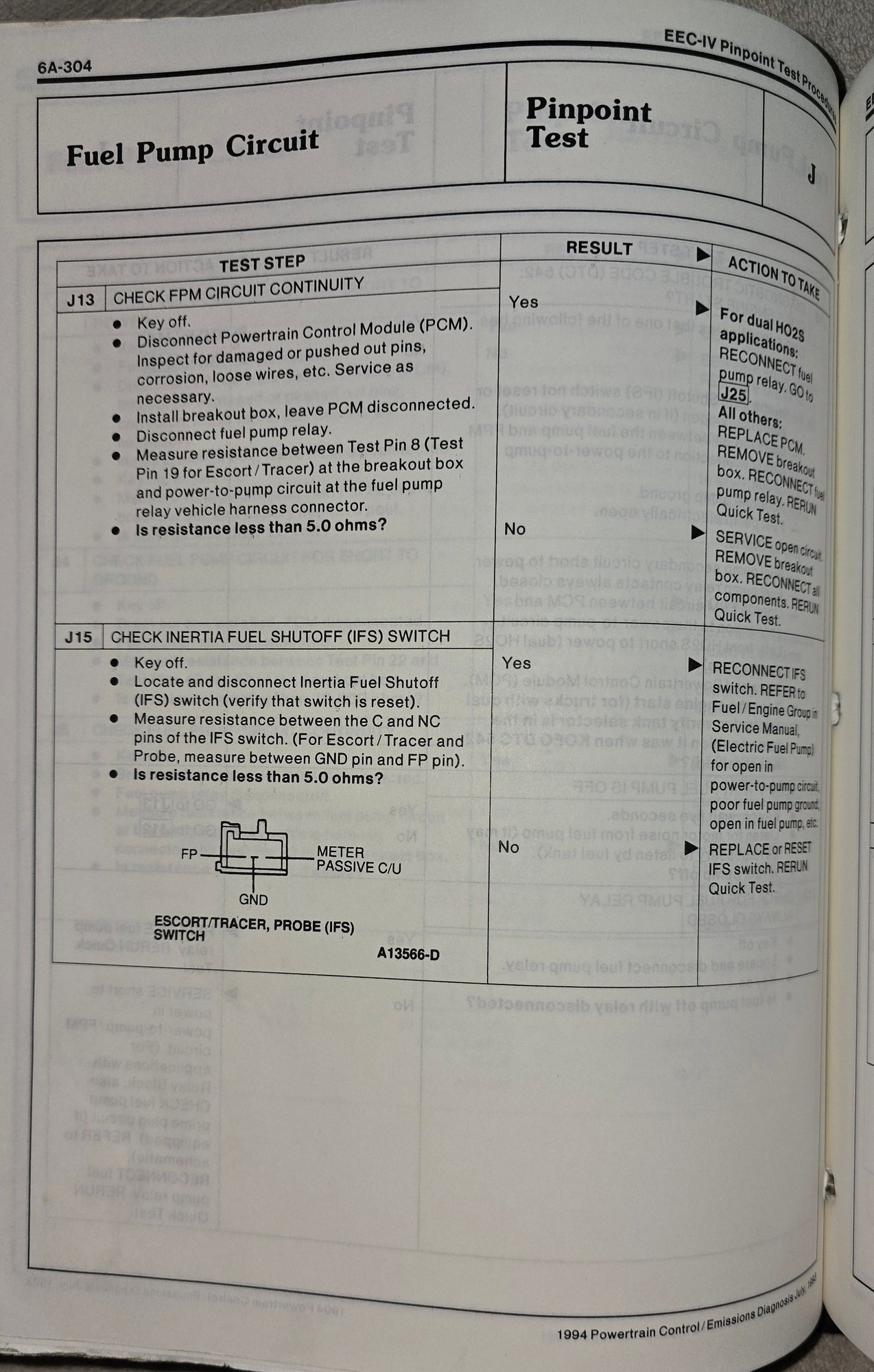

Smack that gas tank with a brick a few times and see if it will start
Sounds like you need a new fuel pump
Cycle the key on and off 75 times and see if it will start
Go ahead and do the pinpoint test steps foe code 542 in the PCED
Here is a sample, you can get them from AllData for free at your library

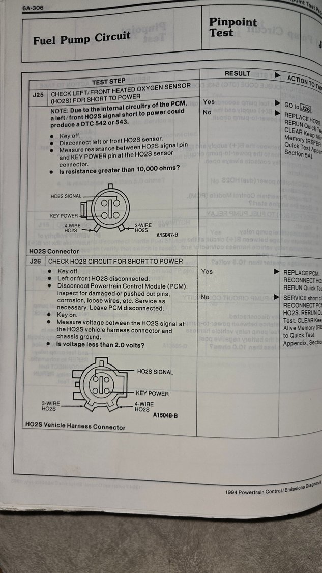

Old Sep 12, 2024 | 08:38 AM
manicmechanic007's Avatar
manicmechanic007
Joined: Jul 2020
Posts: 10,551
Likes: 2,669
From: Near Salt Lake City
I got those posted out of order and was not going to do it again
But you will notice on J25, that power runs through with the HEGO heater circuit
That is why I ALWAYS say to at least look at, (if not perform) the pinpoint tests
You can scratch your head for days without them
