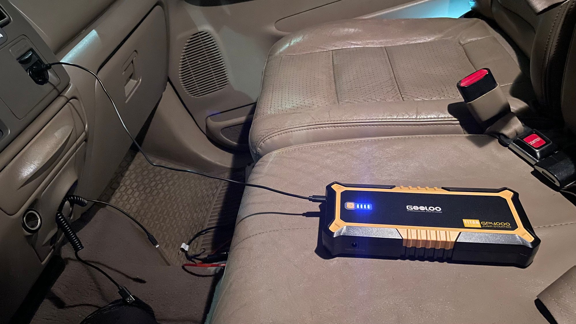

From: Lake Stevens, WA
Jump box Jump box
I've had good results with this unit, though I have not had to start the truck with totally dead batteries.
Just used this last night to get my daughter's subaru going. Throw it on the seat to recharge from the power port overnight and it's ready for the next use.
