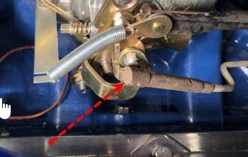

Carb linkage
I have the bar in the picture below, what I don't have or haven't yet identified in the myriad of parts in the bucket - what connects the throttle assembly to that rod? it does not look like its threaded, looks like it should be a ball in socket type thing. If it makes any difference, its a 73 f100 with a 302 that I stroked out to a 331. it'll have a holly 4 bbl on a Edelbrock 289 performer intake.

there's a ball stud on the carb linkage and it just snaps into a socket on the throttle linkage. should just pop on and off.

From: Milwaukee USA
Okay thanks so I should be looking through my parts bin for something akin to a stud with a ball on the end?

Likes: 211
https://www.ebay.com/itm/19493760624...35dff10381fb29
something like this

Holley carbs do not come with the ball stud you have to either pull it from the other carb, Holley as a factory Motorcraft I dont think can be removed or you have to buy one.

Yeah, couldn't find it in my parts bin so I just ordered one from amazon
