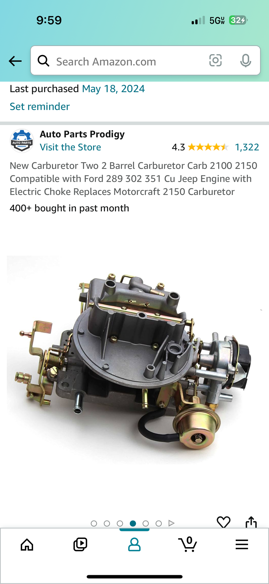

Is this the correct carb (linkage) for a 302 with TV Rod linkage?

Never have seen any aftermarket carb designed for a AOD control rod or cable. Some of them do have a feature for the kickdown rod for a regular 3 speed transmission.

ok is there a conversion kit? Cuz I already bought and installed it. Runs better. BUT won’t shift

DO NOT drive it or you will burn up the trans.
The only thing I know of is the LoKar cable for the AOD transmission to aftermarket carbs.

You still have the old carb? If so what does the linkage arm look like and can it be retro-fitted to the new carb or the new carb be modified so it looks like the old carb? The problem is the ratio of how much the transmission cable is pulled versus how far open the throttle is. If you could copy that it should work.

unfortunately when I got the truck it was essentially a roller. I will try the lokar cable as suggested above tho

Here's the instructions for it. Looks like you will need to fab up or try to buy a bracket for the carb also.
https://www.lokar.com/assets/instruc...D-Kickdown.pdf
