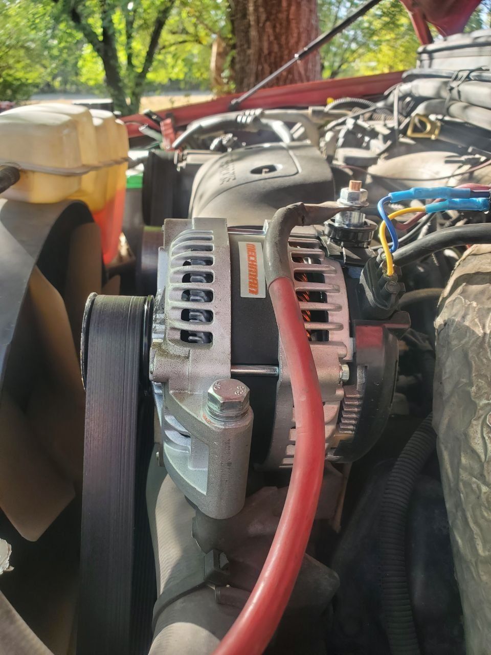

get a MechMan alternator,
it is internally regulated and will hold 14.8 volts at idle, even with both AC fans running on high.
or, with brakes on and a trailer behind you, don't matter, it has the beef to keep those batteries charged.

That’s the one I’m budgeting for. After all the research I’ve done and with the kind addition of John’s input, I don’t think there’s any reason to consider another. It fits right in with no modifications. 👍
