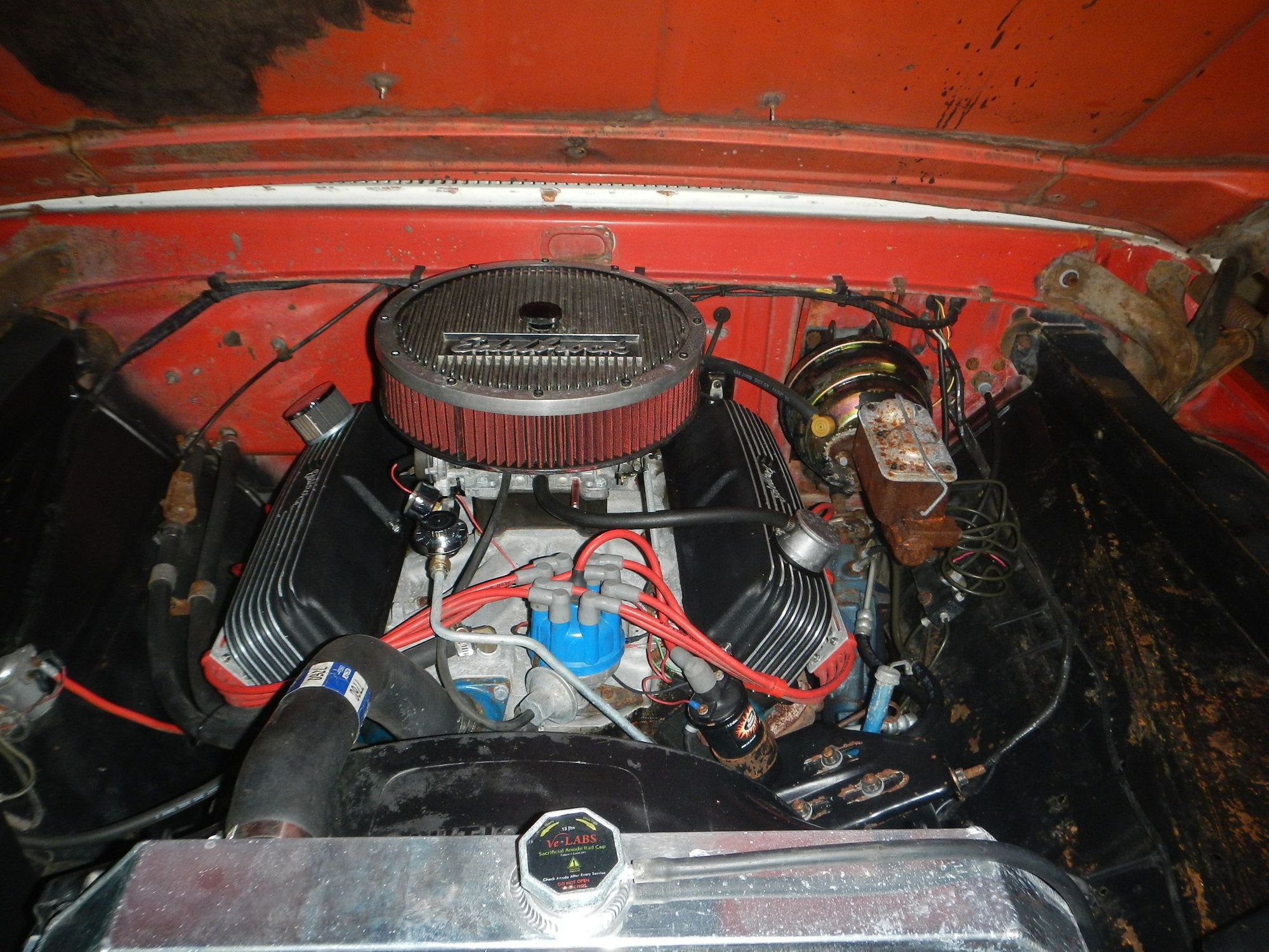

So this evening i replaced both heater hoses and refilled the radiator. I let it warm up and after the thermostat opened up filled it up again. I let it idle some time and it held temperature at 90 degrees celcius constantly. Filled the radiator up again after all the air was out. Se below for a picture of the engine bay before i replaced the 2 hoses. I circled the hose where the rupture was. The fan is actually spinning like it normally should. I'm just not used to these old cars and a fan that's just spinning with the engine. You'll learn something everyday! Then th question still is... Why would the engine throw out the cooland when pushing the engine? Could it be a wrong radiator and cap maybe? I saw on the radiator written: 1967 f350 360 4spd?
Glad you got it fixed. Sounds like it’s working OK, so you avoided any major problems so far.
From here the hose looks like it’s under stress at an angle. Meaning, where the clamp holds the hose to the fitting, it’s at an awkward angle. And also being held down by other things pressing on the top of the hose.
I can’t tell for sure, and if you have other pictures with the hose removed, maybe we can see better. But if it’s what I think, then the hose simply wore through from stress.
Why does it do this when you’re pushing the engine?
Well, because you were pushing the engine! 😁😉
But really, two general reasons I can think of.
One is simply bad timing. It was ready to go and it finally did simply by coincidence. Serendipitous coincidence…
The other is that, when you’re pushing the engine, you are literally building more heat. A natural result of more of the power available.
And you are building more pressure at the same time. Both ambient pressure inside the radiator from the hotter coolant coming out of the hotter engine, and from physical water pressure from the faster moving water pump.
All of the above work together in any system.
I’m glad yours just wasn’t that far from home when it happened.
The markings on the radiator would seem to be from a recycle yard/source where the previous owner got a replacement radiator.
They indicate exactly the type of truck it came out of originally.
