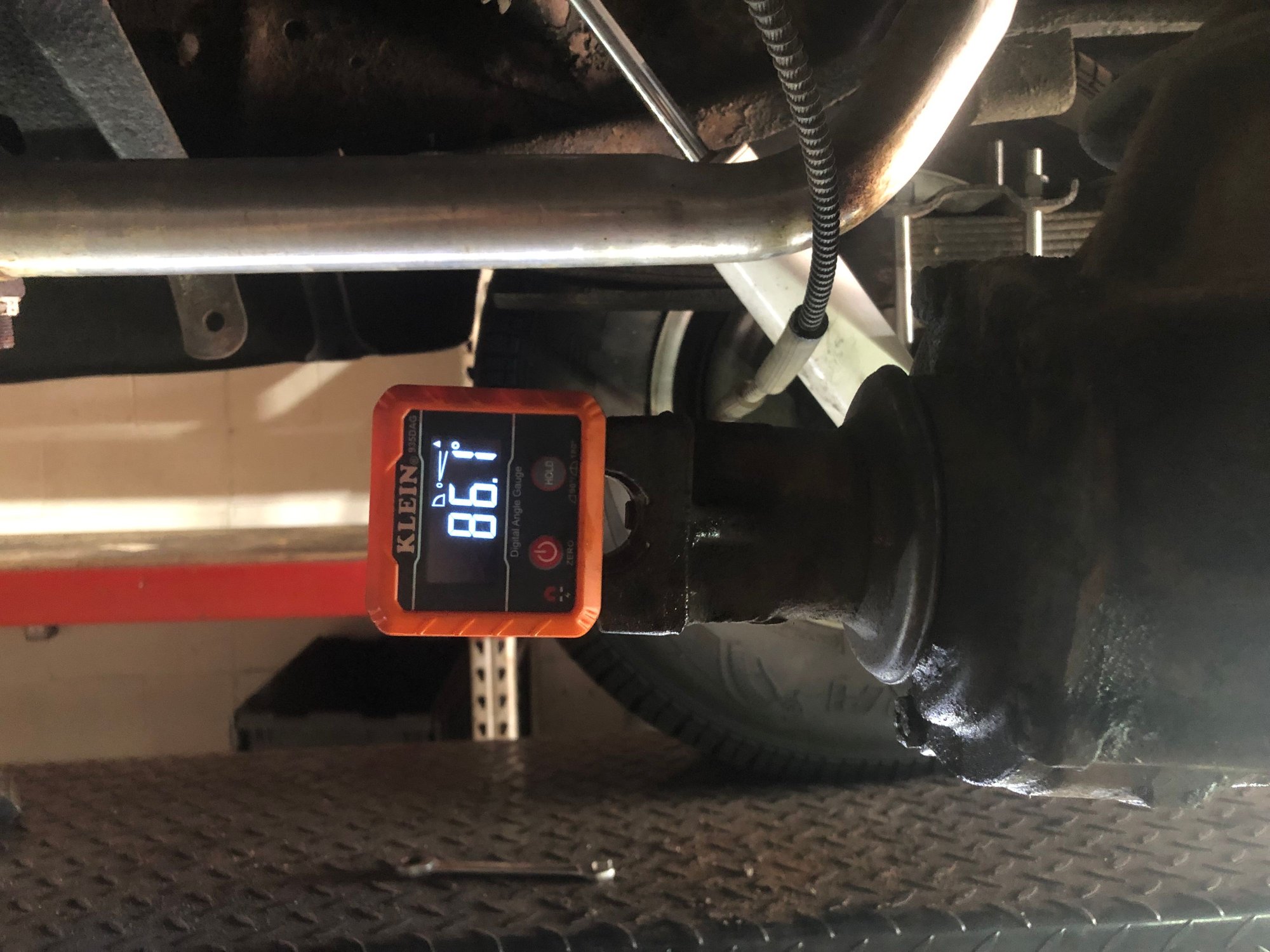

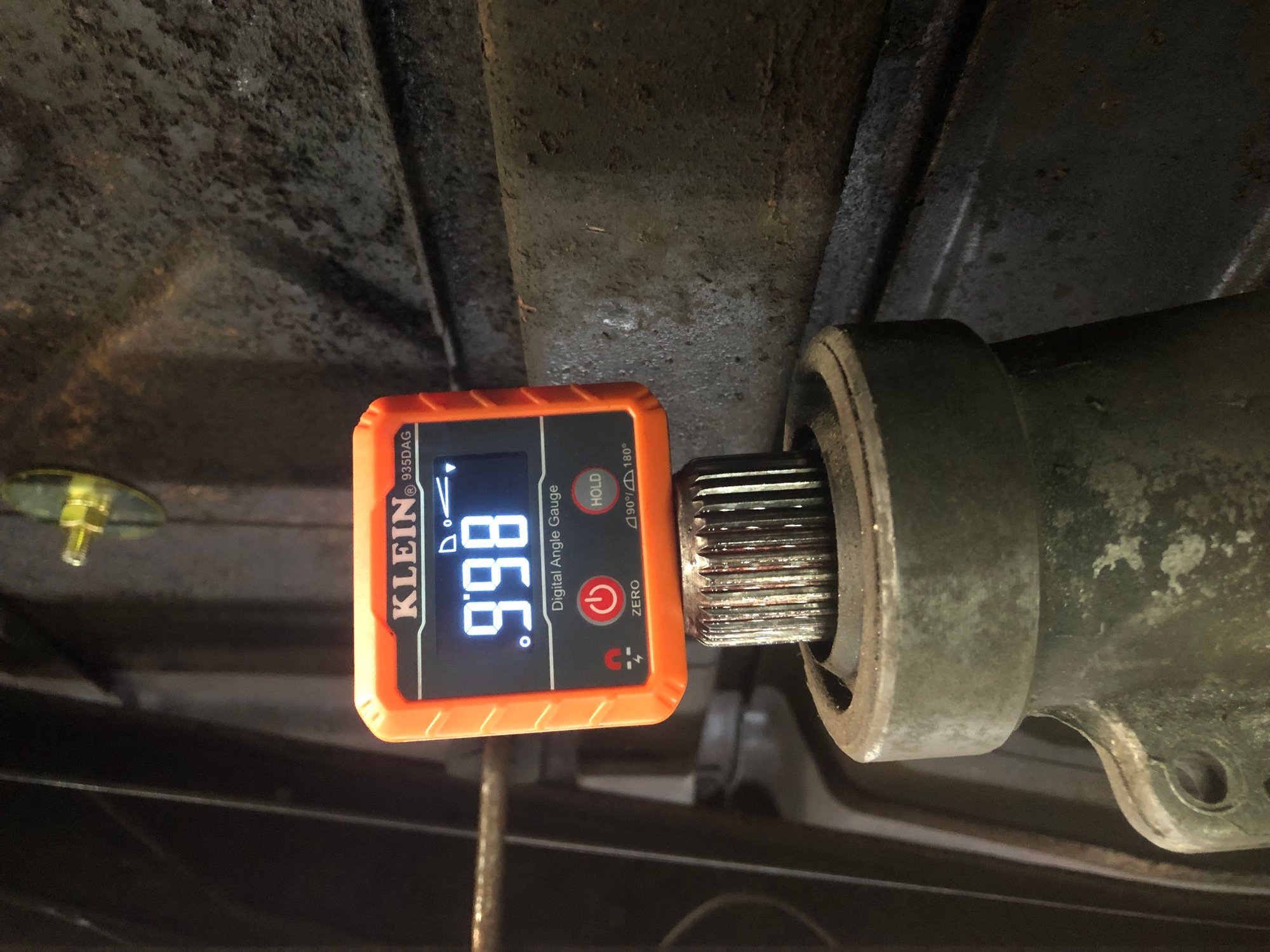

Update. I pulled thr the driveshaft and got a digital angle finder.
Got 3.4 degrees down at output shaft of trans.
Next I measured at the pinion yolk.. 12.4 degrees up. I found that hard to believe but even by eye, it looks so wrong
I installed shims and now the angle is 3.9 degrees up.
Now that the rear angle is within 1/2 a degree if the trans, the vibration is gone and it’s like a different truck. Of course I played ujoint needle bearing bingo that was fun picking those up off the floor, cleaning and reinstalling. This thing has been running so far out if whack for so long that I’m going to have the shaft balanced and unjoints replaced.
I really can’t say enough about how good it feels to figure this out. I’ve never done this before.

Are the rear springs stock with no shackle or other modifications? I’ve never seen a pinion angle like that.
the springs appear stock but I feel the rear is not original to this truck. I believe whatever this rear came out of required a much different spring perch placement than my truck. The wedges I put in corrected it.

So, when I removed rhe driveshaft, I noticed that the output shaft of the trans had a lot of up/down, side to side play- I’m talking about 1/8” in every direction. With the driveshaft yolk inserted, there is no play. Is that normal? Doesn’t seem right to me
Yes, the only support the output shaft has is two small bushings in the rear of the case and the extension housing bushing.
