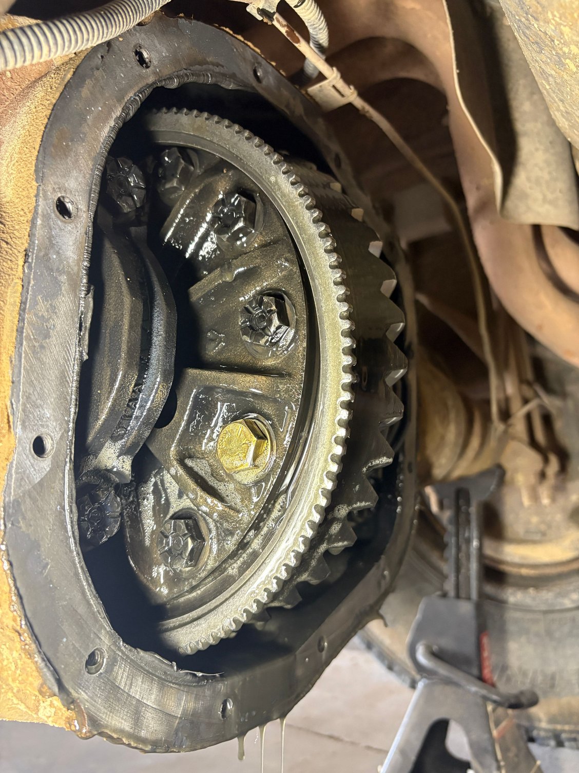

That would make sense. I was recommended to use red lock tite on the bolts.
you can see some scarring on the carrier. I would bet you are right and that’s why it was welded as well.

The ring arrived today. I got everything put back in. I’ll put oil in it tomorrow and test to see if the problem is fixed.
it definitely looked like the bolts backed out of the carrier. I found pieces of them in the oil.

I pulled the diff cover off and saw that at some point a few bolts came out of the carrier and the tone ring was welded to the carrier and the ring itself was damaged. I replaced the ring and made
sure all the bolts were in the carrier and I put lock tight on them.

Turns out the tone ring came off the carrier.
I guess I know why the previous one was welded on.
Unless anyone has any other ideas on how to keep this from happening again I guess I’ll have to pull the carrier and weld the ring on so it won’t walk off.

Not quite the smoking gun I was hoping for.
I was able to get the ring on and I tack welded it in.
Speedo works fine to about 50 and then is all over the place. Not sure what the issue is now.
