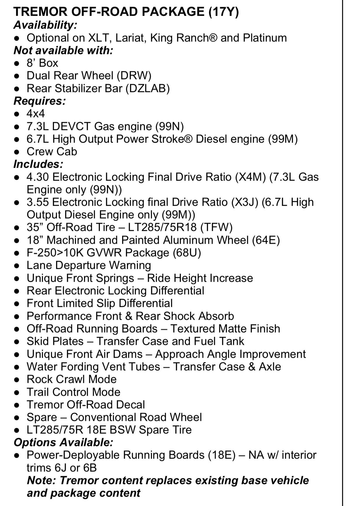

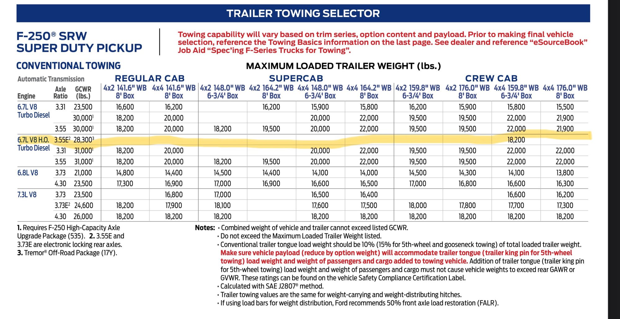

Hello, looking at new trucks and have a question. What does the Tremor Package get you? Looks like it's mostly off road stuff . I'll be using the truck for towing. Does the Tremor Package degrade the towing ability?
Thanks in advance and sorry for all the dumb questions.

This is from the 2024 order quide.

I like the Tremor pack because it doesn't neuter the truck like Ram's Power Wagon pack. With the Tremor, you can still haul and tow the same weights as most 3/4 ton trucks and use it as a work truck if you want.
