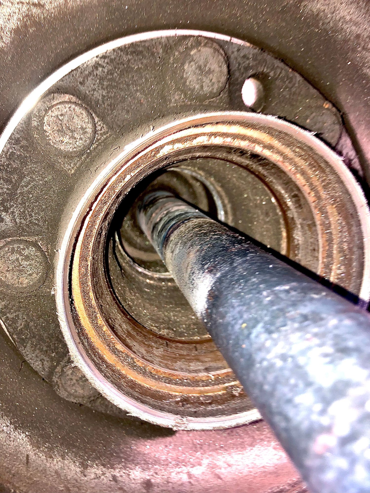

That's what I'm thinking. Outer bearing failure. Axle still seemed attached to hub. I could move the entire tire in and out.
I'm gonna inspect a bit more today.

Mechanics paperwork said Semi-floating? I don't know for sure. I do know it's a 10.25 based on the tag.
Maybe he didn't pack them well enough?
I haven't been carrying any heavy loads in the back...but it was converted to a flatbed so maybe that's enough to put extra weight on the bearings/axle. I assume they were never replaced before though and Ive had this truck for 2yrs...it's only been 7 months since new install.
Pretty sure the axle nut is still on there. The whole tire/wheel came off with the rod.
It's definitely a full floating axle, no doubt about it. Ford did make f250s with semi-floating axles, but they're rare and undesirable. The Ford 10.25" diff uses sealed hub assemblies, so it relies on the grease packed in the bearings during installation to lubricate the bearings for years/decades. It's often neglected until they begin making noises or vibrations.

There was a noise, but it sounded like it was coming from the front end. Ball joints need replacement and was gonna dig into all the old bushings and start replacing. Just did the tie rod ends and sway bar so thought maybe that was the noise I was hearing. Just a loud clunking though...only really when turning.
Well luckily a bearing failure should be covered under the mechanics warranty. Had to do an emergency brake job (all four) and he replaced the bearings too. Talk about expensive!
Hate to say it, but he may have messed up the wheel bearing adjustment or something
The wheel bearing failure is the main problem IMO, and the axle (if broken) is a secondary issue
You pretty well need another rear end at this point, your housing with the galled spindle is toast
A 10.25 Sterling, right?
Should be easy to find a good used one
Good luck
Good luck
I disagree. The wheel bearing failure released the hub and axle shaft out of the axle housing. The axle shaft is not broken. The splines are probably in good shape. Replacing the bad outer bearing may be the worst part, because they tend to weld themselves to the spindle if the bearing spun. As long as the spindle is in good shape and the new bearing can be installed, I would reuse everything else.

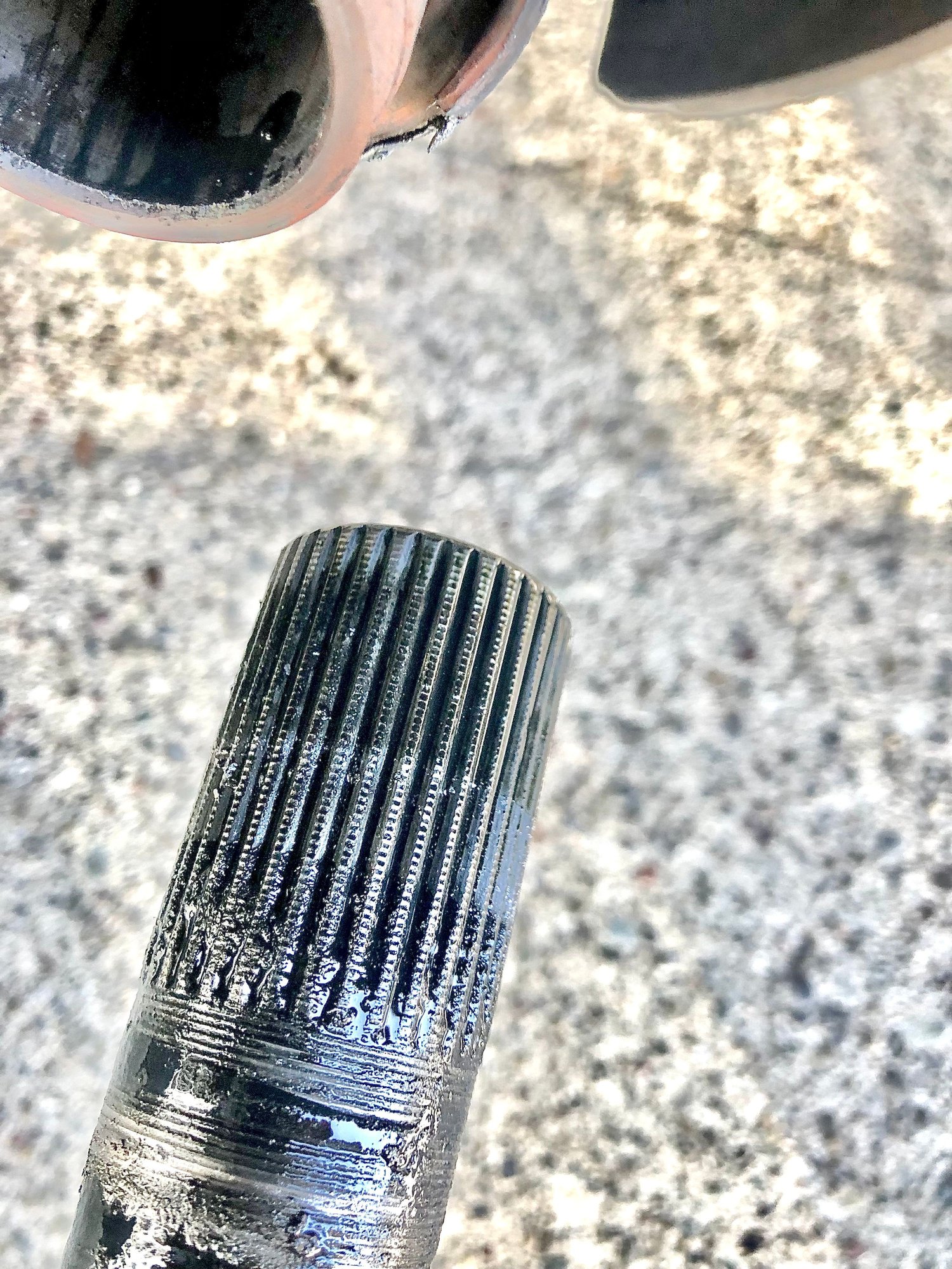

That's my thinking. I had to turn the tire/wheel for it to seat the splines, though I haven't pulled it out yet, I'd bet that the shaft is ok enough to reinstall. Don't know for sure the extent of the damage until I get in there. I'll update with some better pictures today.

There is no way IMO, the hub came off, and the spindle is okay
That outer bearing will be galled on there like woo wee
I agree, the drive axle itself might not be broken, but I would replace it anyway
What does the brake drum and hub look like?

I'm right in the middle between Manic and Proto-
I'd be inspecting everything pretty darned carefully, and measuring as I went.
The danger with the drive axle is that if it's been scarred badly enough, over time it will start to develop
a crack from the damaged on the surface, and will let go when it's heavily loaded.
The 'not so danger' is that it's a full floater, and that means you just lose drive.
Friends with Land Rovers routinely get home on the front axle, as they've snapped a rear one off- roading...
If the spindle's not chowed up, the housing's reusable. If the hub's undamaged, same.
I'd be a little surprised if this was the case, but hey, there's that gift horse and mouth saying.
As to the drive axle, if it's a bit questionable, my approach would be to run it, but pick up a spare the next time
one showed up in the cheap pull- your- part, and then not worry too much about it.
Thinking about it, I wonder if your mechanic thought the bearings were lubed by the diff oil, and didn't grease them.
Or just forgot...

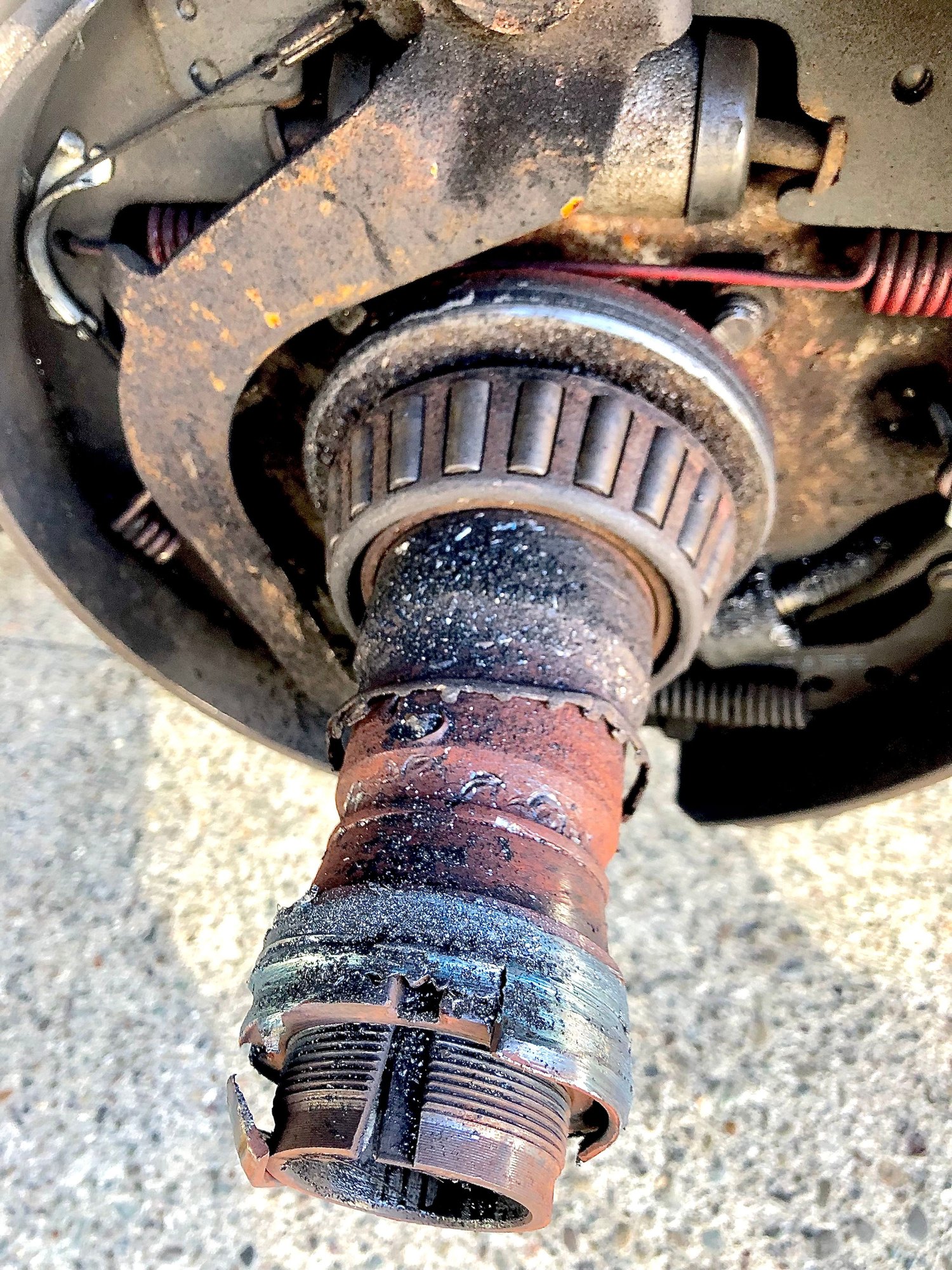

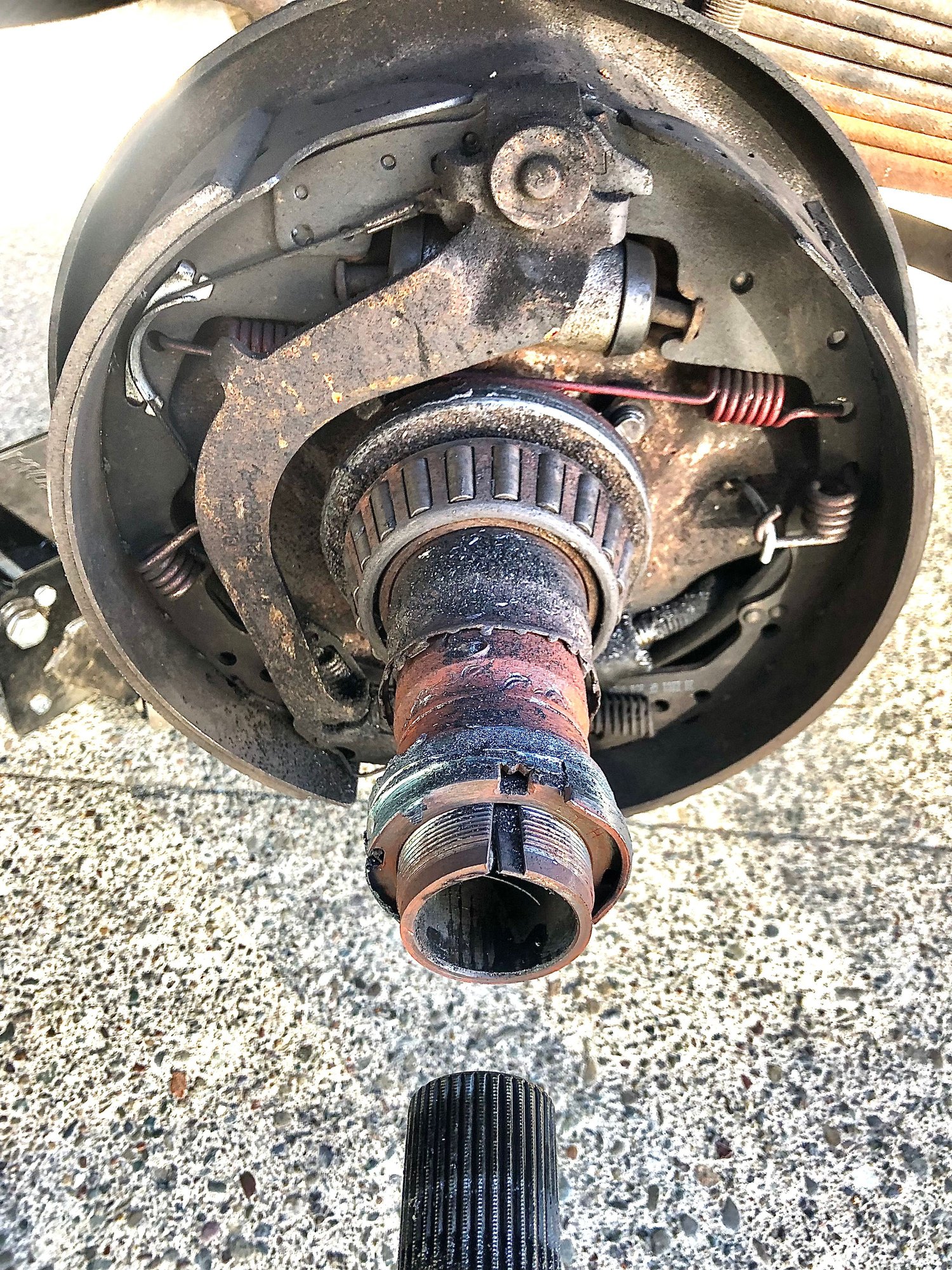

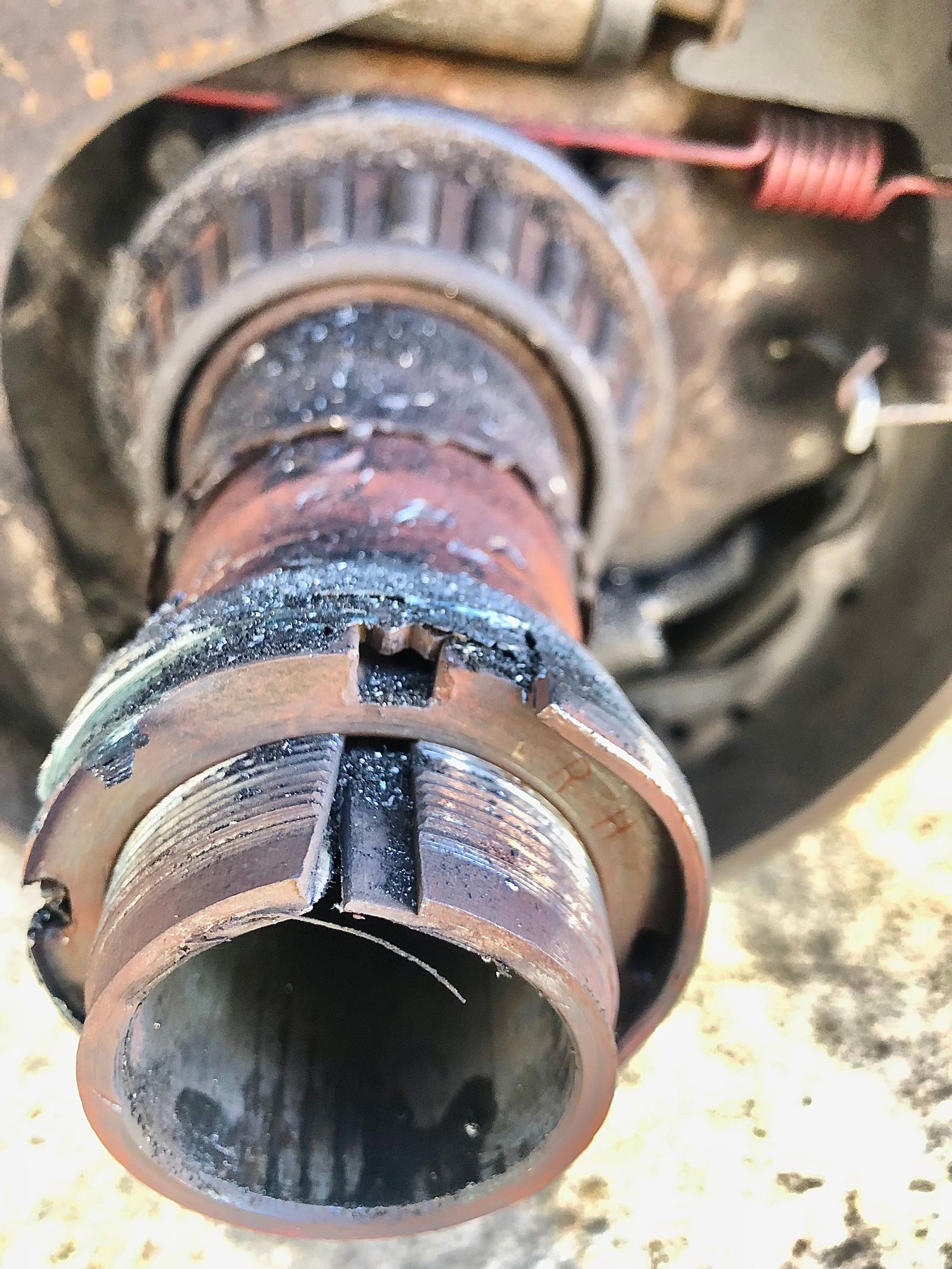

Definitely outer bearing failure. If it was just the bearing that failed or something else that caused it, I don't know. Looks as though the threads on the housing are bent. The splines on the axle rod look fine to me though.

Spindle looks ok. Didn't inspect with a fine tooth comb or microscope (as I didn't have the time) but the rod and splines didn't look noticeably damaged. Also, from the rear, the hub looked ok. All bolts still in place. Would have to take the tire off to know for sure...which again...didn't have time.
Ah, so you're saying the full floating bearings need to be packed? Feel like someone whose said they don't need grease and they DO get lubed by diff. Either way there's no evidence that these were packed with grease. Dry as a bone....

Yes. Those hubs are sealed. They don't get lube from the differential oil.

Alright, good to know. I'll have to ask if he greased them, though it sure doesn't look like it. Unless it all burned off or something. I've packed bearings on my old 66' f100 myself and I know it's a messy job and would think for sure there'd be evidence of grease still in there.
Thanks for the advice.
*Edit*
Mechanic said he only used gear oil as that's what the book said and the old ones had only gear oil. According to someone else on another thread, that's true. So I'm getting conflicting info.

He might have referenced the wrong axle that is lubed with gear oil. I’m sure you will, but I’d be taking their side apart as well and replacing those bearings too.
Thanks for posting up the results. Interesting to see. Even the spindle split.

Semi floating axles are lubed with gear oil, since the bearings are located inside the axle tube.
Full floating axles need grease, since the bearings are outside of the axle tube, in their own sealed environment.
