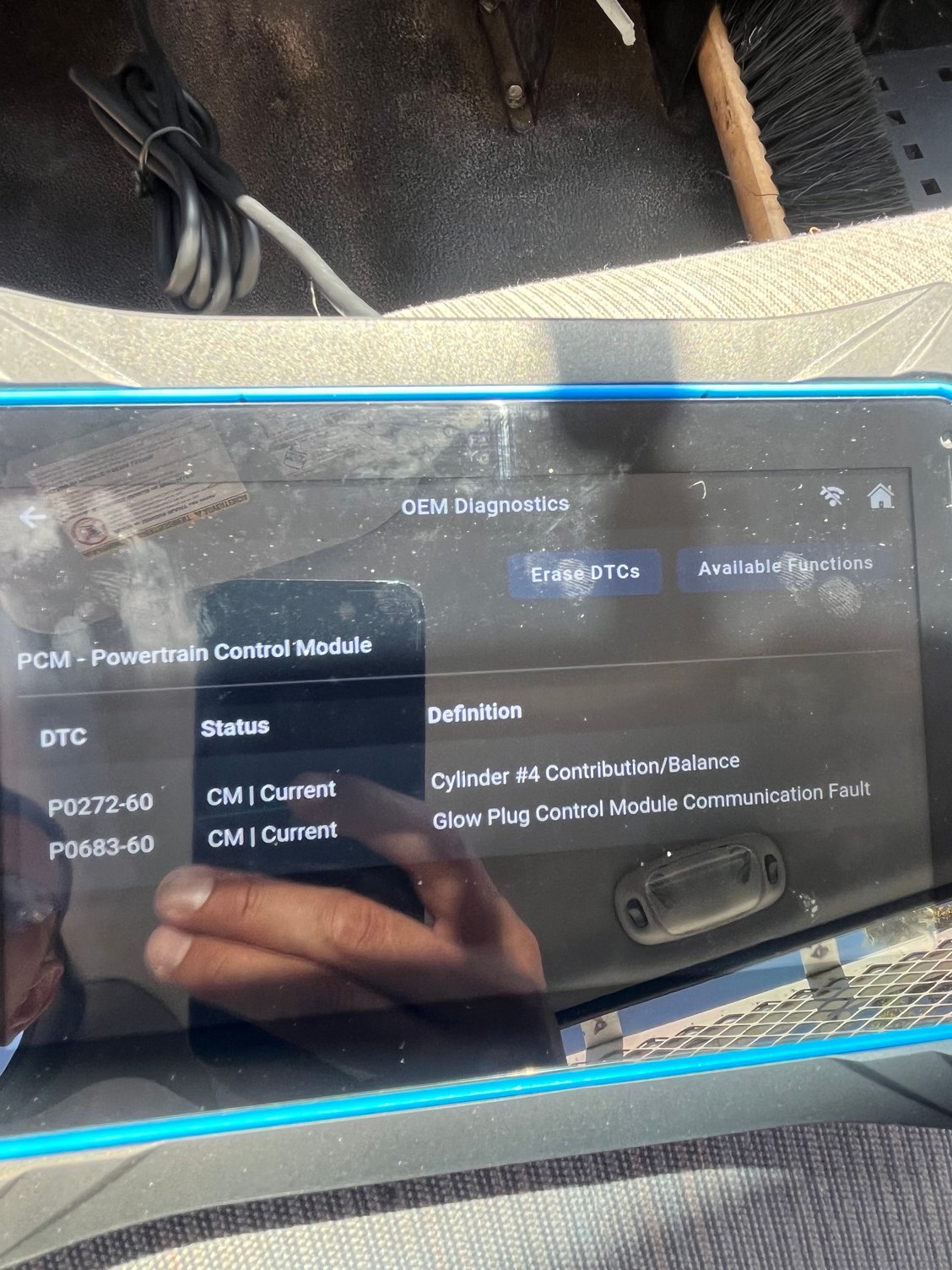

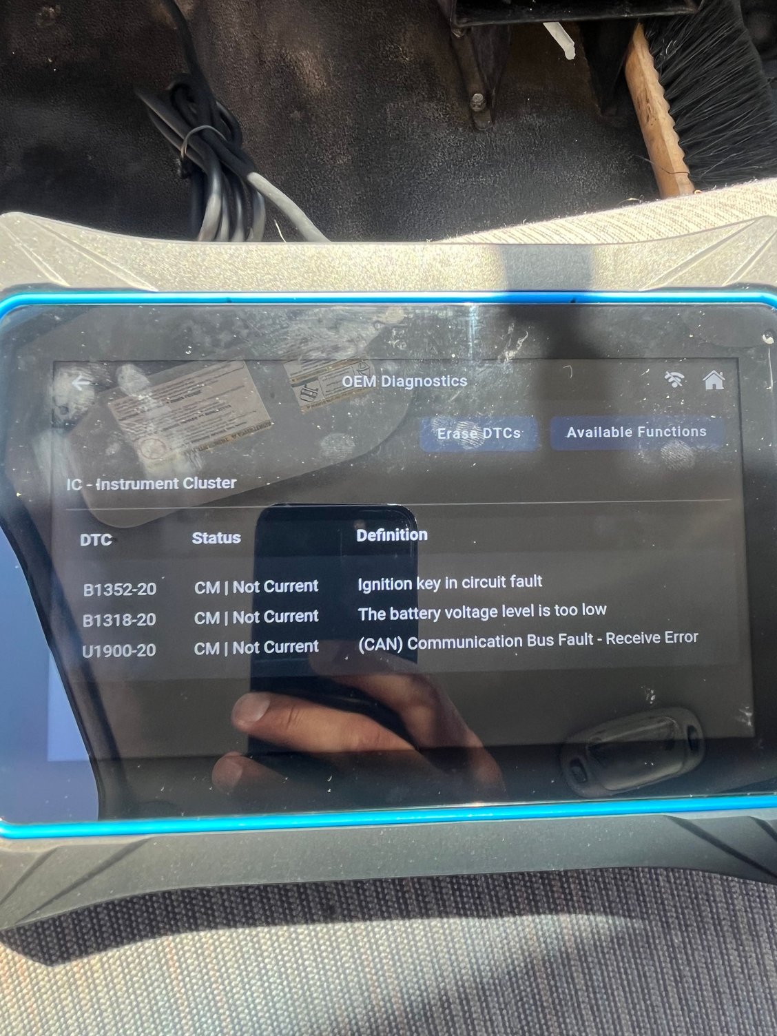

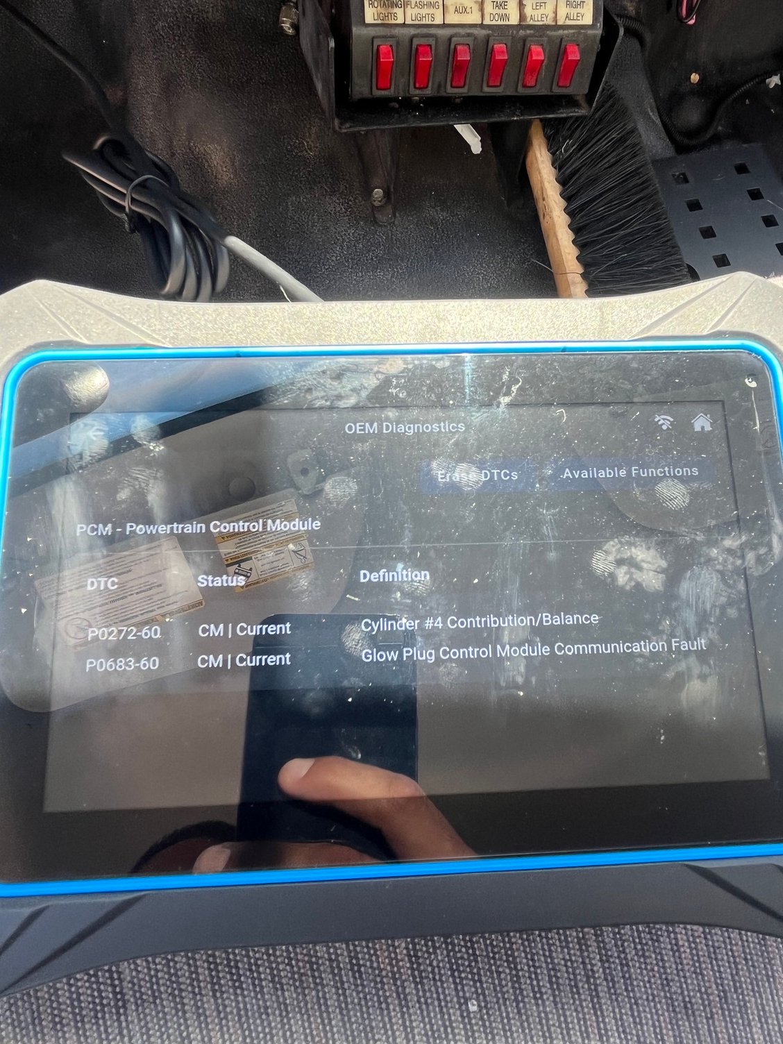

I was able to borrow a scanner from my brother. I posted some pictures on the faults it had in the system. Sorry about the glare. I have never used one of these, but see if this is the right info I need for you all.

Now you need live data
check batteries and charging system health
and FICM values
also complete a injector bubble test and supply aeration test at upper fuel bowel

Yes one of the terminals was corroded a lot I don’t know if that has anything to do with it, but I am cleaning it all up inspecting both sides and I’m going to have to get a different scanner

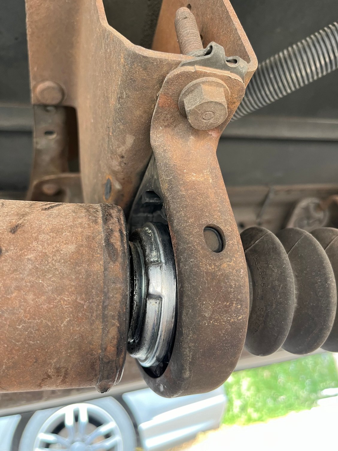

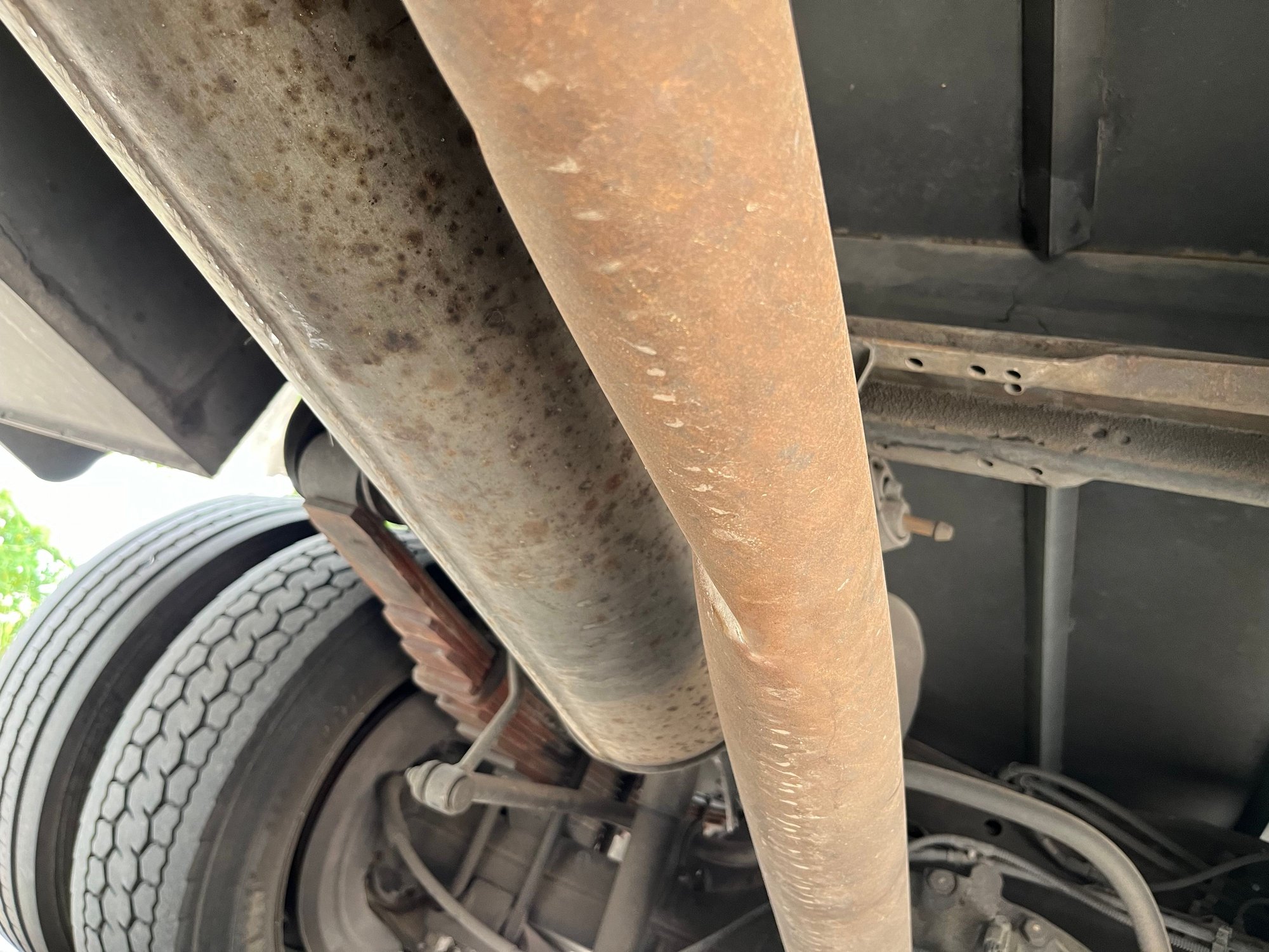

Well guys I found out what was wrong with the transmission issue that I thought it had - it had a bent driveshaft and a torn center mount not really sure how that rear driveshaft got bent like that I will attach a picture of it. I finished it up today. I am very happy it wasn’t the transmission. I have been busy with work and really no time to address the issues. Put the batteries on a trickle charger cleaned all terminals. The only two codes. I’m getting now is. The cylinder
and the glow plug issue. I originally ordered a scanner. It was not correct. Then I found out it was the driveshaft so I had to order a driveshaft. I’m going to have to hold off on getting the scanner for now. That driveshaft was super expensive. I am getting a lot of black and white smoke at idle and on the road. I went ahead checked the air filter replaced the fuel filters. Tried to delete that sound for code, but it came right back on. I don’t have no check engine light on.
