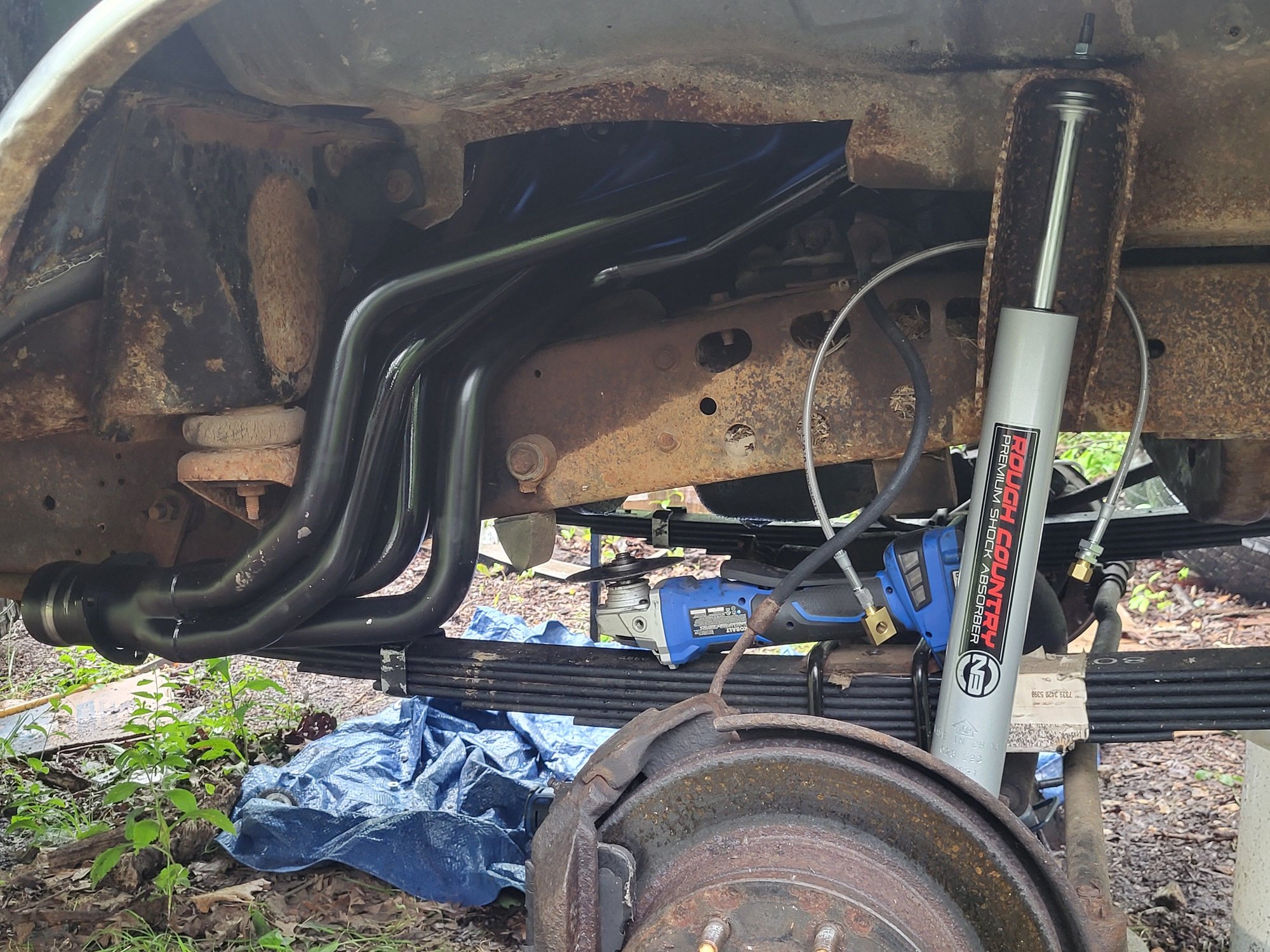

I don't know about shorties, but it generally chassis or fenderwell headers. Chassis exit headers are a complete pain in the butt to install & usually hang to low to clear the trans crossmember. Fenderwell headers ate super simple to install, but will like require trimming the rear of the inner fender. Takes a couple of minutes with tin snips or a death wheel. I have both styles & will never do chassis exit again.
79 Broncochassis exit.
79 f350 fenderwell exit.

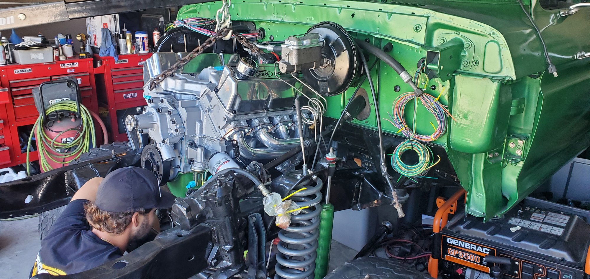

These are the best headers for 351m and 400. Not cheap but fit perfectly
https://sandersonheaders.com/351m/

Old Aug 24, 2024 | 07:07 AM
buck27's Avatar
buck27
Joined: May 2024
Posts: 171
Likes: 29
From: Alabama
Originally Posted by 1979 F150 351M
thanks for the info! I've been looking all over haha. You're truck looks great man!
