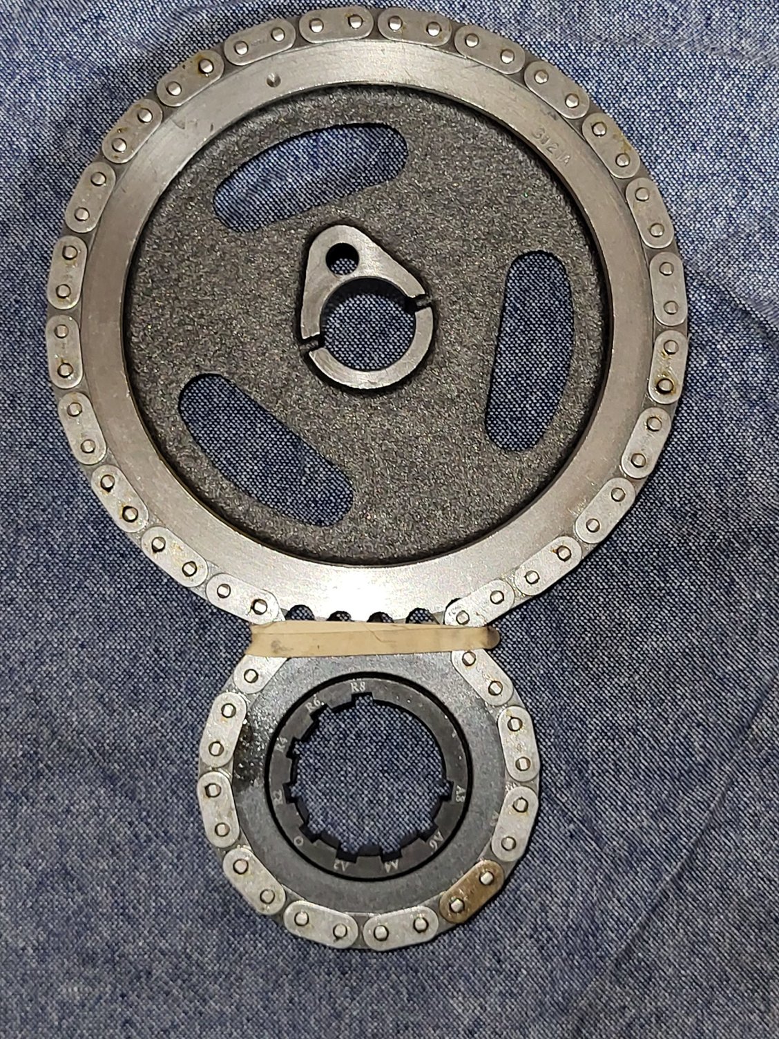

The odometer shows 75k & change. I wouldn't be surprised if it's rolled over at least once, if not more. I do have a new double roller timing set to put in it, just haven't gotten to it yet. Most of my attention with this one has been on the brakes and front suspension.
