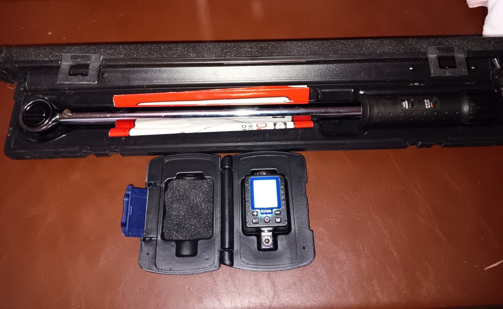

In 1981 I bought a 'Sears Finest' 'Digitork' 1/2" drive 18", 0 to 150 ft lbs torque wrench. I only used it on vehicle lug nuts a few times over the years and not at all in the last 30 years. I recently had some brake work by an old retired mechanic (but nowhere near as old as me ) and he tightened the wheel lugs with an impact driver. I questioned the torque and he said he knew when it was at 90 lbs and every so often he checked back on it. Okay, but I still didn't trust it. So I took my torque wrench out, set it on 100 and the nut didn't budge before the wrench clicked. I got out my breaker bar, put a jack handle section on it and broke it loose but it had to be at least 125. I proceeded to loosen them all and reset at 85, one at a time. My car's spec is 79 to 94 and it has aluminum wheels.
Okay, but is my old torque wrench accurate? I went to Harbor Freight and bought the 1/2" drive Torque Adapter. Brought it home, put it in the vise, set my wrench to 75 (mid point and close to my lug torque), and when the wrench 'broke' the adapter was sitting right on 75 - I couldn't believe it! So I tried it at 50 and the wrench 'broke' at 49.5. As far as I'm concerned, this 'Digitork' wrench is still on the money and plenty good enough for wheel lugs.

So, I'll be letting that mechanic know the needs to check on his lug nut torque more often because he is getting dangerous amounts of torque for aluminum wheels.
