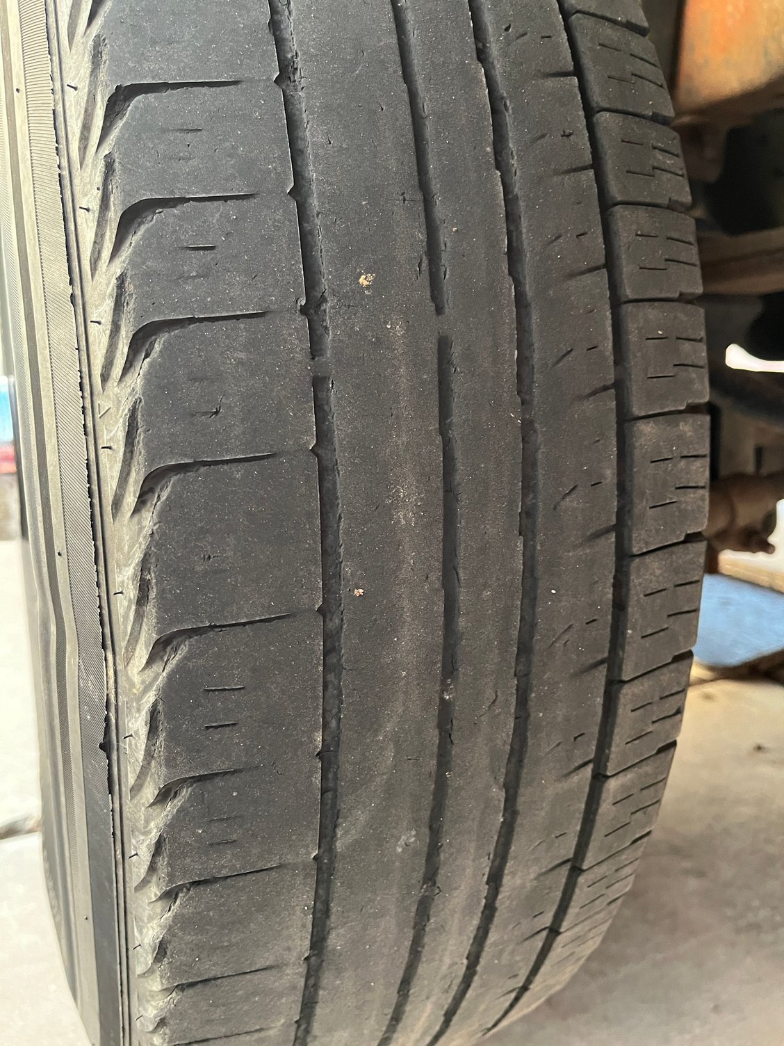

Hey geezas,
So I leveled my 1990 F250 XLT Lariat 4x4. Looks great.
However, after several thousand miles the outside tread on the front has worn severely. Inside is better.
What did I miss?
Yes I know I have a few leaks........lol

You didn't mention getting an alignment after doing the level. Start there.

Yeah, I didn't get an alignment. Truck drove straight as an arrow.

Measure the toe and see how bad it's toed- in. I'd bet it's pretty significant...
2 tape measures, 2 lengths of 2x4 and 4 soup cans to hold the 2x4 up a bit, and off you go.

X2...too much toe in or the camber is way out. Or a combination of both.

Post a pic of the front wheels from the front.
What are those spacers on the u bolts?…

Your toe is too far positive (in too much)
Either get it aligned or just crank the toe out about a half turn on one sleeve or 1/4 turn on each sleeve
If you just want to crank the toe out some, then note, the RF outer has clockwise threads and the LH outer has counterclockwise threads

I was looking at the spacers on the u bolts them selves - wondering what they are made of...... no comment on the lift blocks.... doesn't look like a set up I would run.
It could be toe in, but looks like other TTB's, (including mine in the past when set up for plow on, vs plow off) when the camber is off, typical outer wear on the tires. Very typical of lifting the front.
Over all views of the front tires will tell pretty quick.

With the imperfect steering geometry of a ttb, if camber and toe are correct at a given ride height, and the truck is then raised (leveled), they will both be out of spec and tire wear will be fast. I know my truck toes in as it rises, toes out at full compression.
