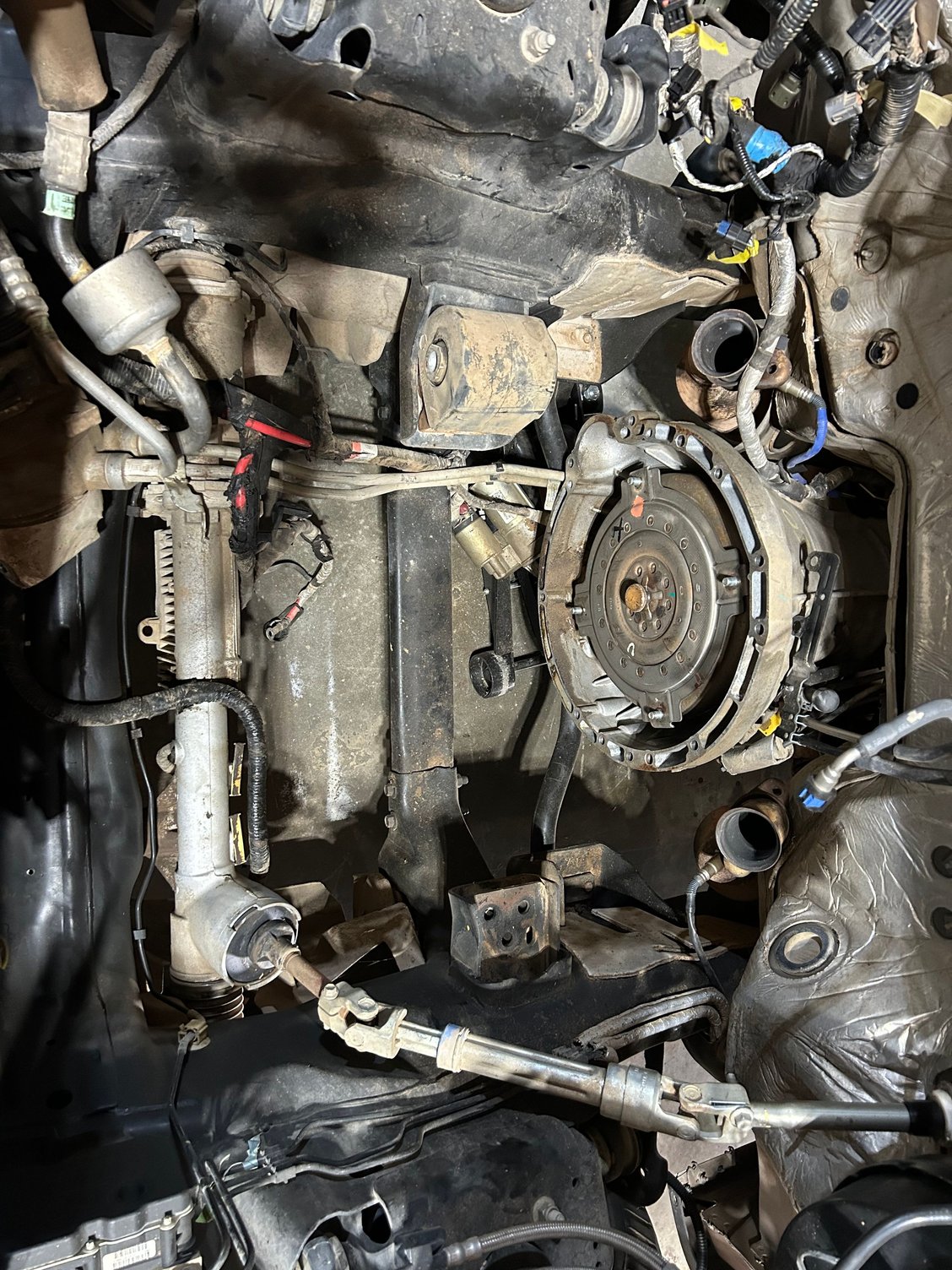

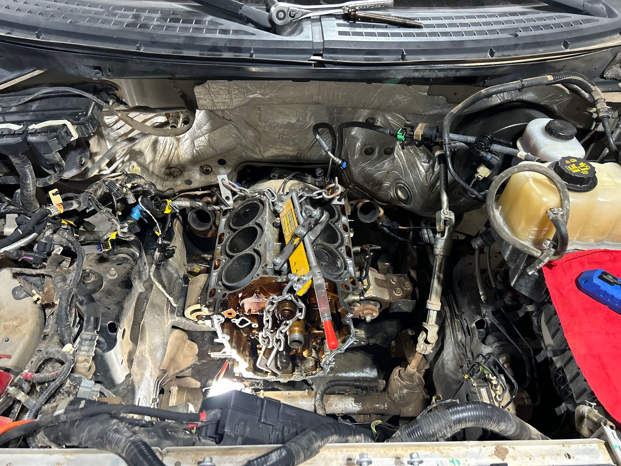

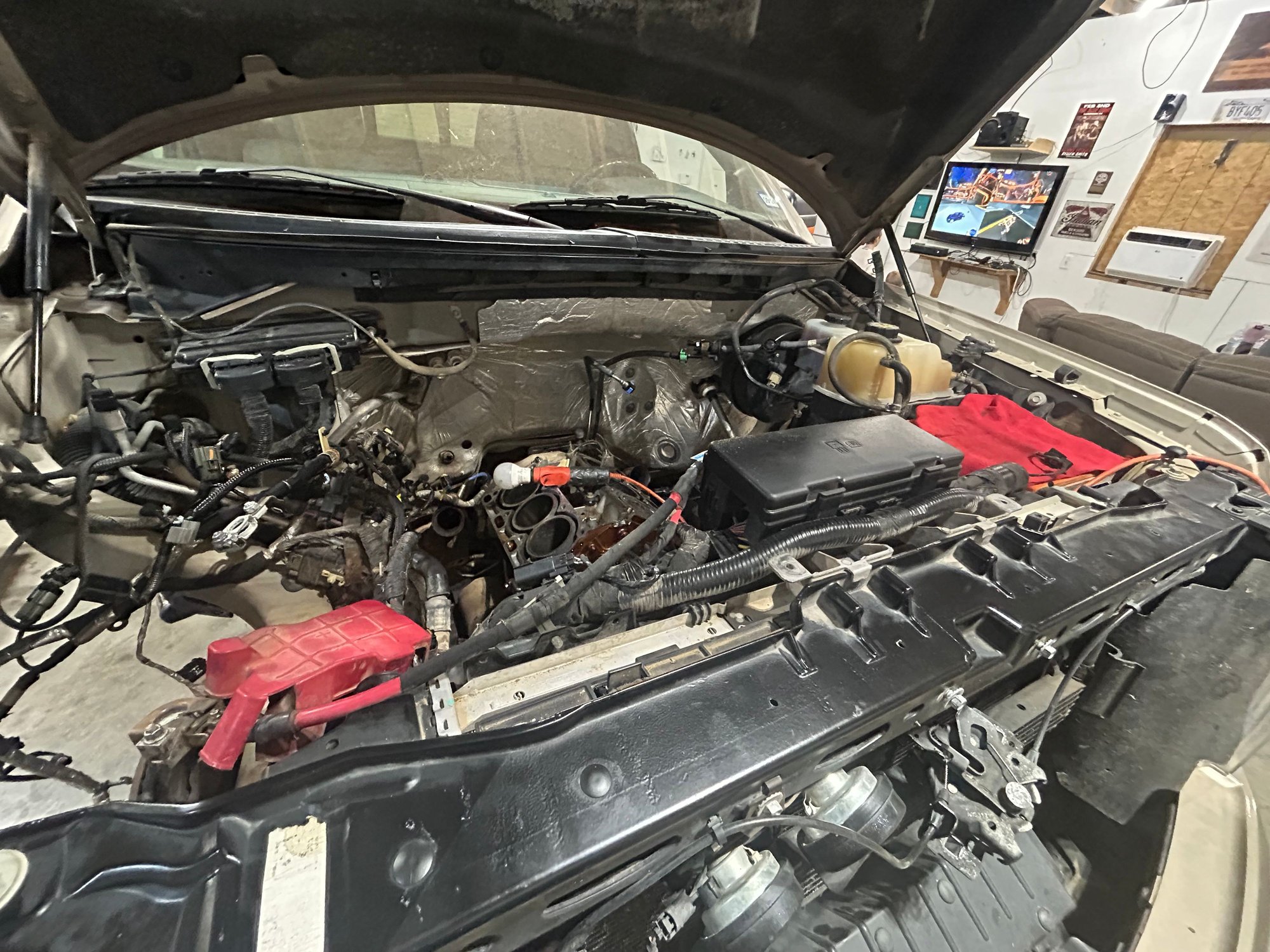

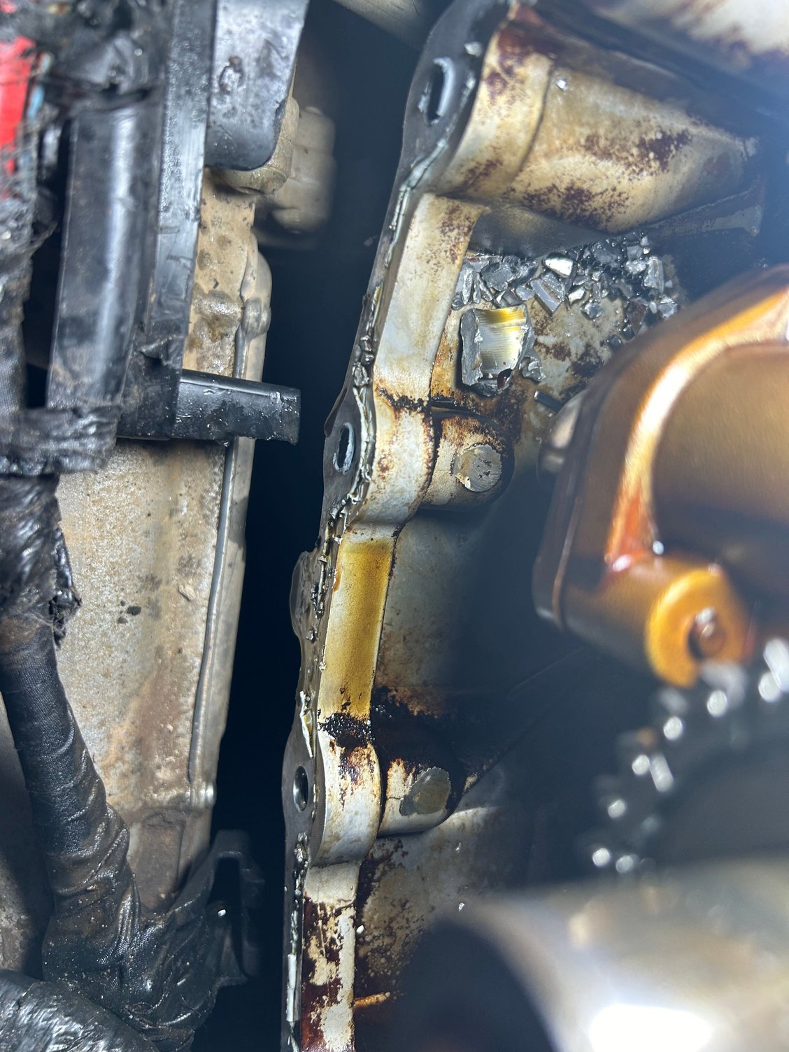

I recent bought my son his first rig. 2012 F150 3.5 EcoBoost. Darn good shape for a $4k pickup. Timing was jumped when I hauled it home. Did the timing set and it ran great for about 10 days before it sent a valve through the piston. New long block on order, but I’ve already started tearing the old one out. Going out the front and not taking the body off.

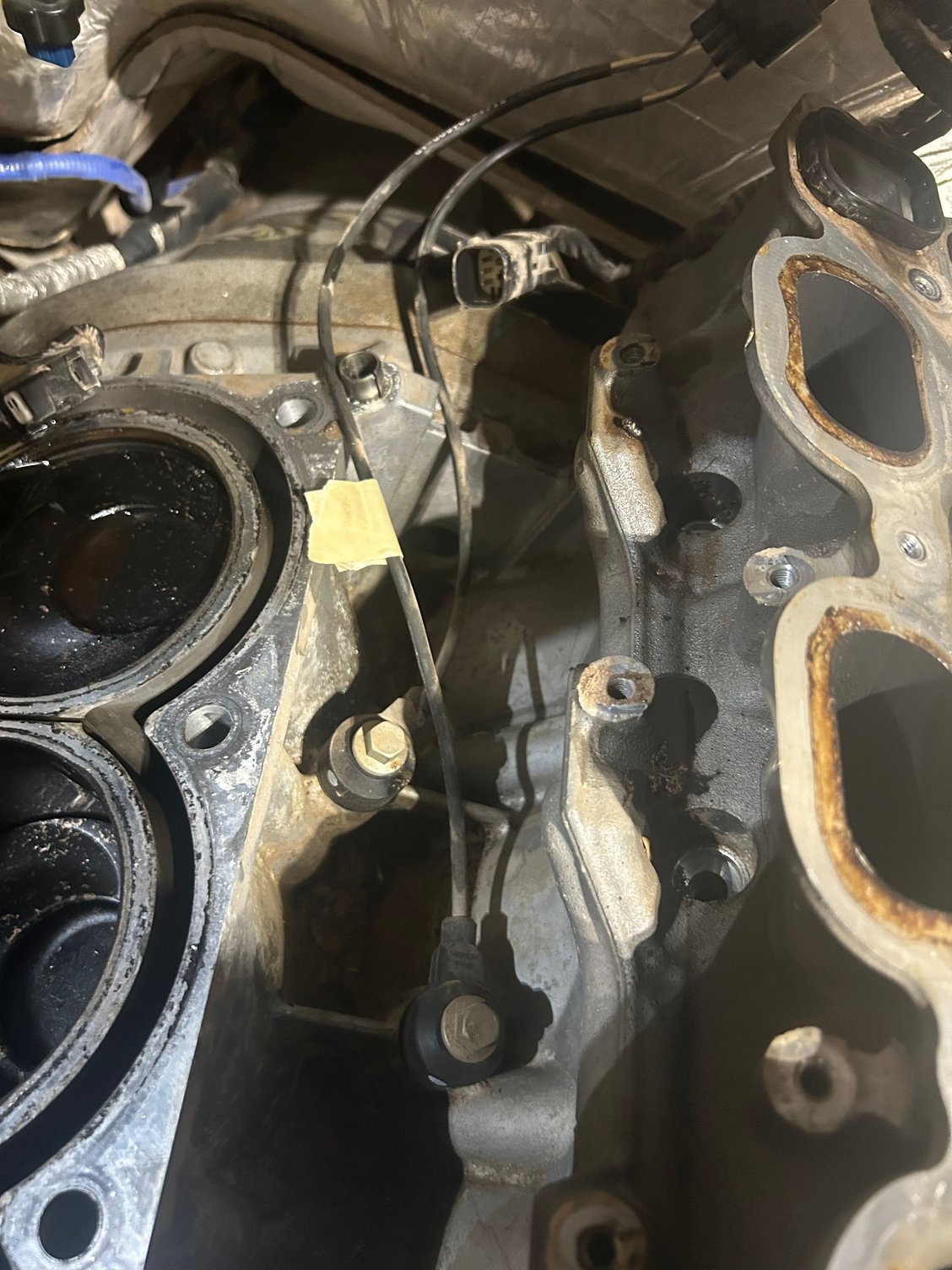

Having said that, can anyone help me with the 2 wires in the valley between the heads? I think they are bonding wire but doesn’t make much sense to me as they plug into the harness. I am not even sure how to reinstall these with out pulling the heads of the new long block, because I sure don’t want to do that.

Knock sensors.

When installing Knock sensors on your replacement motor follow the torque spec.
To tight or loose will cause issues.

Thanks for the heads up. Been wrenching a long time, never dealt with knock sensors.

Todays engines, those sensors are probably the most important ones on the engine, variable cam timing requires them. Custom tuners use them as well.

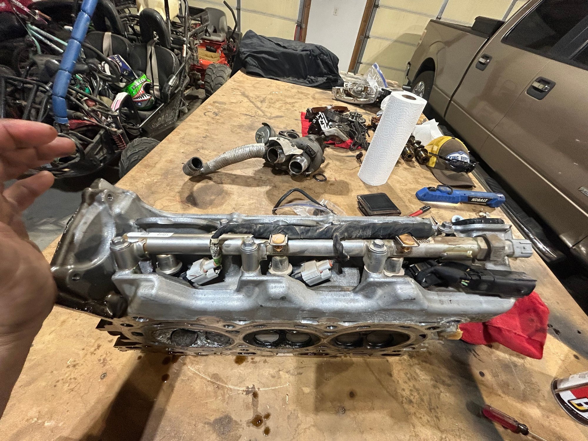

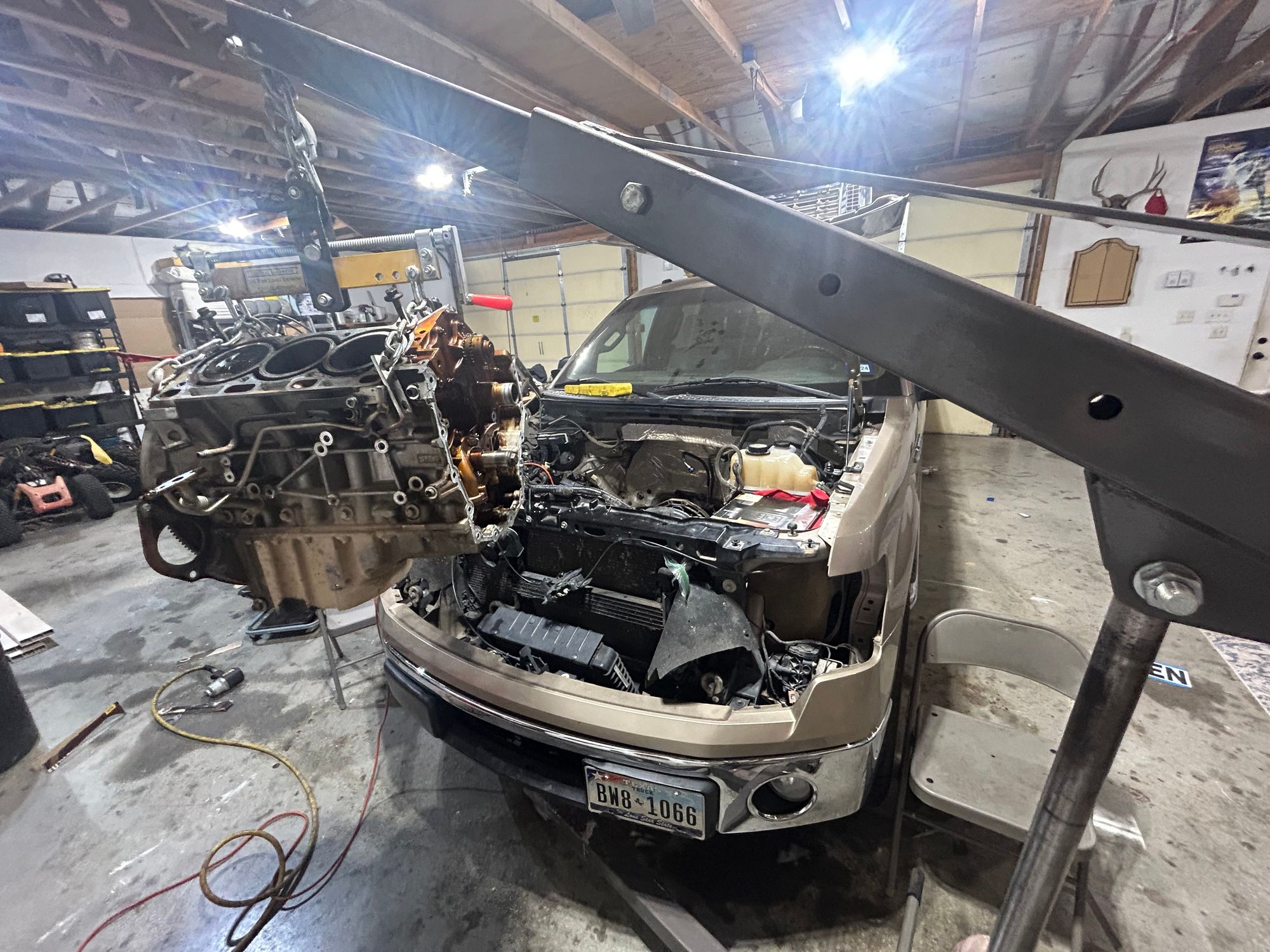

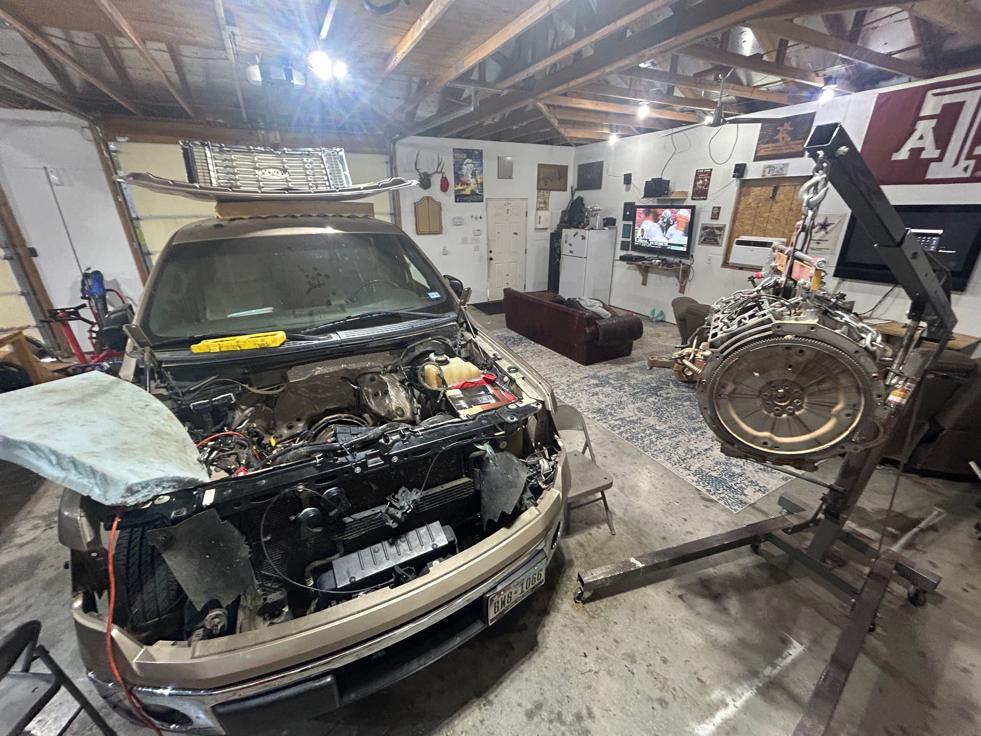

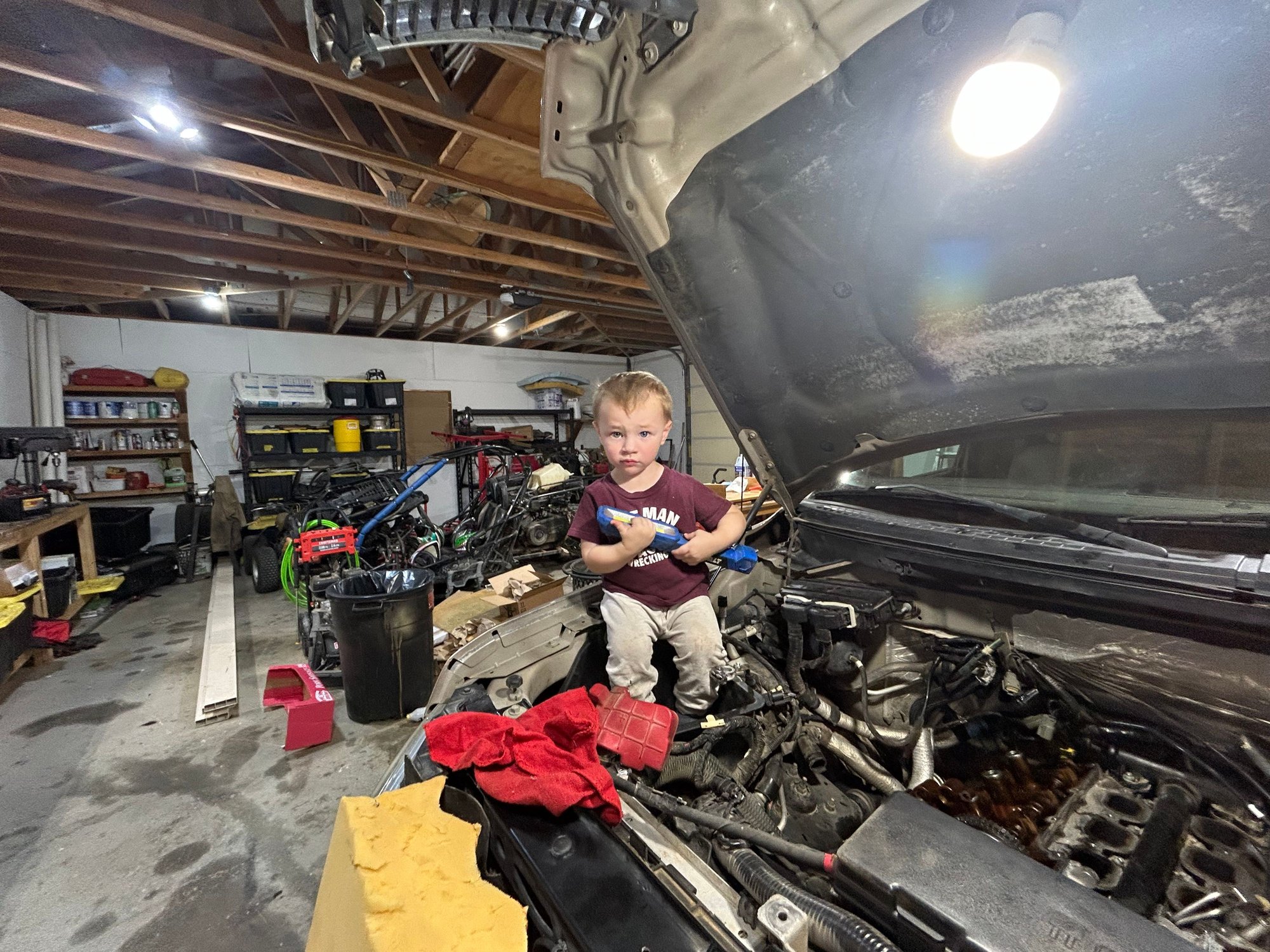

Progress made. Engines out. Managed to not remove the radiator or entire front support. Evidence shows that a couple of trouble making valves decided not to play nice. Scattered the piston and rod. Had some good help tho. Man there’s a lot of crap on these new rigs.

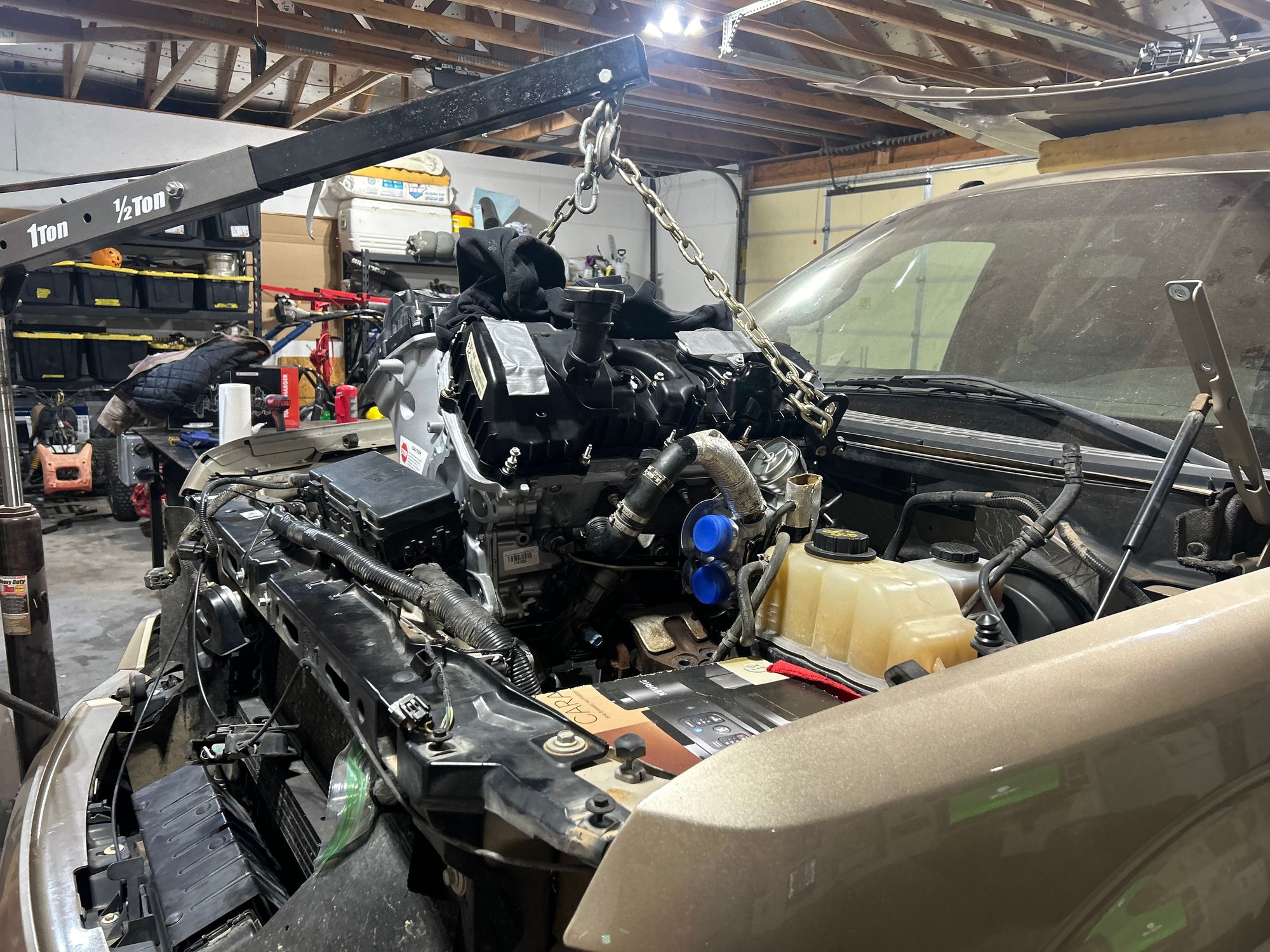

Got her done

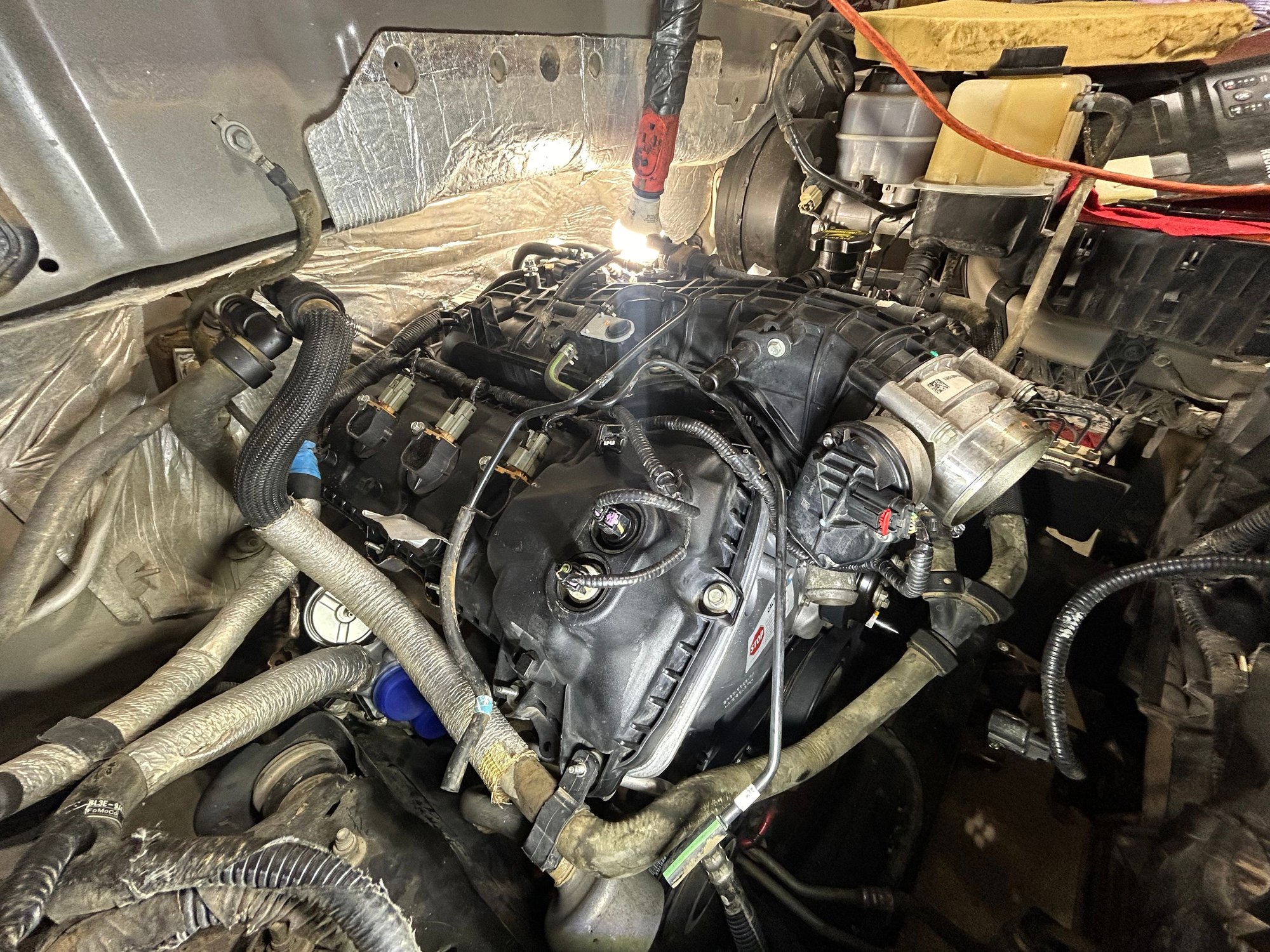

That was a project. It is obvious that engineers nowadays have never worked as mechanics and mechanics are worth their shop rate. The complexity of the design and incorporation of computer controls have taken all the joy out of turning wrenches. That and not leaving enough room to fart let alone get your hand on a bell housing bolt.
All whining aside, it’s done and running great other than the old permanent P054a/c codes are still present. Replaced every sensor and solenoid from the air filter to the down stream O2 sensors. Cam position sensors, crank position sensors, pressure, temp… all of them. We have driven it about 300 miles now still can’t dump those codes. Fuel trims are still stuck at default and mileage has averaged around 11 mpg on about 50/50 city hwy.
I will try the PCM dump truck on the battery tonight, but the battery was out of the truck for about 2 months. I figured the PCm would have cleared in that time, but those two codes were present before I cranked on first start. So if any folks have additional tips other than the Mackuloco (who are awesome BTW) I’m all ears.
