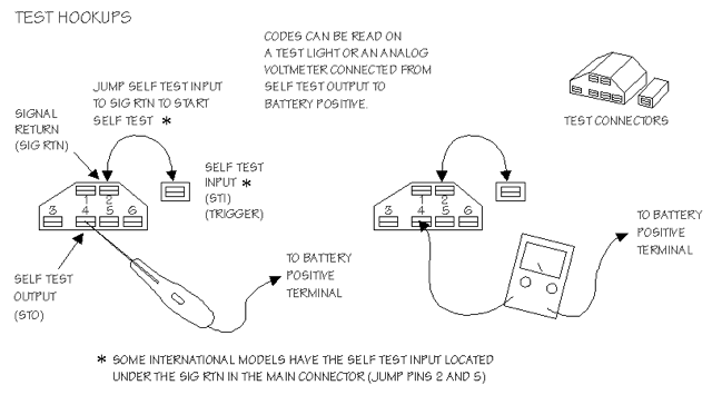

I have no code reader that will work on a truck this old, and don't know where to look for my problem. Any suggestions would be appreciated!

You don’t need a code reader

Yes, pull codes.
