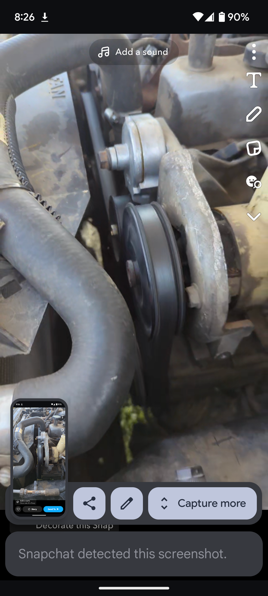

Your tensioner appears to be original AND missing a part of it. It also appears to be physically deformed but it could be the photo deception. Frankly, you have 0 to gain belt wise when you dont even have the tensioner doing its job.
Replace the tensioner and ensure youre using the right size belt. The ac compressor pulley is different depending on the year, application, and TSB sometimes. The proper Tensioner has marks to show you if its properly adjusted, they are small arrow like things

THe tensioner was aftermarket, AC Delco I think, I put it on two months ago. I'm suspecting that is the problem, I will double check the belt size though

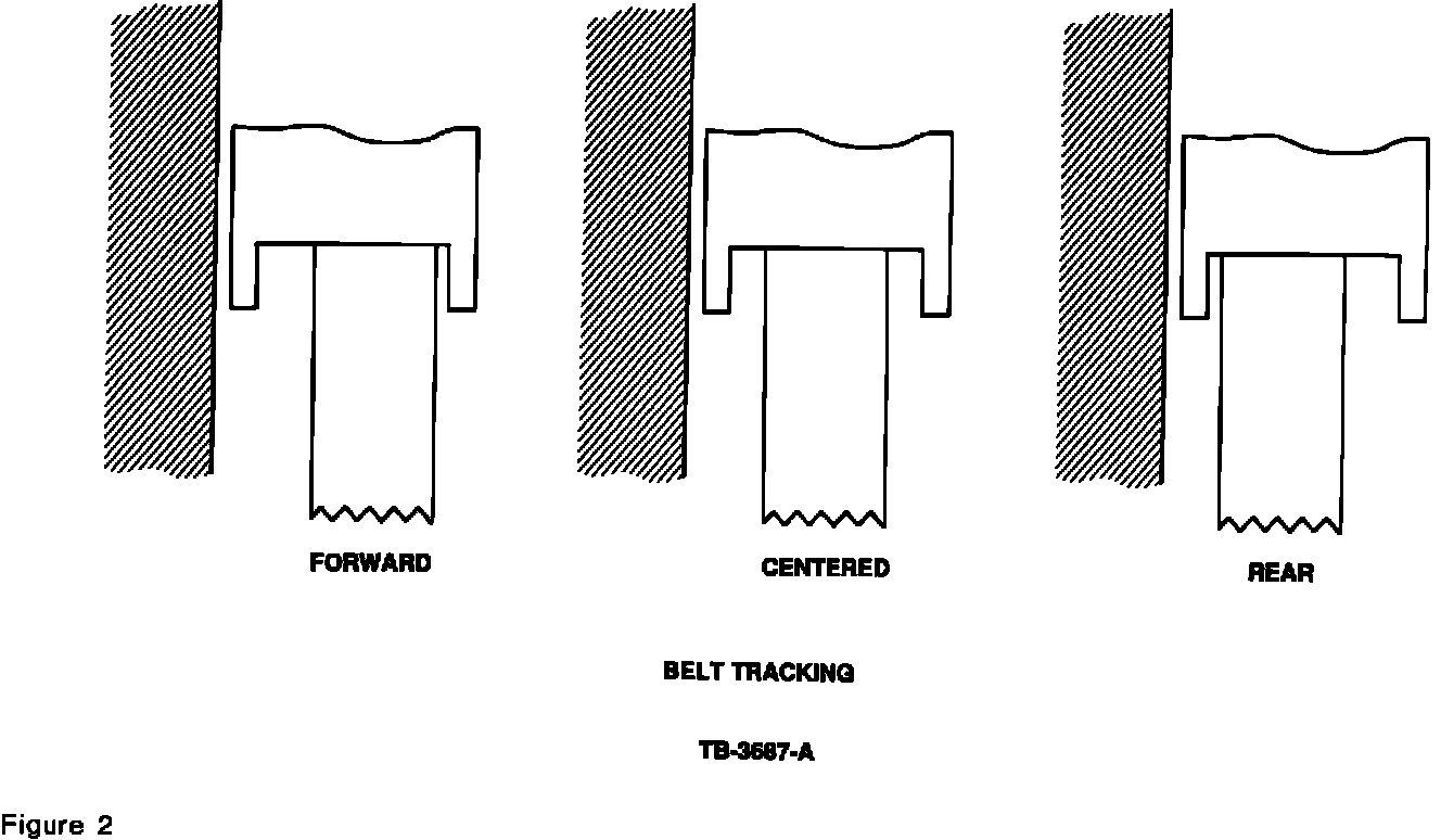

ISSUE:
Front-end accessory drive belt (FEAD) belt noise may be heard and excessive belt edge wear or loss may occur.
^The "chirp" noise may occur at constant engine speeds and all engine loads. It is caused by belt/pulley misalignment.
^The belt "squeal" noise is intermittent and is heard during engine speed variations, usually at engine start up. The noise is caused by belt slippage.
^Belt edge wear and/or belt loss is caused by belt mistracking across the automatic belt tensioner. If the automatic belt tensioner is out of parallel, the belt can be "driven" to either flange of the pulley, causing belt edge wear and in some cases, the loss of the belt.
ACTION:
Use the following service procedure to correct these conditions.
BELT CHIRP
1.Start the engine and while idling, wet the ribbed side of belt by spraying water on the belt where it enters the A/C compressor pulley.
2.Listen for belt "chirp" as the belt dries at the entrance point of each grooved pulley to identify the noisy pulley.
3.If the "chirp" is at the power steering pulley entry, check for belt mistracking on the tensioner pulley, otherwise go to Step 13.
4.Check press of the power steering pulley. The pulley hub should be flush with the end of the pump shaft.

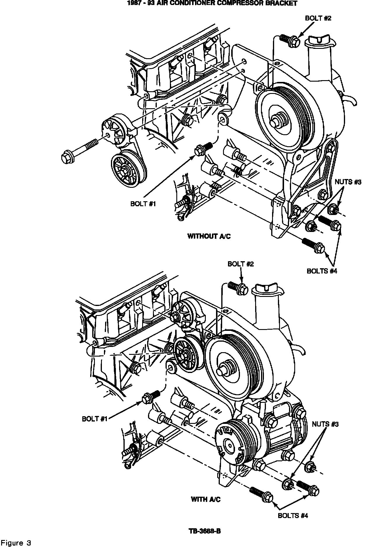

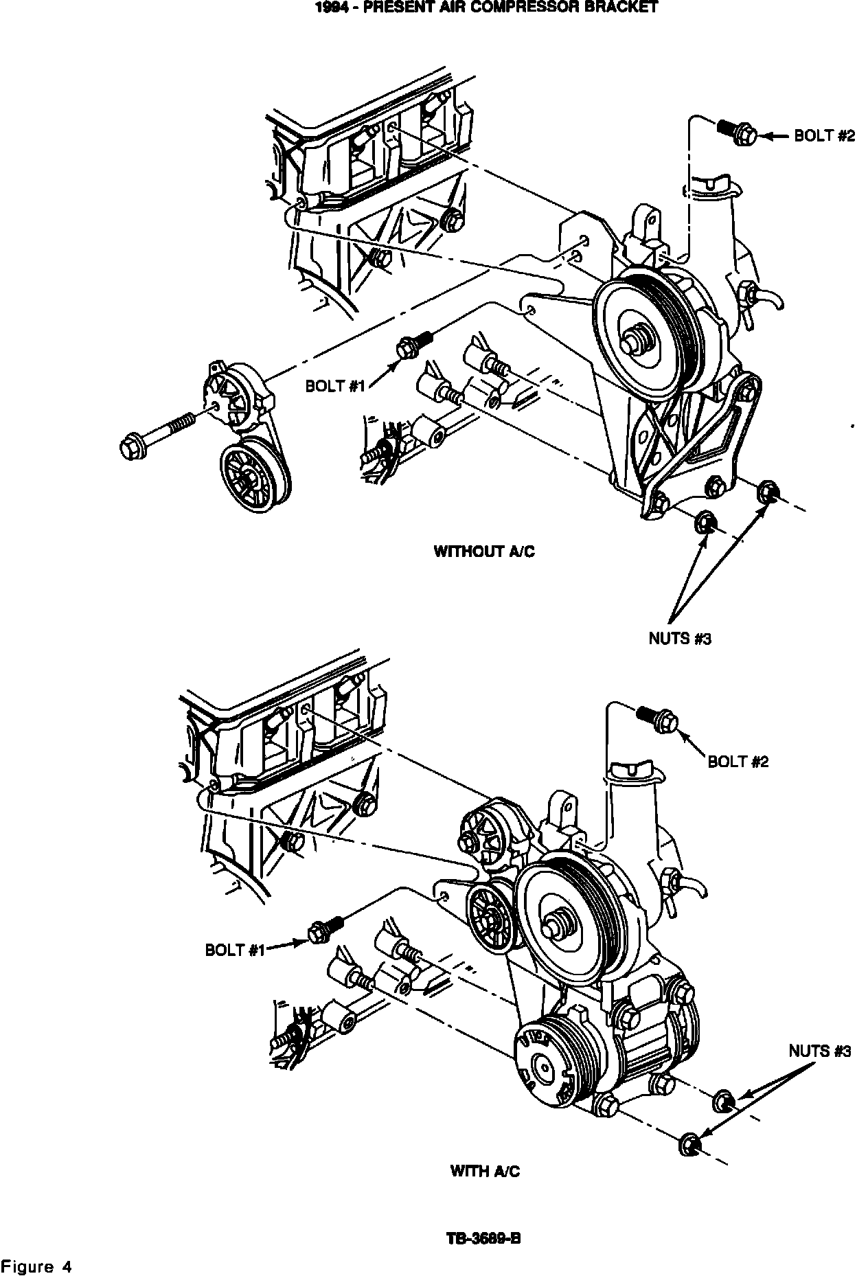

7.Loosen all fasteners attaching A/C bracket to cylinder block and cylinder head. See Figures 3 and 4.
8.Tighten nuts # 3 (and, on 1987-93 model only, bolts # 4) on side of cylinder block to 62 N-m (46 lb.ft).
9.Tighten bolt # 2 on side of cylinder head to 47 N-m (35 lb.ft).
10.Tighten bolt # 1 on front of cylinder head to 47 N-m (35 lb.ft).
11.Install the accessory drive belt. Be sure belt is installed with arrow mark denoting original rotation of belt.
12.Start engine and check for belt "chirp" noise.

BELT EDGE WEAR AND LOSS
1.Remove and replace accessory drive belt with new service replacement belt. See Figure 1 for correct parts usage.
2.Start engine and while idling, observe location of belt on automatic tensioner pulley. If belt tracks near the pulley flange, Figure 2, replace with automatic tensioner (E7TZ-6B209-G).
3.Start engine and observe belt movement. If belt moves too far rearward on tensioner pulley, proceed as follows:
a.With belt installed, loosen all A/C bracket fasteners. Belt tension will pull A/C bracket inboard towards the engine. (Refer to Figures 3 and 4 for bolt and nut position identification.)
b.Tighten bolt # 1 on front of cylinder head to 47 N-m (35 lb.ft).
c.Tighten bolt # 2 on side of cylinder head to 47 N-m (35 lb.ft).
d.Tighten nuts # 3 (and for 1993 and prior model years, bolts # 4) on side of cylinder block to 62 N-m (46 lb.ft).
4.Start engine and observe belt movement. If belt moves too far forward on tensioner pulley, proceed as follows:
a.Remove accessory drive belt and loosen all A/C bracket fasteners.
b.Pull A/C bracket toward drivers side of vehicle.
c.Tighten bolt # 1 on front of cylinder head to 47 N-m (35 lb.ft).
d.Tighten bolt # 2 on side of cylinder head to 47 N-m (35 lb.ft).
e.Tighten nuts # 3 (and for 1993 and prior model years, bolts # 4) on side of cylinder block to 62 N-m (46 lb.ft).
