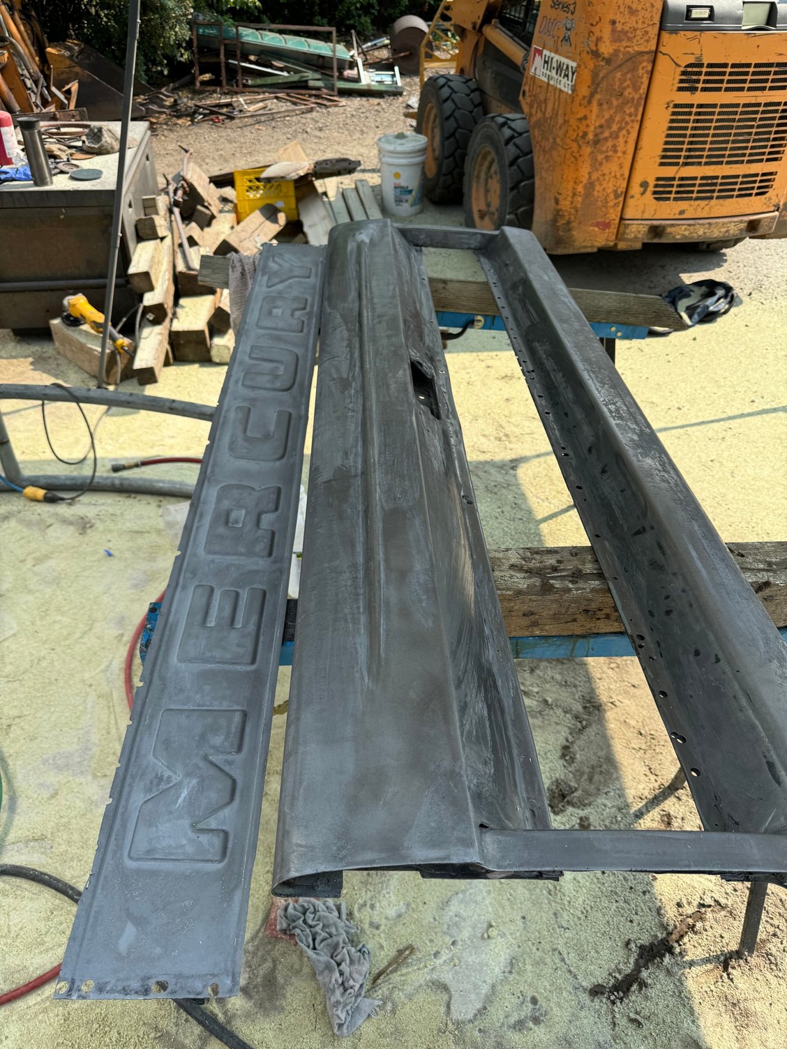

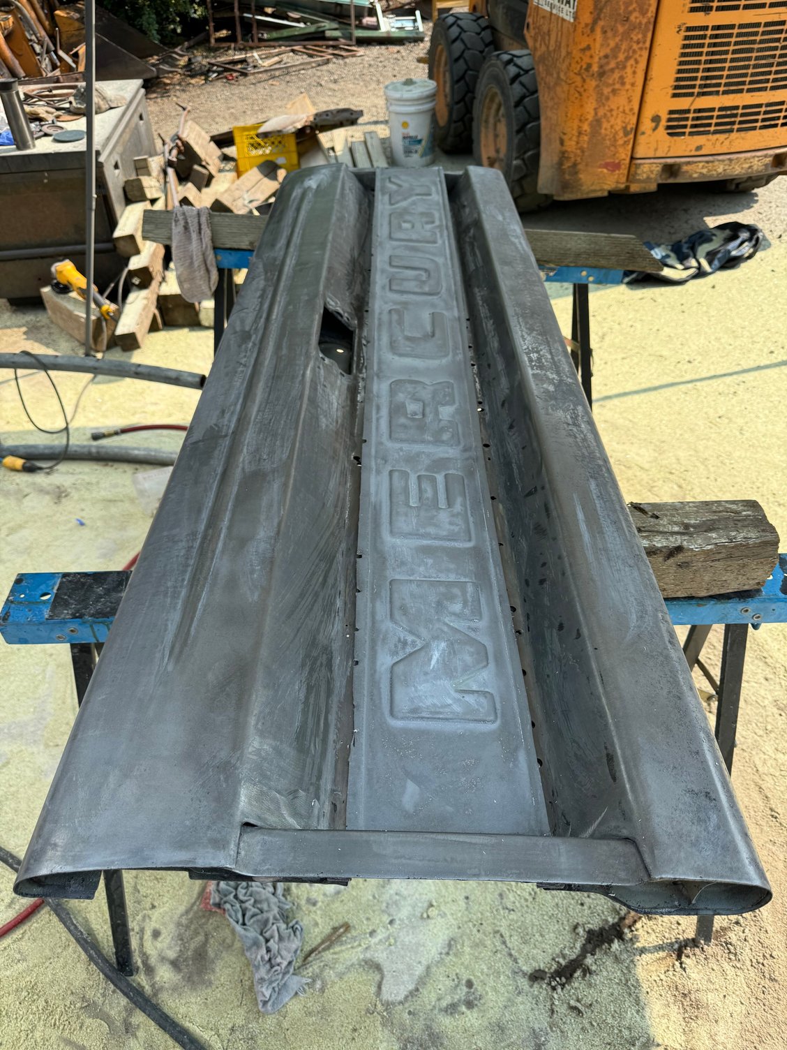

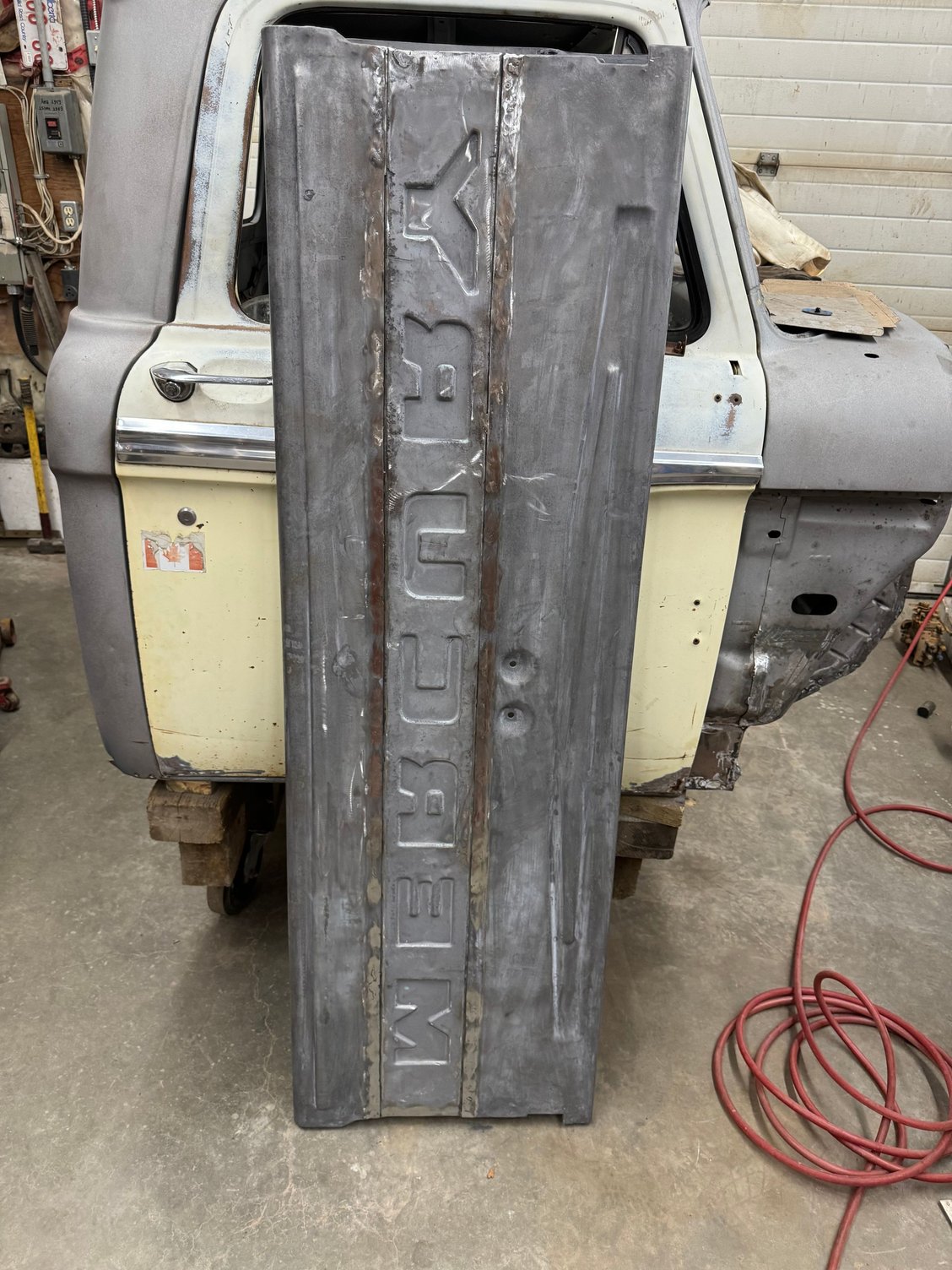

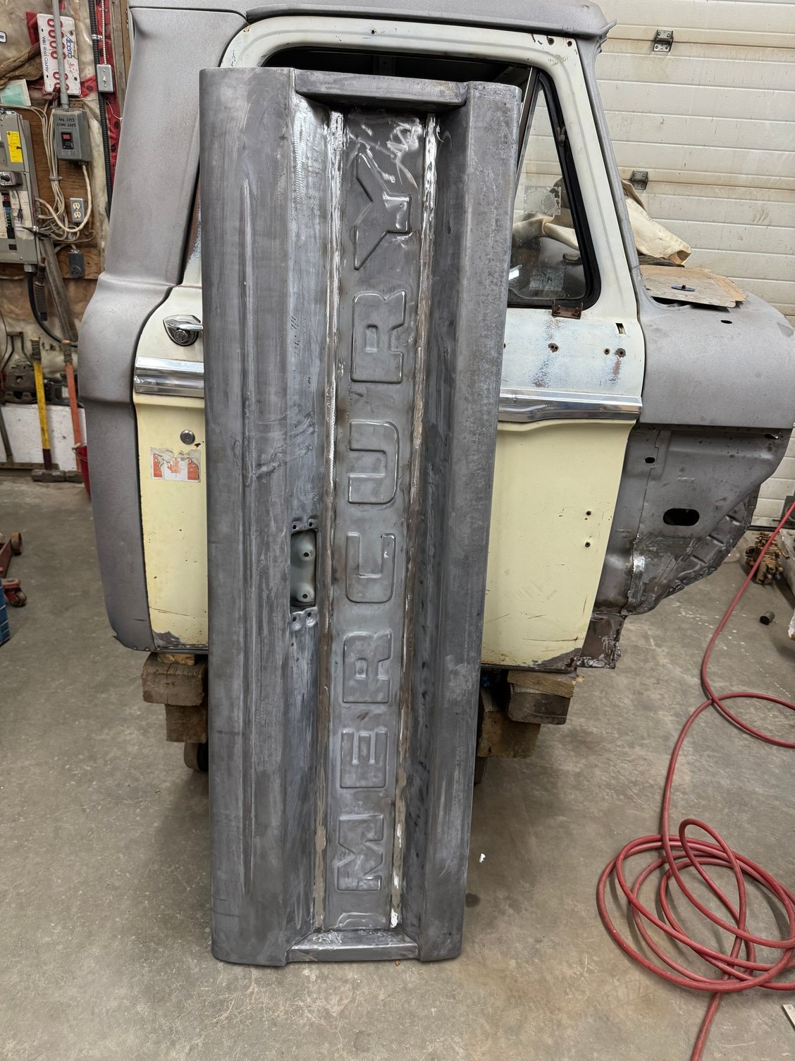

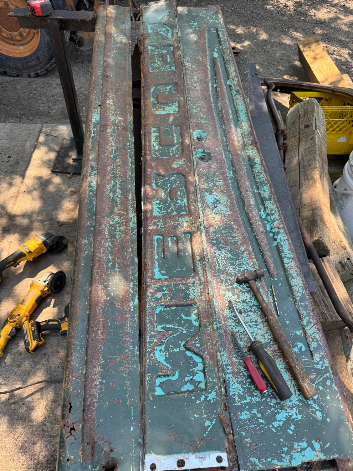

I had a nice Ford tailgate and crappy Mercury tailgate. I cut out the Mercury centre and the ford centre and made a new Mercury tailgate. I am pretty happy how it turned out. It’s for my 66 Mercury 100 4wd truck. Doug.

NICE JOB, MUPPY! LOOKS GREAT TO ME!

Good job! 👍🏻

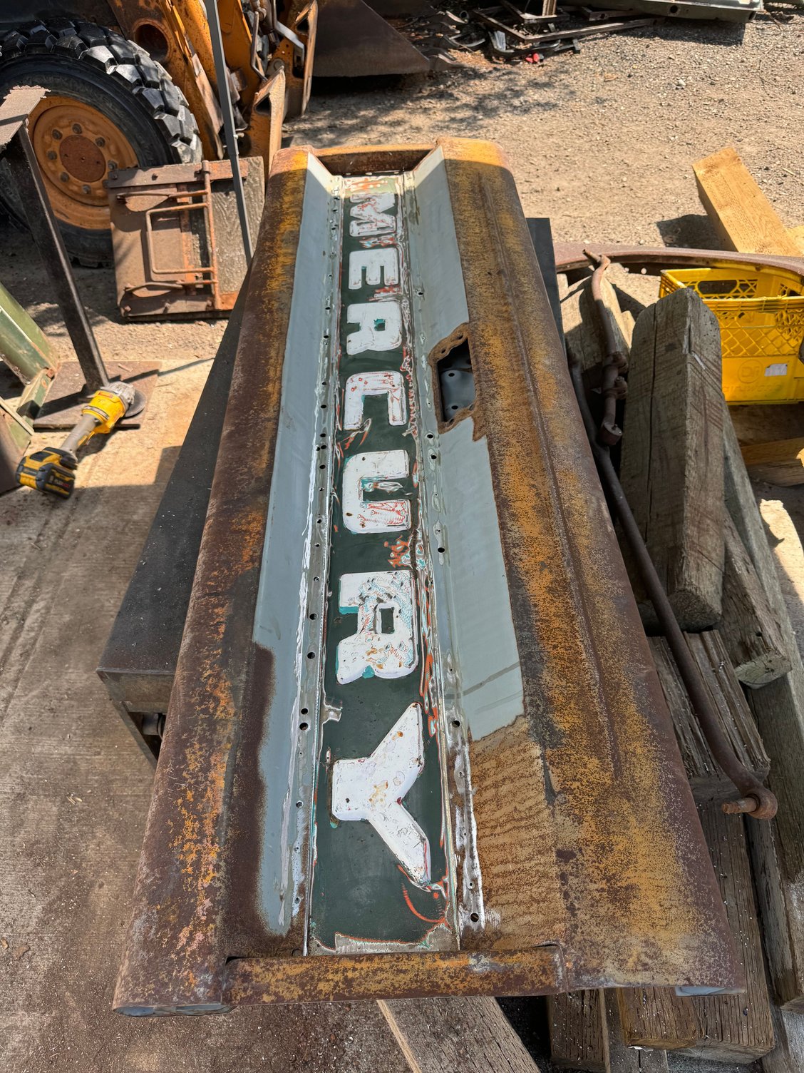

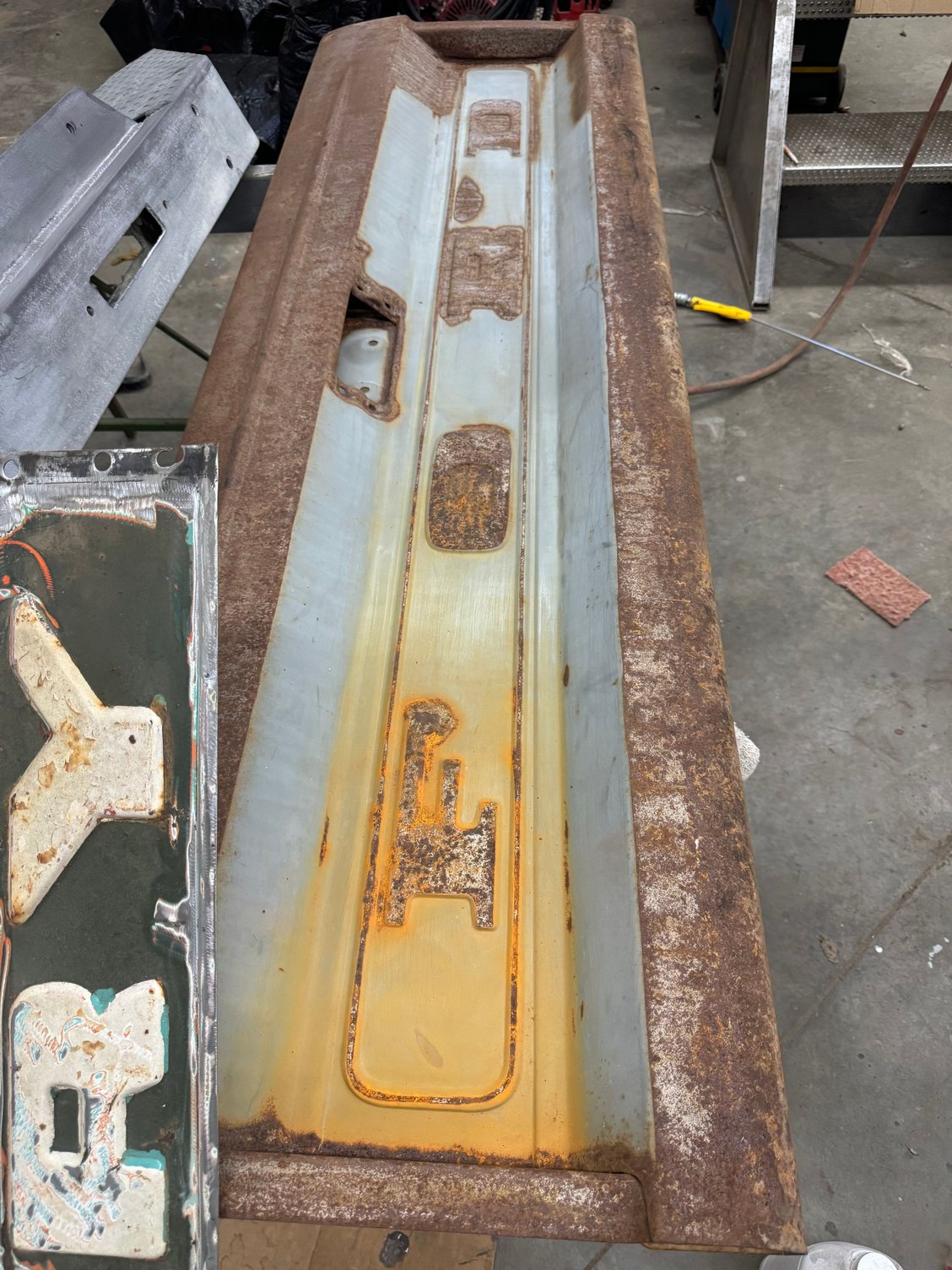

Muppy: Nice Work! .......But, that gate is off a Bumpside, and the line that runs across above the latch handle is a BEAD on Bumpsides, but a STEPROLL on Slicks.
Here's a Slick Merc Gate to illustrate (**'64 thru '66 Styleside Ford would have the same same line as shown in first pic, not the bead)
....and a bumpside Merc gate with bead for comparison

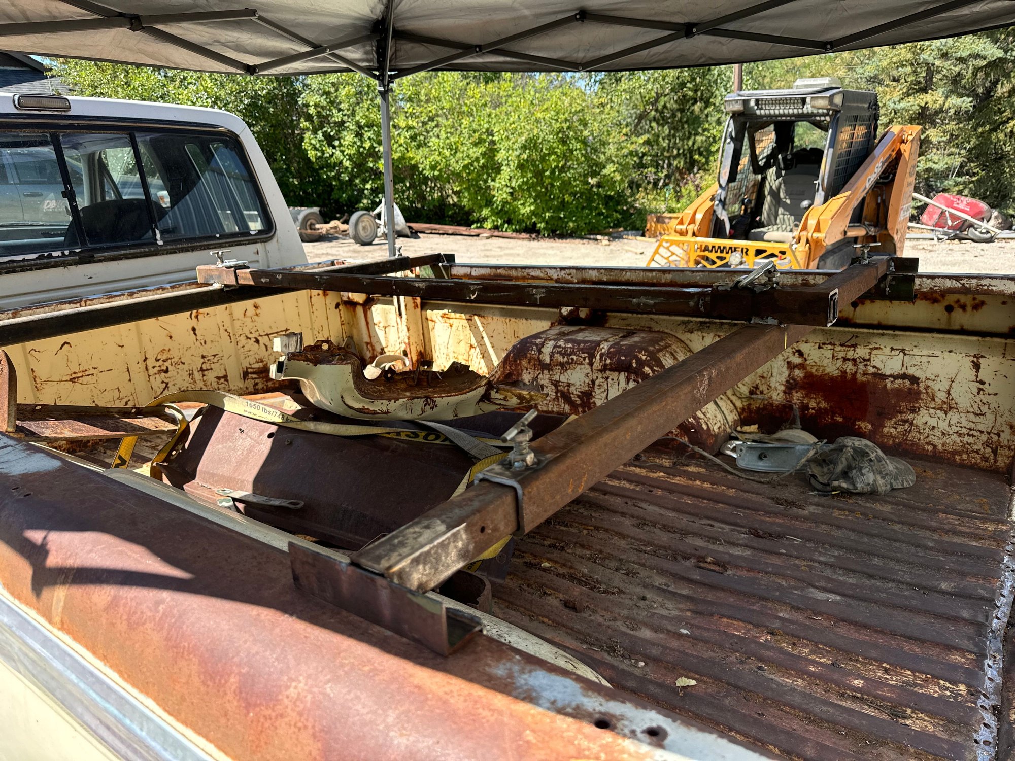

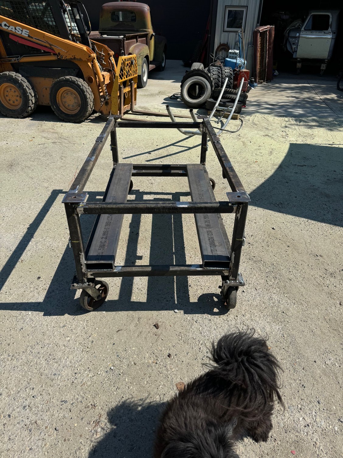

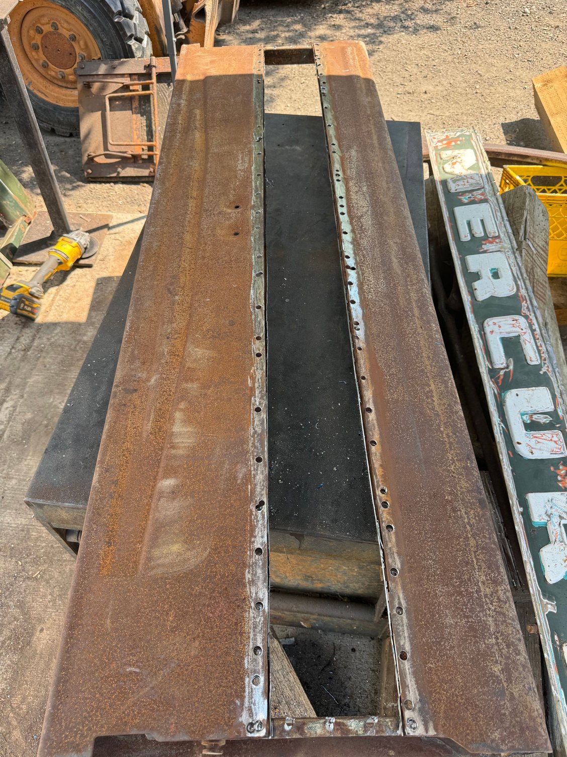

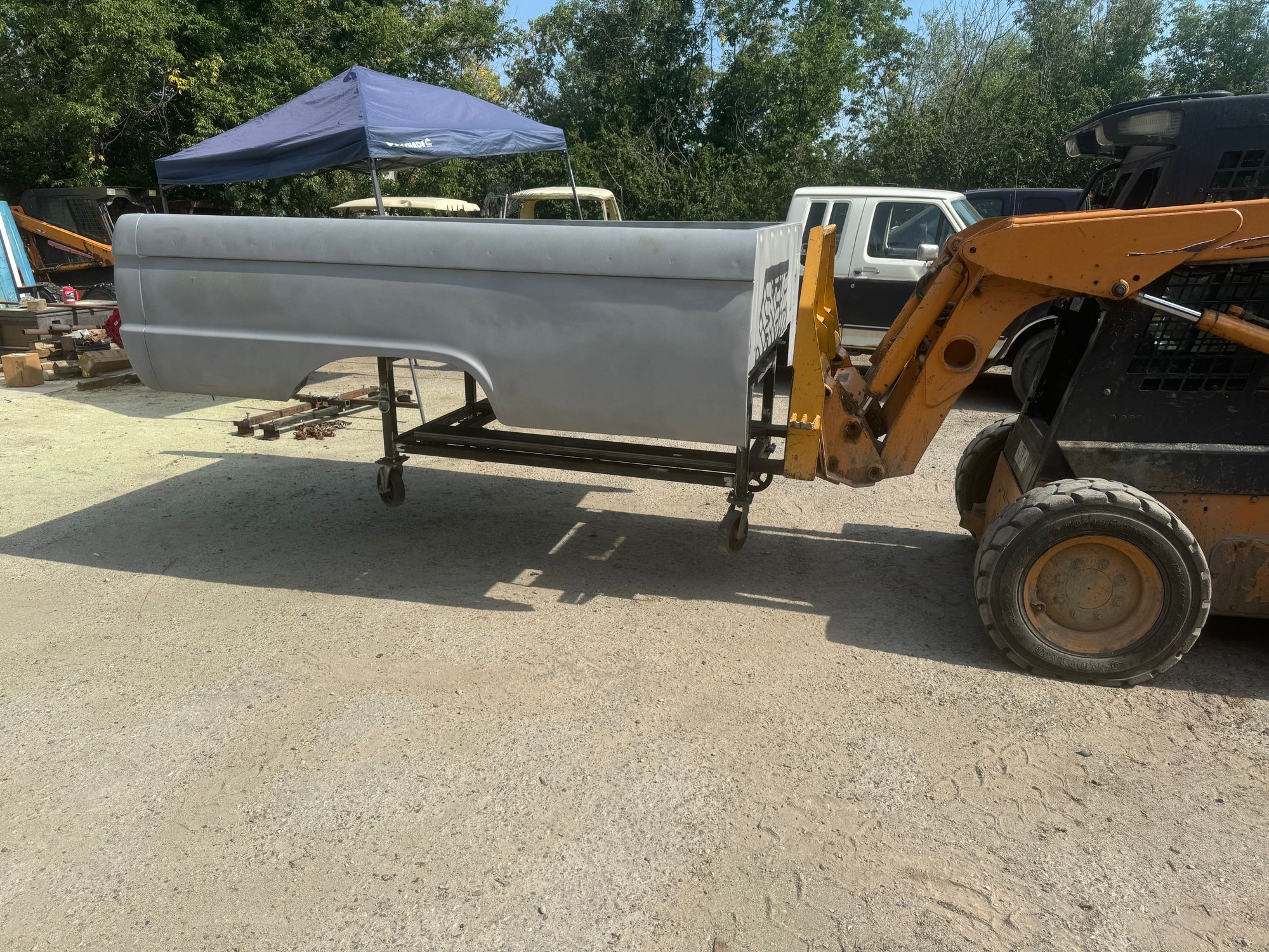

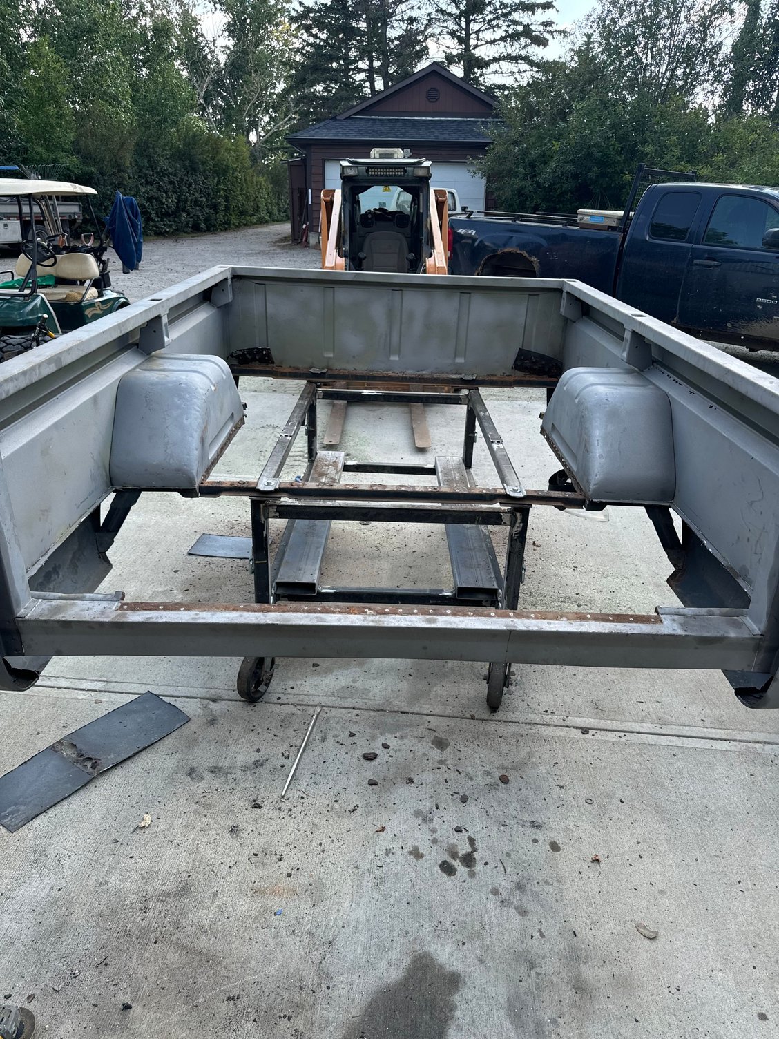

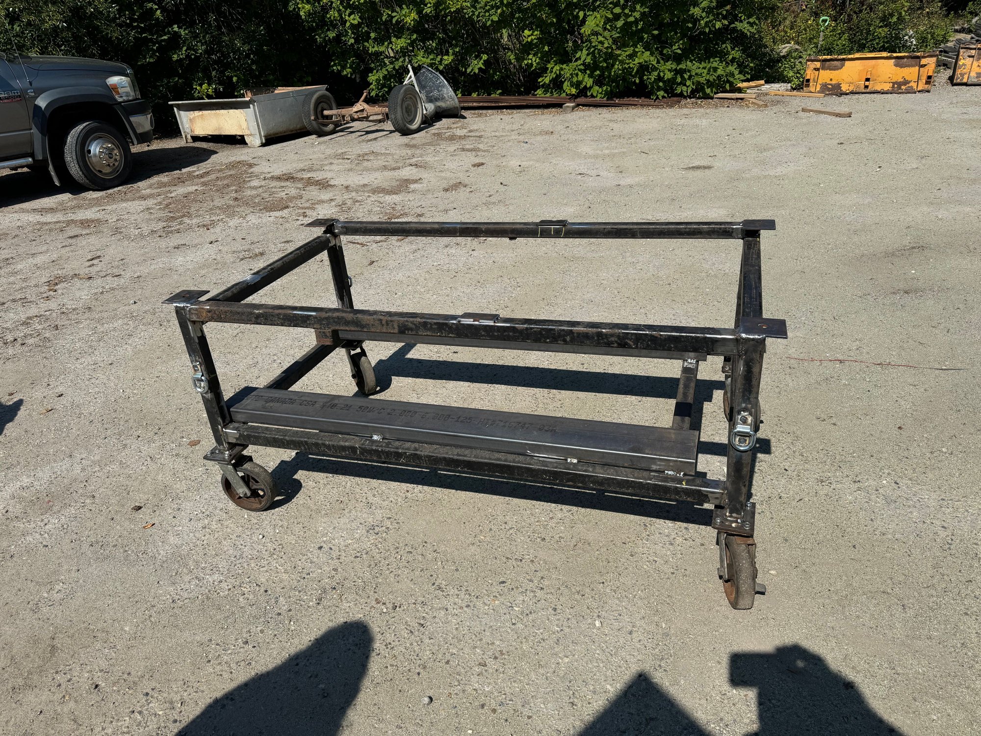

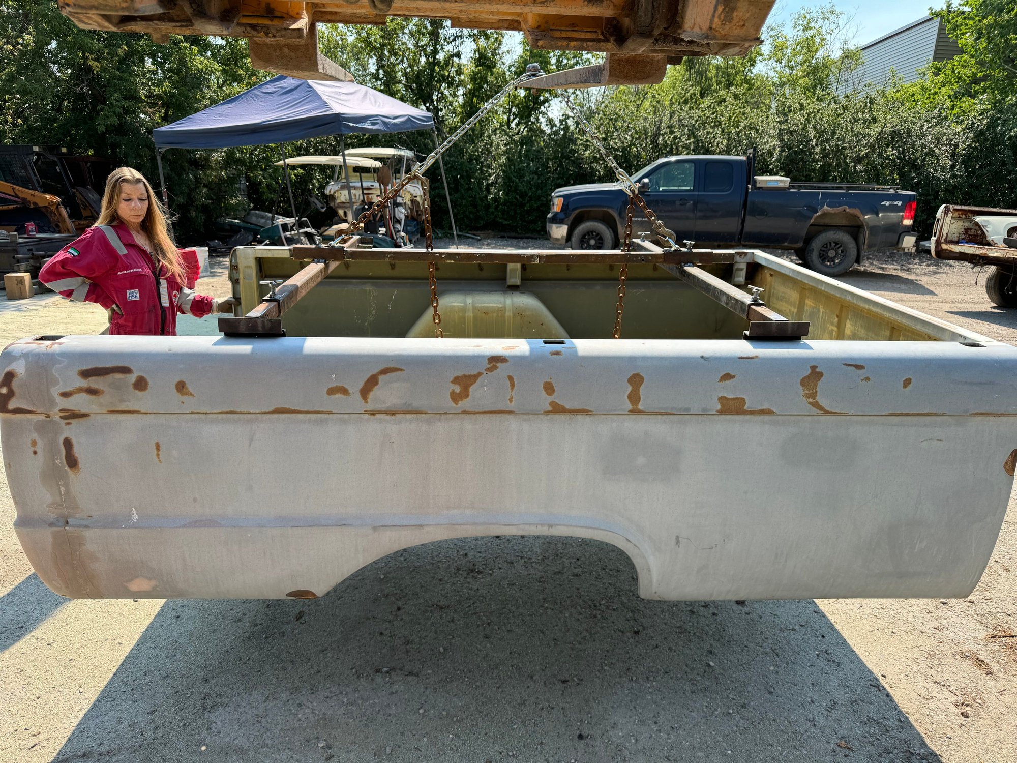

Thanks for all the kind words. Hopefully I encourage other people to work on their trucks. I’m not a professional, just a hobby. I understand James that it’s not the right tailgate. You pointed that out before,but finding another good tailgate is pretty much impossible, so I used it. Now I’m working on the box. Removed the floor to replace with another one from an another box I have that’s rough but the floor is good. I made this cart to attach the box to so I can move it around and lift with skid steer. I also made this bracket to lift boxes.
Doug.

Your fixture for lifting the box and your car look really good ! I could have used that lift device on a couple of occasions!
I added castors to my 37"x60" fab table with 1/2" thick top a few months back, it will serve double duty as a fab table, and a box cart, as needed

No biggy James , I think you sent me a private message and mentioned the guy in strathmore could graft the tailgate together. It actually was much easier than I thought it was going to be. Doug.
