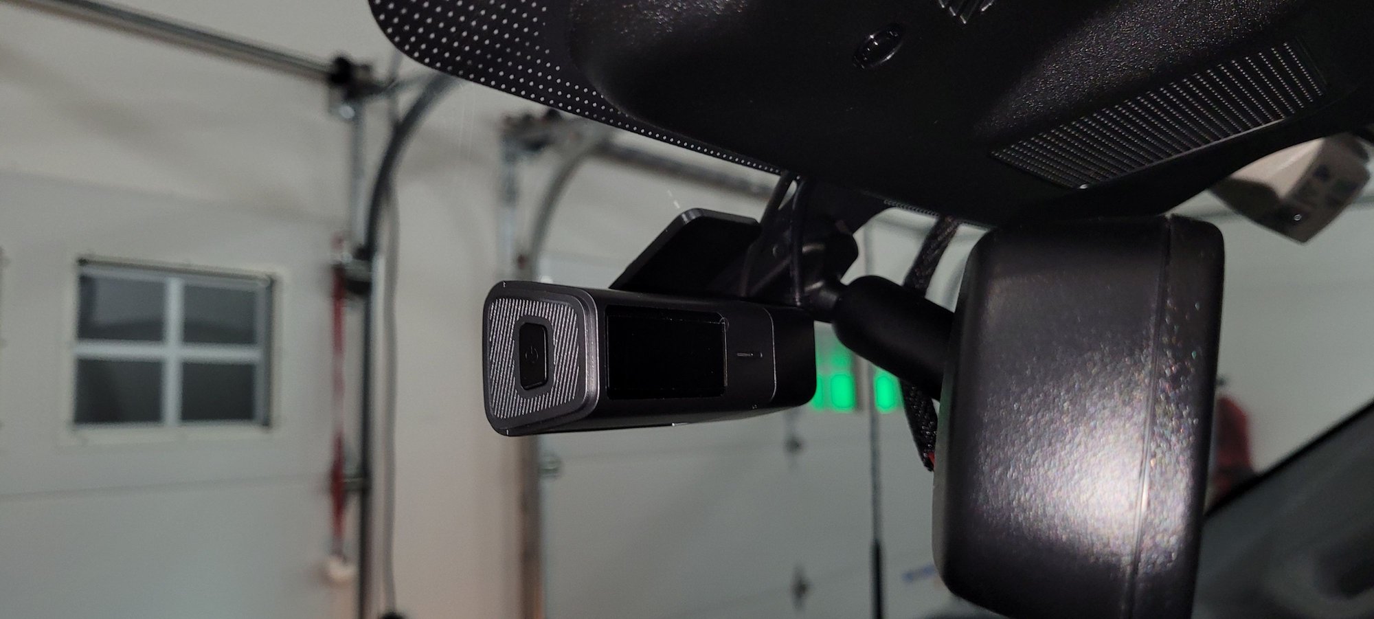

I put my camera in about the same position as yours, just on the passenger side of the mirror. Over there is way out of my field of vision and is much less of a distraction. It's not like I need to be watching the camera to drive anyway. I'm already looking that way!
This spot lets me easily slide the camera backwards out of its mount if I need to do anything with it and it gives a nice centerline view for the video while not blocking any of the truck's cameras or sensors on the mirror.
