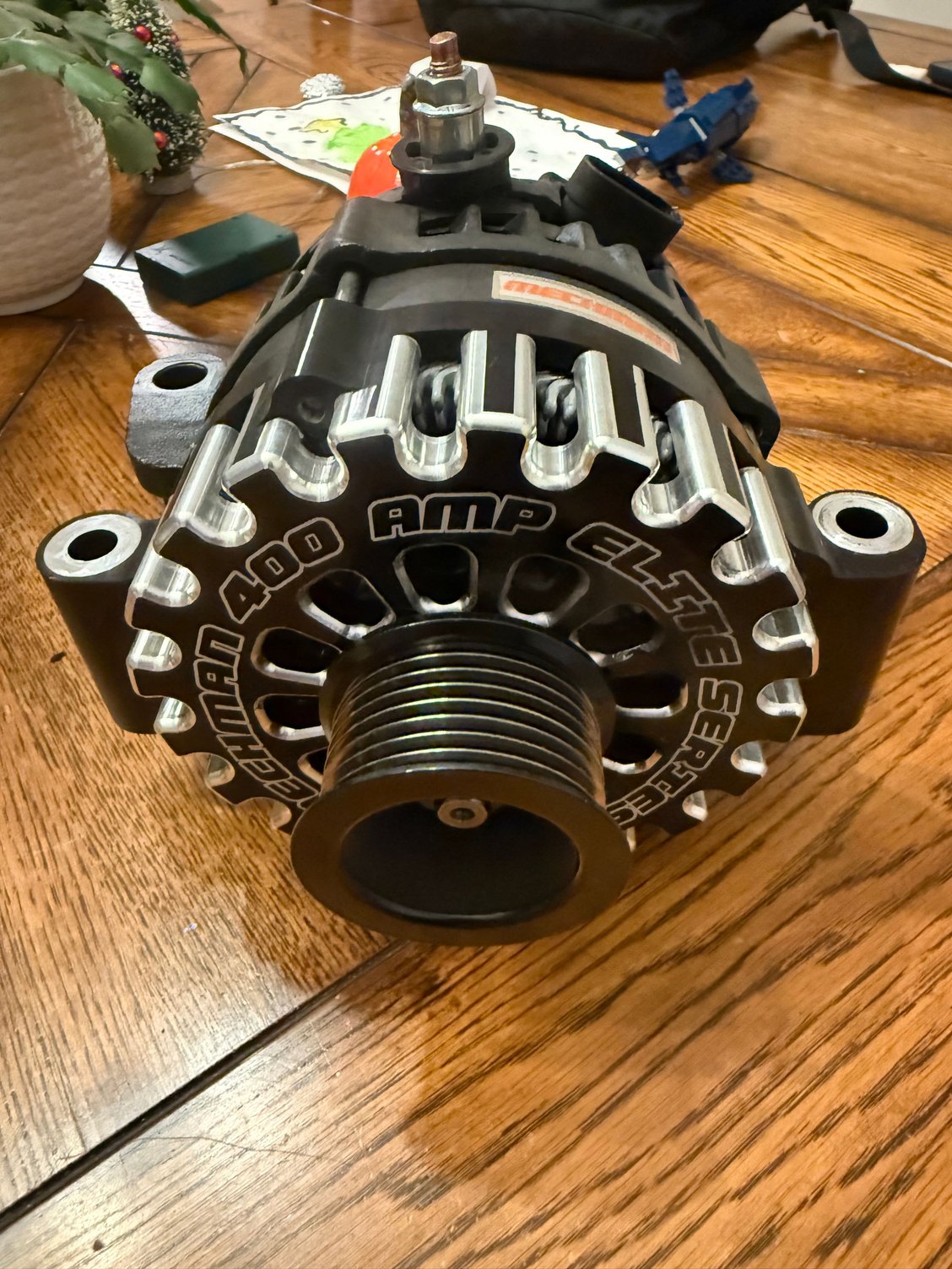

Here is my bosses alternator that I returned to the store and here is the one I put on to replace that POS.
Looks a lot like mine!
Very happy with the Mechman product. I have the 240 amp model.

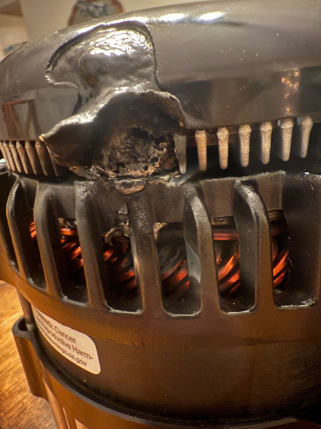

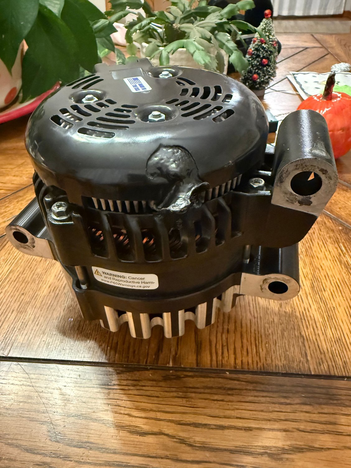

I can't recommend the Mechman anymore...
I must have jinxed myself or something. Maybe it's because mine is a 400A and the lower amperage are fine, IDK.
I purchased and installed mine in Jan of this year. Yesterday I smelled something funny/ burning; I couldn't see anything obvious. Today I noticed my truck was only charging between 12-12.4v@idle but driving seemed to have normal charge. When I got to work I called Mechman. The lady i talked to was very nice, patient and doing what she could to help. She sent me a link to fill out the warranty form. I told her I would look into it more before sending it in.
Well, I go to leave work and it's not charging at all. I had to drive all the way across town to get the kids from school and drive back across town to get home...a 2 hr adventure. Wasn't sure we would make it, voltage was already down to 11.8 volts when we left the school. Luckily we made it home and only dropped to 11.5-11.6v.
Luckily, I had my tried and trued Bosch in the shed.
But now I feel like, even when I get a replacement or get it repaired, how long will it be before it fails again. I've had my bosch for around 12 yrs without issue. Mechman only made it 11 months.
here's what i found...Mechman are supposed to be some of the best

It can't be the alternator's fault because it's got billet. I'm pretty sure adding billet parts makes it more better.
I wonder what failed in there. Think maybe they'd tell you what they got wrong if you sent it in?

Like to hear what failed there. Something got pretty warm there.
