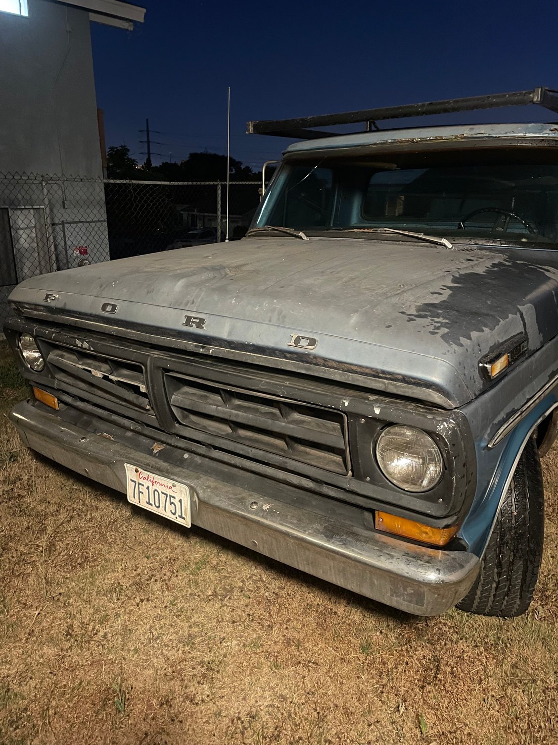

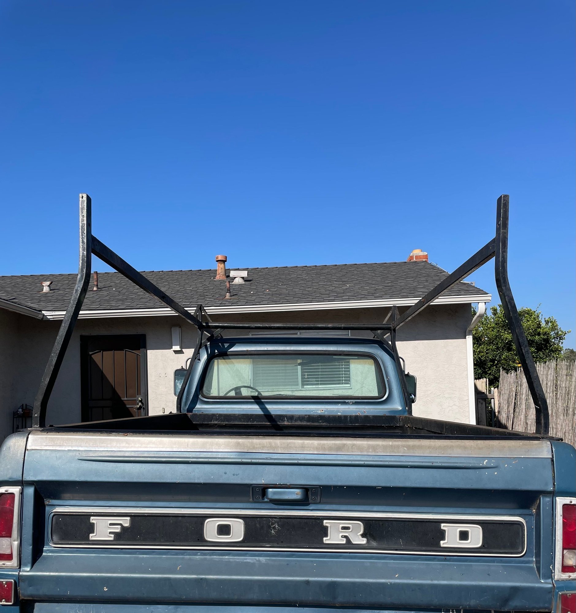

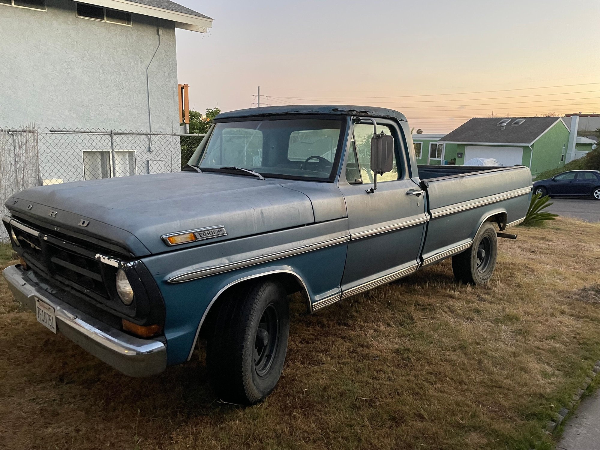

Here are a few pics of the truck. It doesn’t have a name yet so I need to figure that out also. Aside from the roof the body is pretty solid.
I’m trying to get rid of that black paint on the grill

The truck looks straight and looks good. The roof definitely looks bad. Welcome to the forum. Your truck most likely has the sport custom trim level. The custom level has no trim, thats how my 72 f250 is and my 70 f250 is sport custom which has body trim like yours. As for the transmission, where is the fluid leaking from? There only a few places it can leak, the pan, the bell housing, or the linkage. If it coming out of the bell housing, there is the front seal behind the torque converter. The pan gasket is easy, but you usually have to hammer all the bolt holes on the pan flat again and do not over tighten it or it will probably leak. Leaks from the linkage are more involved. There is an o-ring and a seal in there.

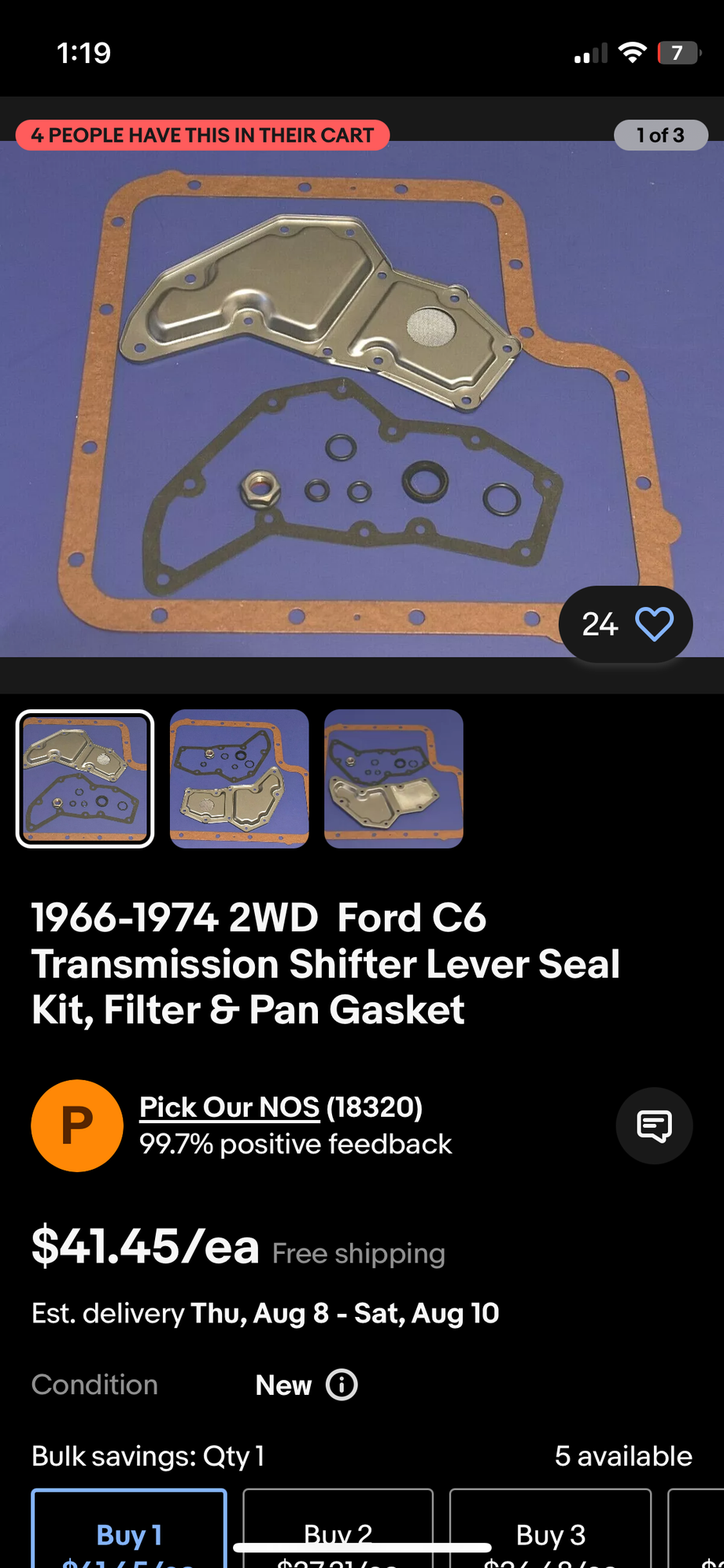

I’m pretty sure it is from the pan and from the shifter lever seal. When I got under it those are the two areas that have pooling of red fluid. Everything else under there around the trans (aside from road grime) is pretty clean. I watched a YouTube video and Its something I can take on. I was looking into a complete kit and found this in eBay. I like the convenience of it all but I’m not sure of the quality. Am I better off piercing one together off of rock auto or summit racing?

When I replaced the seal and o-ring on my 70 f250, that was all I was doing. So, I only ordered the two parts.

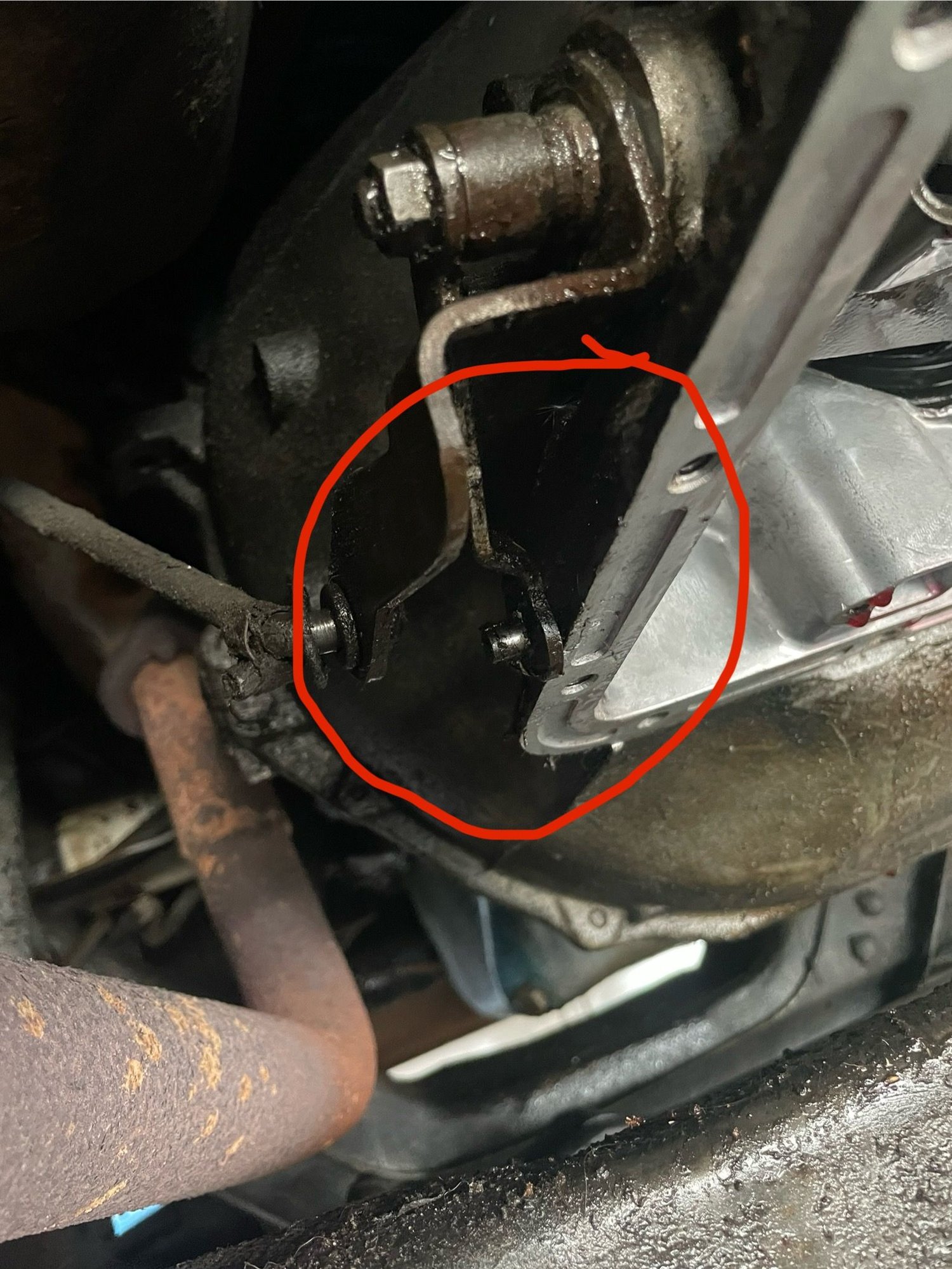

I need some help guys. In the process of changing the gaskets in the transmission pan plus seals etc. when I got to this part I think something is off or missing. There was a zip tie that I couldn’t figure out what purpose it was serving so I clipped it off, but the piece circled in my pic is loosely hanging there. The video I’m following from YouTube seems to have this piece securely in place at a higher level.
Is something missing or is it okay for that piece to just dangle at that level? I appreciate any help. I may pause the project in hopes of a response.

That is probably where your kickdown rod hooks up. From there it goes up to the carburetor.

Here is a diagram that shows the kickdown for the C6 transmission: Item 7A187

Thanks for sharing the part. I guess it’s not really all that necessary to have it connected. The tranny just won’t downshift when I want to pass someone. I will replace it eventually, but is there any potential harm to the transmission right now having that arm just dangling unsecure

Chokoloso A easy way to get rid of the paint on the grill is use Easy-Off over cleaner just remove the grill first if you use it and it needs to be the yellow can. Or take some lacquer thinner and a old t-shirt wet the shirt and start wiping. Now either method is not gonna get all of it off right away , but it will take the paint off. There is always sanding but if your grill is aluminum I Really Don't recommend it.
