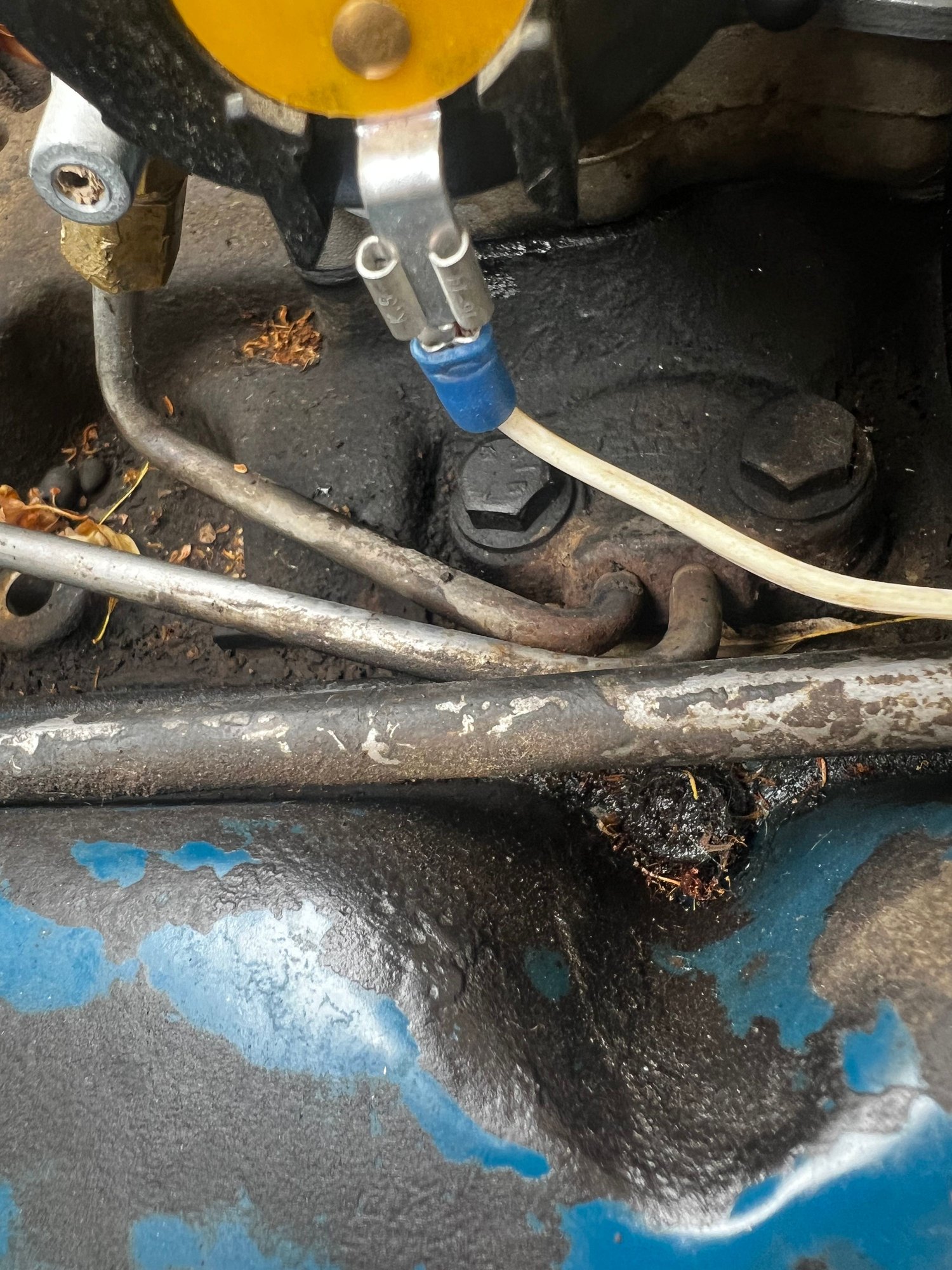

I've done all my research and haven't found a solution that fixes my issue yet, so I figured I'd ask the brilliant minds here.
My son just picked up a 1976 F-150 that has a 351W under the hood...that seems to have not been an option with this truck from the factory, but I have no idea what car this engine originally came out of. We bought it non-running from some kids who gave up on the project after throwing some parts at it, towed it home, and we have it running but it's still struggling. We have it running and idling now, it'll drive down the road, but it continues to backfire out of the carb. The backfire is pretty consistent and increases with the RPMs. Backfires both idling and under a load. Also, it struggles to run when the vacuum advance is connected...best I can get it to run is with that disconnected and the port on the carb plugged.
Details: It has a brand new 2-barrel carb from the previous owners (looks identical to the Motorcraft that was still in the cab, but without a brand printed on it). It has a Duraspark ignition in it, and the firing order seems to be correct (I tried a different order I found on this site and it wouldn't run at all, so I'm assuming it's the correct one - 1-3-7-2-6-5-4-8). I've checked and re-set the timing a bunch of times, though any numbers/lines on the tab above the dampener are long gone, so I'm basically guessing what 12* BTCD might be. Even with that, I've turned the distributor pretty significantly in both directions and the backfire never goes away as the RPMs change, so I'm starting to rule out timing.
I'm now leaning towards vacuum leak (my vacuum gauge will only get up to 15 at most, and I know it should be more like 20-21). Most of the vacuum system is capped off and any emissions stuff that used to be there is no longer there. I've replaced a few lines and worn out caps, but still can't get that number above 15 or the backfire to lessen. I know the brake booster is bad and I thought that might be causing the vacuum leak...removed the hose and capped it off at the intake...still the same. This morning I was spraying brake cleaner around any potential culprits and had some fairly consistent results in the RPMs rising when I sprayed where these two hard metal lines come up from the left side of the intake and lead back into the choke and a vacuum port on the back upper-plate of the carb (attaching a picture below).
One of my questions is how is this piece attached to the intake and can a leak there be fixed? If I pull those two bolts out, will that little plate come off with the hard lines intact, or is this a more permanent/fixed piece of the whole intake? Regarding the bigger picture, would a couple little vacuum leaks like this and a couple more old caps I found coming off where the brake booster connects to the intake cause such a significant leak that I could get 5psi of vacuum back? Even more important, would a 5psi lack of vacuum cause such consistent backfiring?
I know the engine is burning oil (especially on the left side) and I haven't pulled a valve cover yet to investigate that. The Haynes mentions a valve or valve-lash issue as a potential cause of backfiring, but I'm trying to rule out all the simpler stuff first.
I'm sure the truck has more issues, but this backfire issue is the top priority right now. Any advice or insight would be greatly appreciated!

those are just for the choke they won't have any effect on your problem.
The most common cause your problem would be your firing order being off . if you're positive it's correct it's probably a top end problem. be sure you're starting at #1 and using the correct firing order, remember Ford does it all a stupid way.

First off, are you sure it’s a 351 Windsor? I don’t remember any Windsor engines having that choke stove as part of the intake manifold.
Most of them of this vintage had that connected to the exhaust manifold itself. of course I could be wrong on that, but that’s what I remember.
