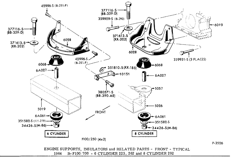

I’m finally getting ready to drop the engine back in my 64, but I can’t for the life of me remember how the motor mount pads were situated. Does anyone have a diagram or can describe the placement of the pads in relation to the engine and the mounts themselves? Thanks for any help yall can provide.

223, 262 or 292? I see a recent thread where you were working on a Y-block so 292 I'm guessing. I'll post the drawing of it here.

223, 262 or 292?
I’ve got a 292

I shoulda looked before I asked since they are all on the same drawing. I'm assuming 2WD. If 4WD just reply back.
and then for the side mounts if I’m not mistaken it’s just the one pad on top, right?
The two rear mounts on the bell housing use the same rubber parts that the front engine mounts use. Unless, of course, its a 4WD.
