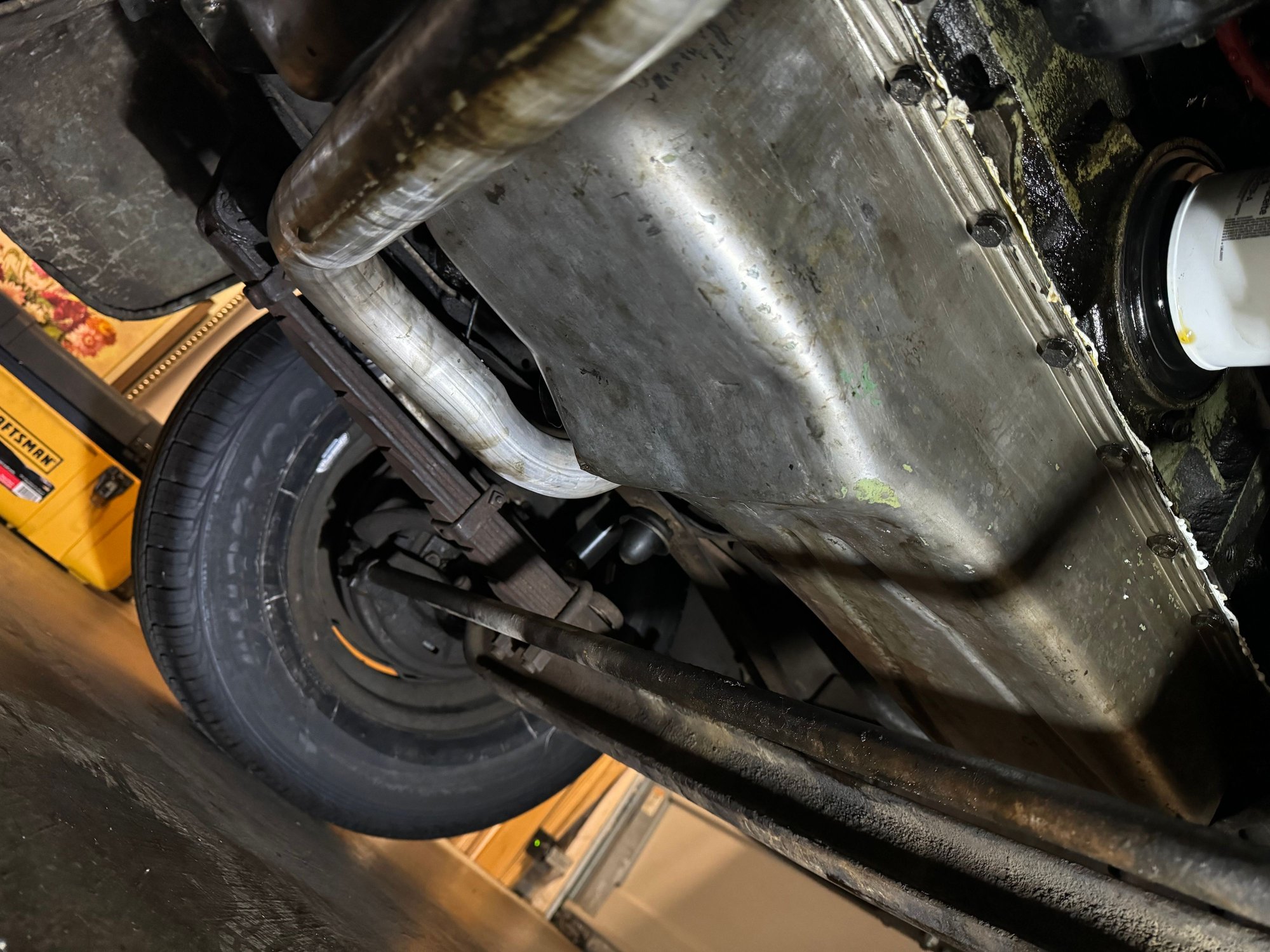

It would take a mighty big dent to reduce the volume of the pan by a quart; can you post a picture of it? Was there any damage to the suction screen or pickup tube?

The suction screen appeared intact and undamaged.

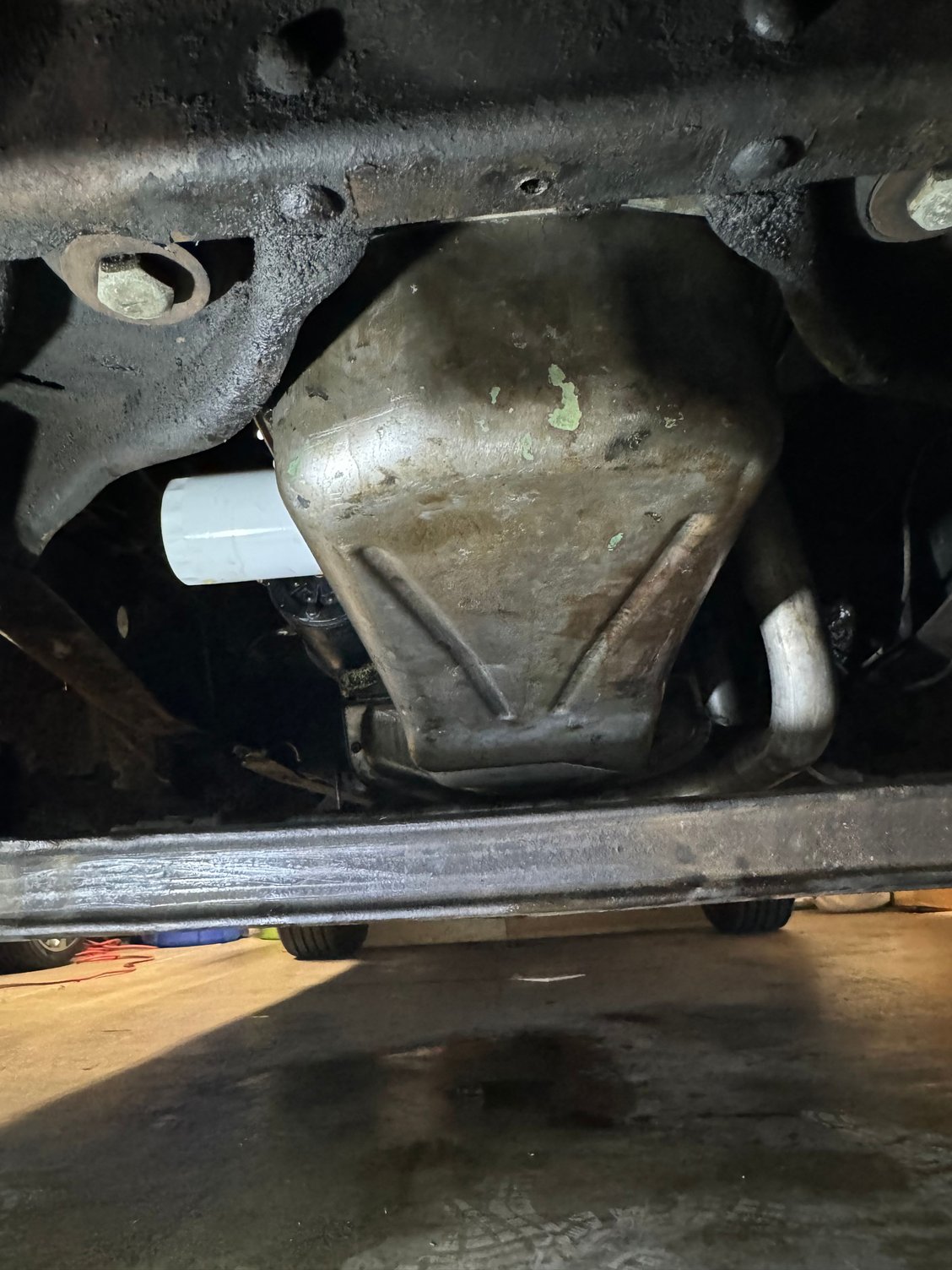

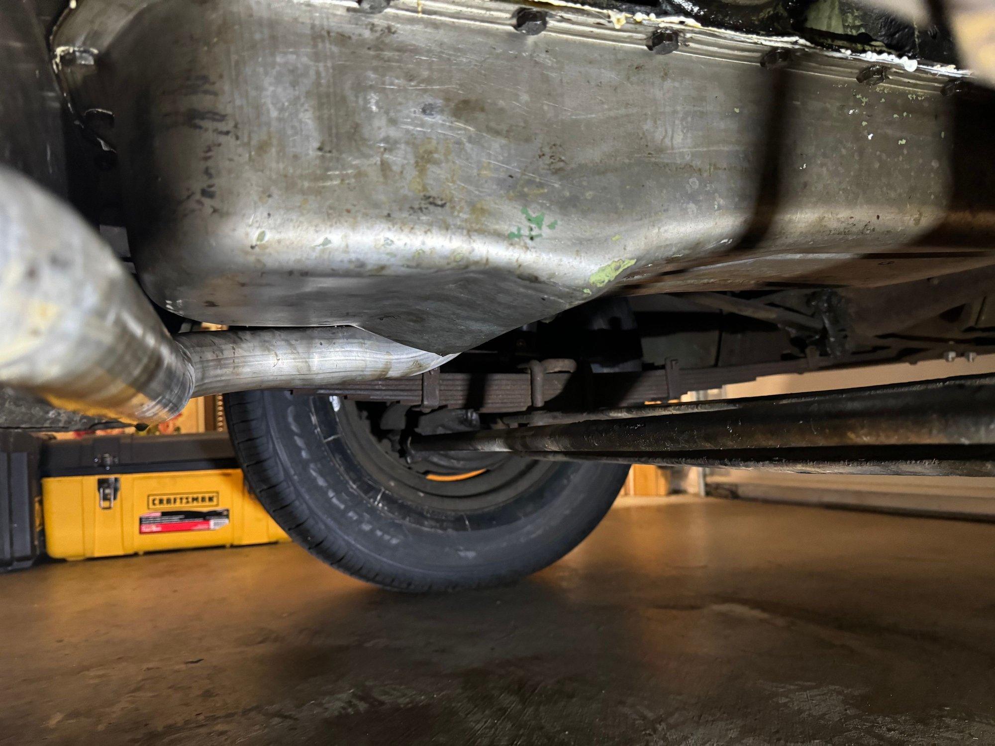

Here are a couple of pictures…
it’s difficult to see in the last picture, but there are two distinct indents that are inline with a subtle crease in the area between the drain trough and the tranny side of the pan. I didn’t notice it until I had the pan out.
thanks.

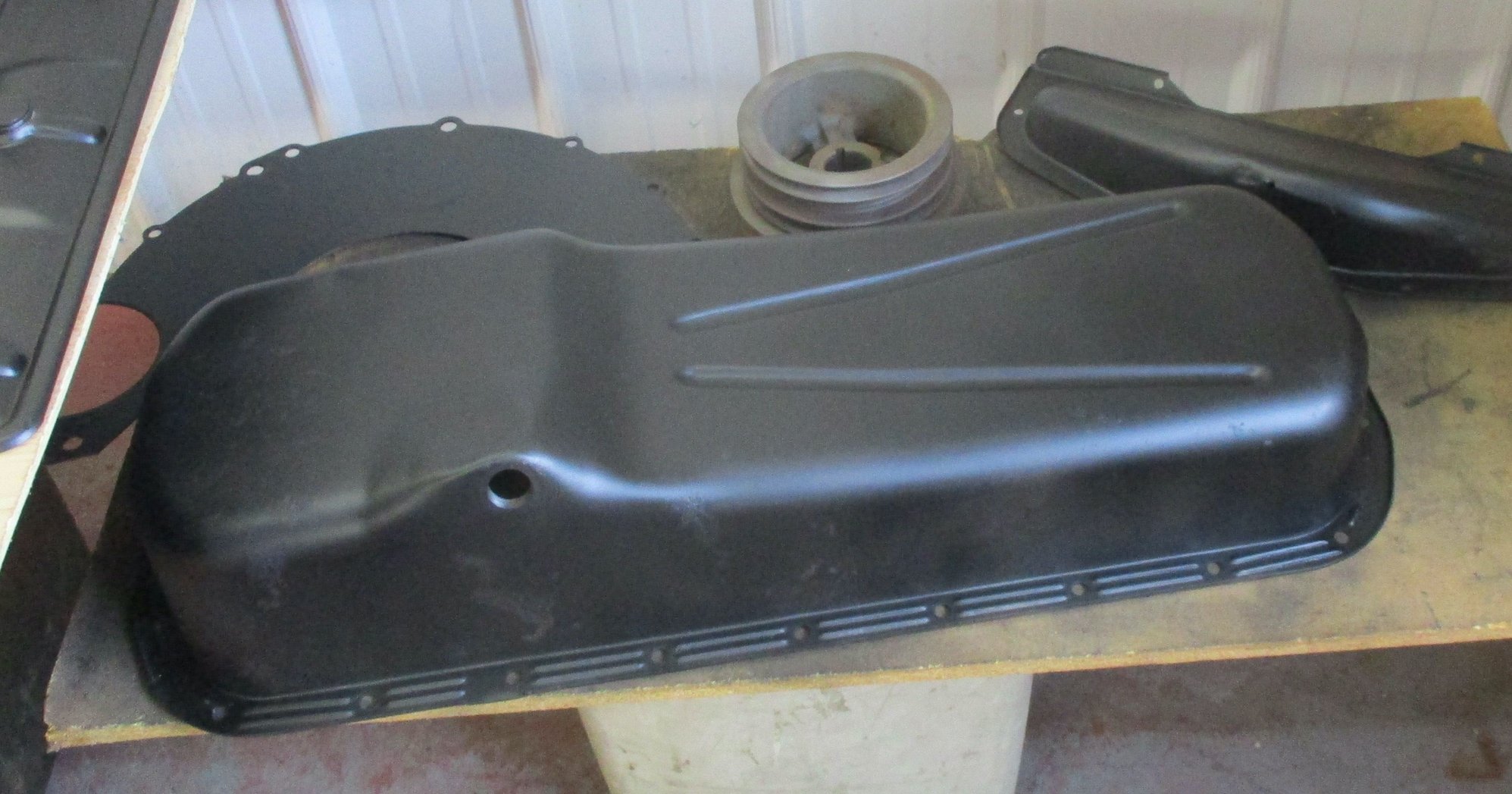

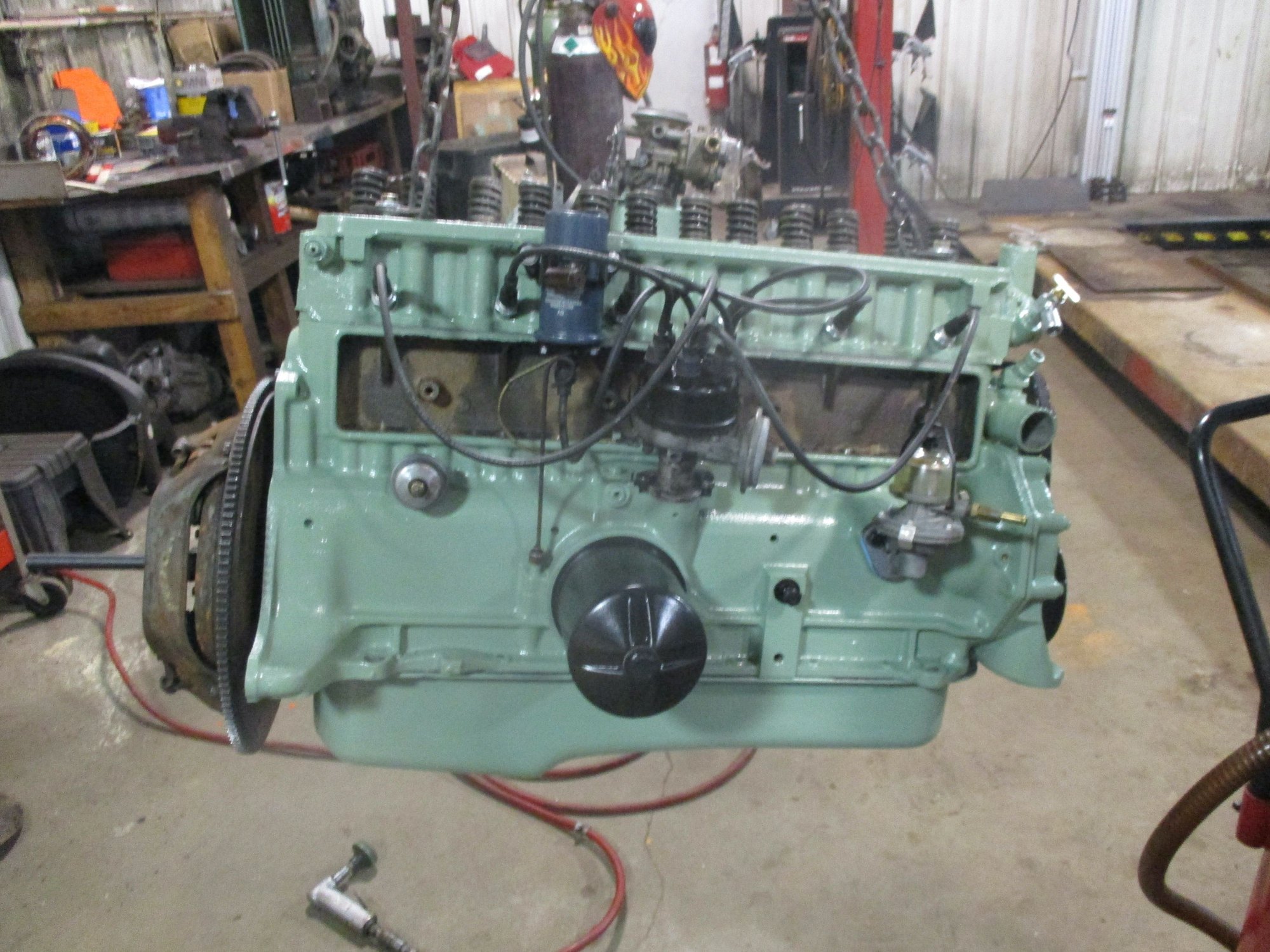

I have an original 52 215 I6 engine. Here are some pics of the oil pan:
I'd say your pan looks pretty correct, and it looks too like it would hold more than 2 quarts of oil.
The dip stick is 16 inches long. From the tip of the stick to the full mark, is 3.5 inches, and the stick extends 8.5 inches into the tube and motor.

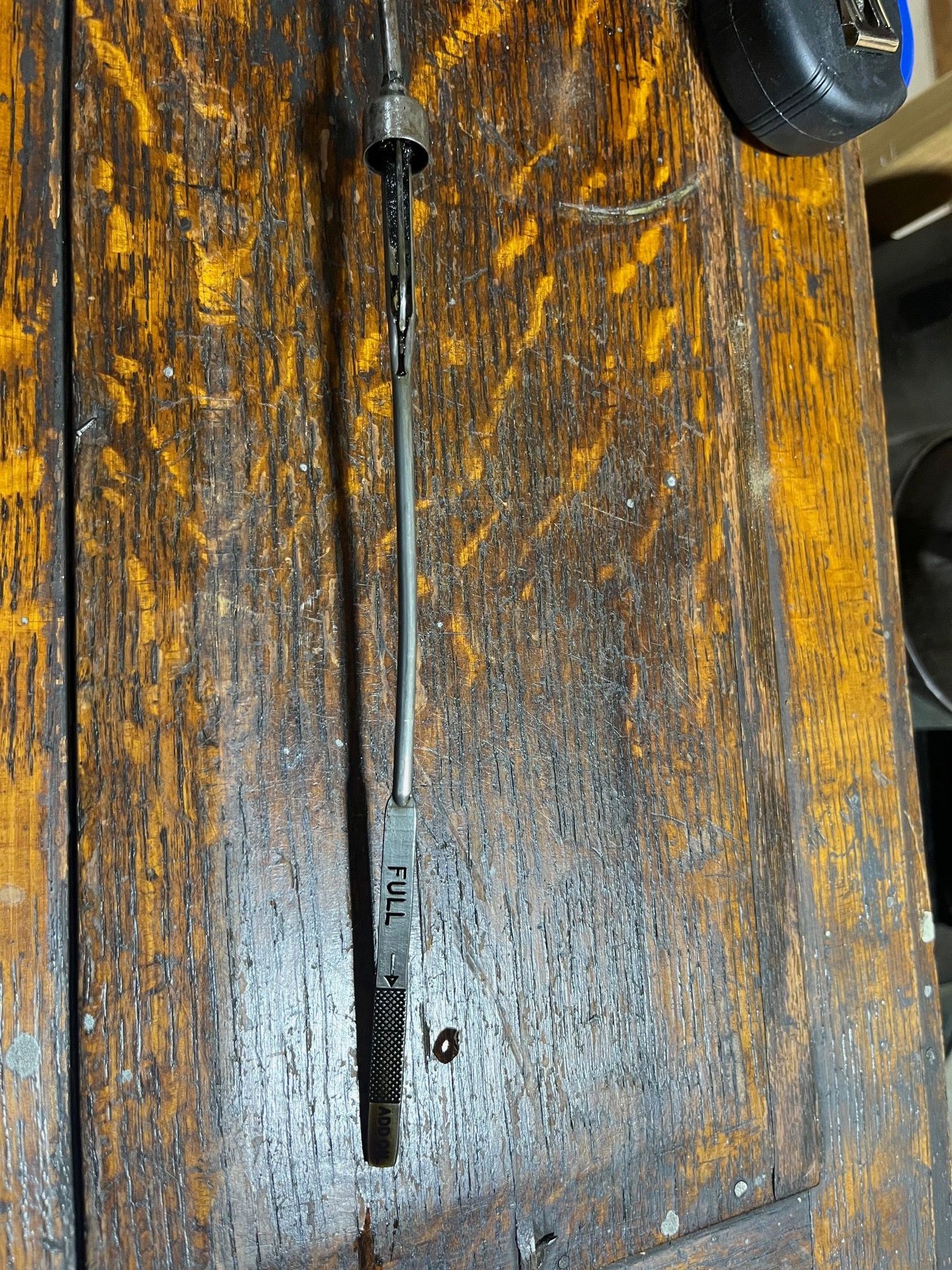

Old Jul 29, 2024 | 08:10 PM
Bob2246's Avatar
Bob2246
Joined: Jun 2024
Posts: 33
From: Poland, OH
Hi Jim,
Here is a picture of the dipstick,,,
Overall length as you described, but my "FULL" line is 2" lower than yours.
Now, the confusing part. I checked my level, and its about 1/2" above the FULL mark. Yesterday, I observed half-way to full after 2 quarts (or did I).
I just emptied the pan, and got a little under 4 quarts out of it. Makes sense, I filled with 5 ish quarts (I spilled about a 1/2 pints). 1 quart give or take in the filter, leaves 4 quarts.
I'm going to fill, again. a quart at a time, and observe the level on the stick to verify.
Still troubling, why the blue smoke?

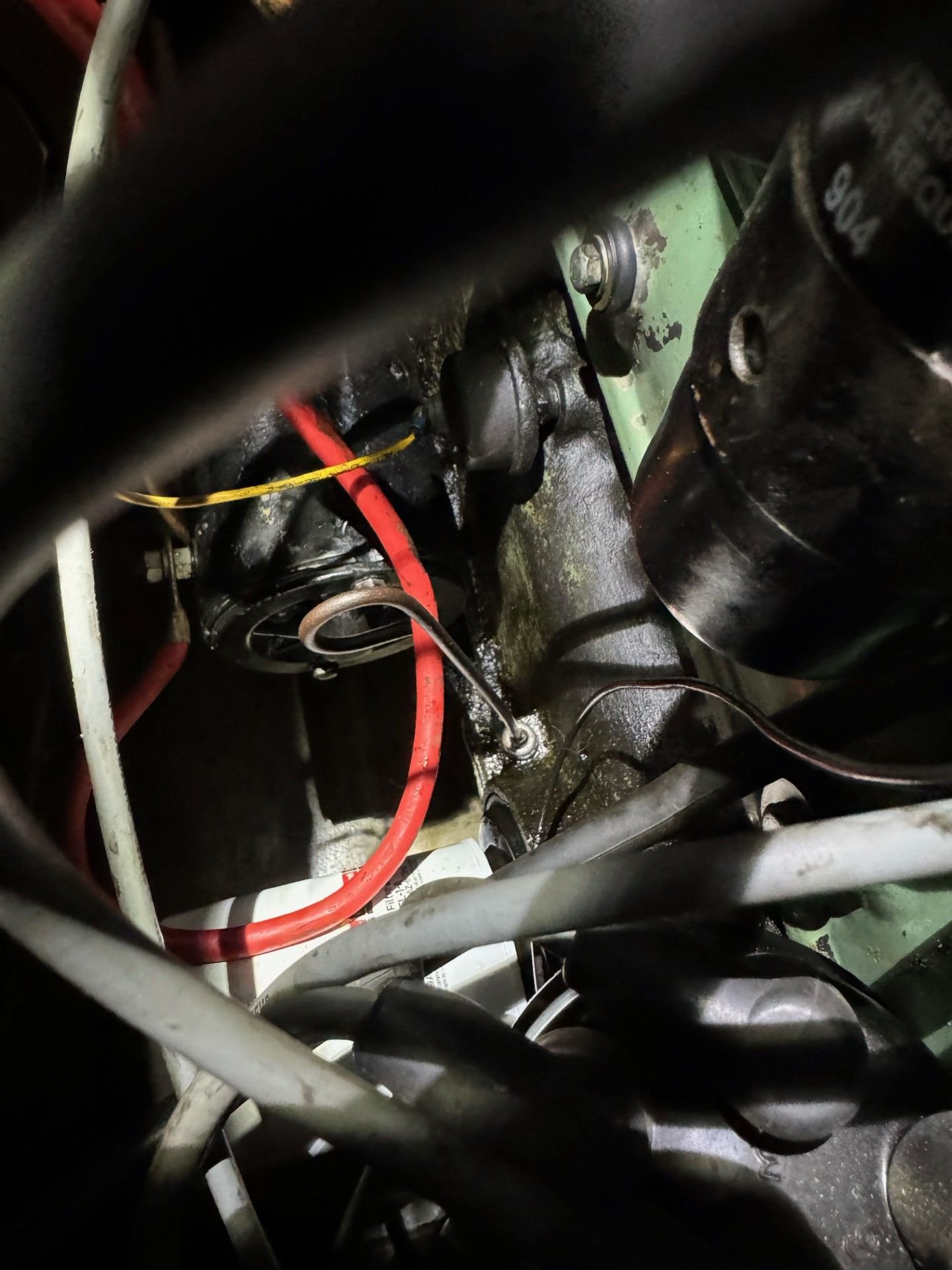

52 Merc - There is no dipstick tube...not to say there wasn't one.
This image shows the dipstick.
dipstick removed.
The shop manual doesn't have much detail beyond pointing to the dipstick. The description for the callout number (6750) mentions only a 16" dipstick.
Looking at the picture of Jim's (USCGPanel) engine in the message above, there doesn't appear to be much of a tube.
I wish I could get a pic from the same perspective on my engine, but my arms aren't long enough.

Old Jul 30, 2024 | 07:46 AM
52 USCG Panel's Avatar
52 USCG Panel
Joined: Oct 2014
Posts: 3,908
Likes: 1,191
From: Deerbrook, WI

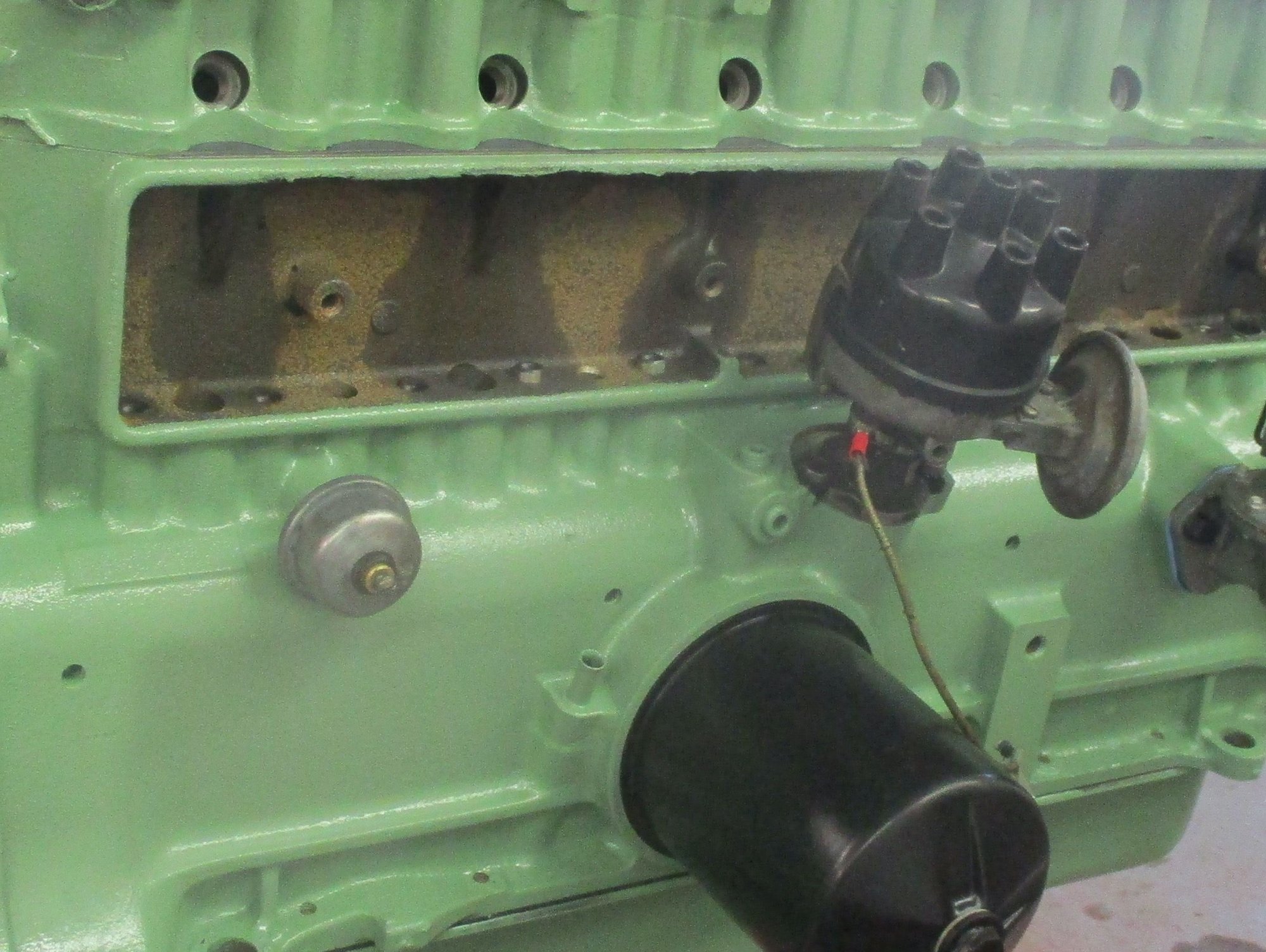

As you can see, there is just a bit of a tube for the dipstick right next the oil filter canister. It measures only about 7/8's of an inch. The dipstick extends just a bit more than 8 1/2 inches into the engine.
Here's a pic of the dipstick:

That tube has traces through my Ford part books under various part numbers and falls out of Ford's documentation in the mid-late 80s.:
9N-6754
9N-7020
B8A-6754-B
Roughly described as an Oil Level Indicator Tube with a .375" OD and a length of 1.420"
A commercial source: https://fixthatford.com/oil-indicator-tube-9n7020.html
