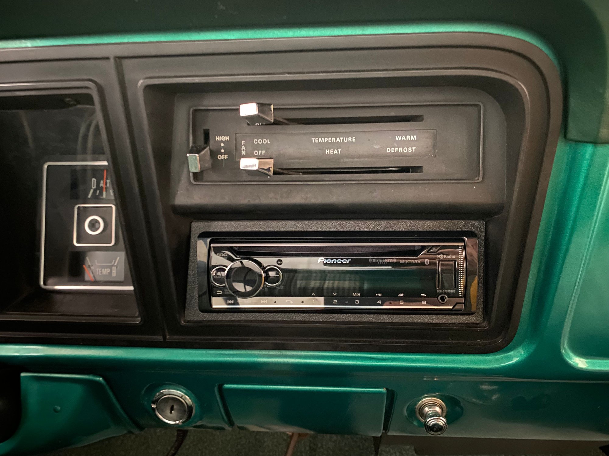

I am old school also. This is my radio all factory. AC is a different subject though.

I had to customize the opening but it was easy and the stereo is snug. I had to remove the metal tabs where the original stereo ***** came through and there is plenty of space behind the stereo if you needed to add a metal strap for support but my cd player is very light and a strap wasn’t needed. Also took a piece of black plastic and trimmed it to fit the opening and that’s what my mounting bracket sleeve that holds the stereo is mounted to. The tabs on the mounting sleeve are also bent to secure it to the plastic and metal of the truck to hold the cd player in place nice and snug.

i did similar as tugboat 76. trimmed the mounting bracket, filed to fit in order to leave as much bracket material as possible. fitment is snug and solid, looks like it belongs as well.
