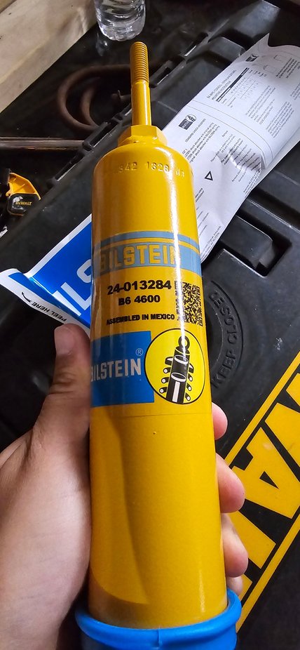

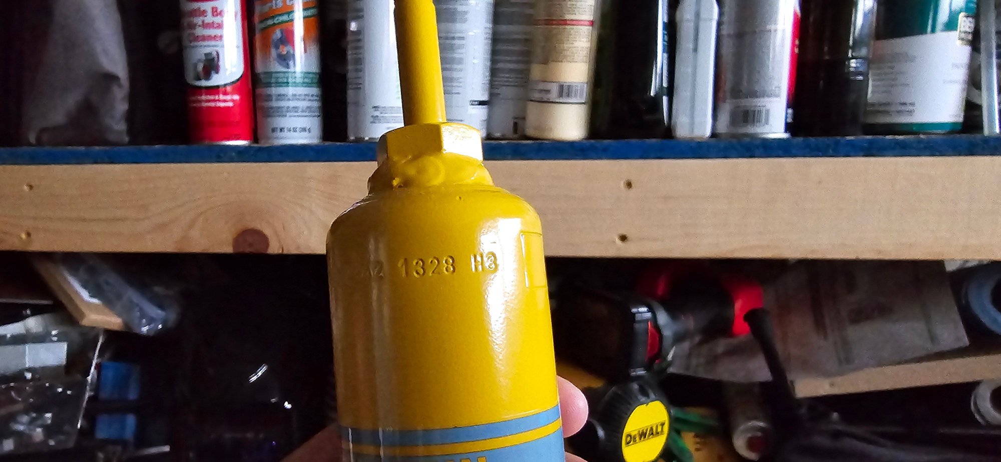

I bought 2 of the 4600s for my truck recently
They're still in the boxes. Give a bit and I will go and check them and take a picture
Old Jul 28, 2024 | 05:58 PM
Slonison's Avatar
Slonison
Joined: Feb 2024
Posts: 145
Likes: 37
Both of mine look like this

I did not do loosen the spring faster as I did'nt think I would need to but now I'm going to try that now that l I have axle lowered and tension off the springs. I really thought it was a low as it could go already. Thanks for the time you spent taking photos. I have exactly what you have - same box and same etched #s.

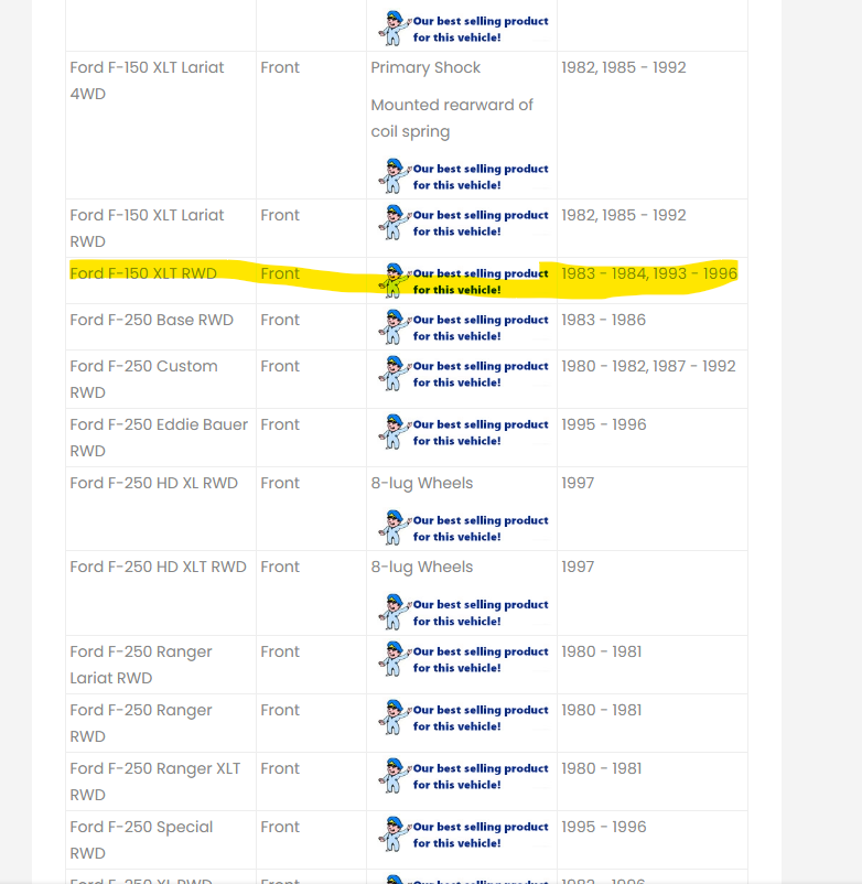

I googled that part number, shows all 4wd only.

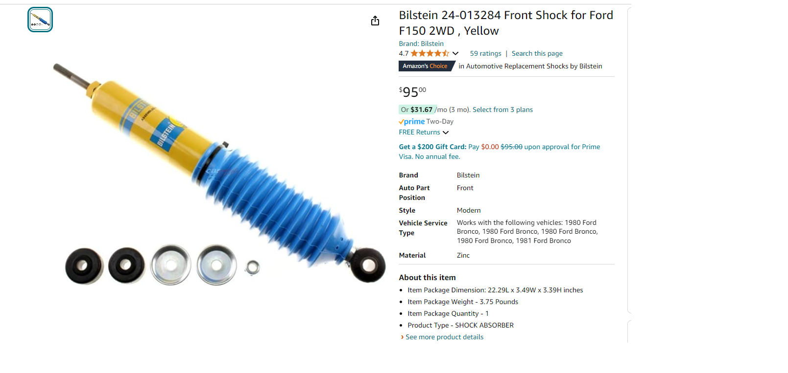

I googled the 24-013284 and it indicates 2wd as well as 4wd. Are you referencing 24-13284 on your search or the 1328 H3 etched ? I checked Amazon Bilstein where I bought them last year and as well as shock warehouse that indicates both 4wd and 2wd. Not sure what to think now that you mention what you saw.

I googled the etched number shortly after that response and even the etched number, first result summit racing indicates it's for 2WD.
