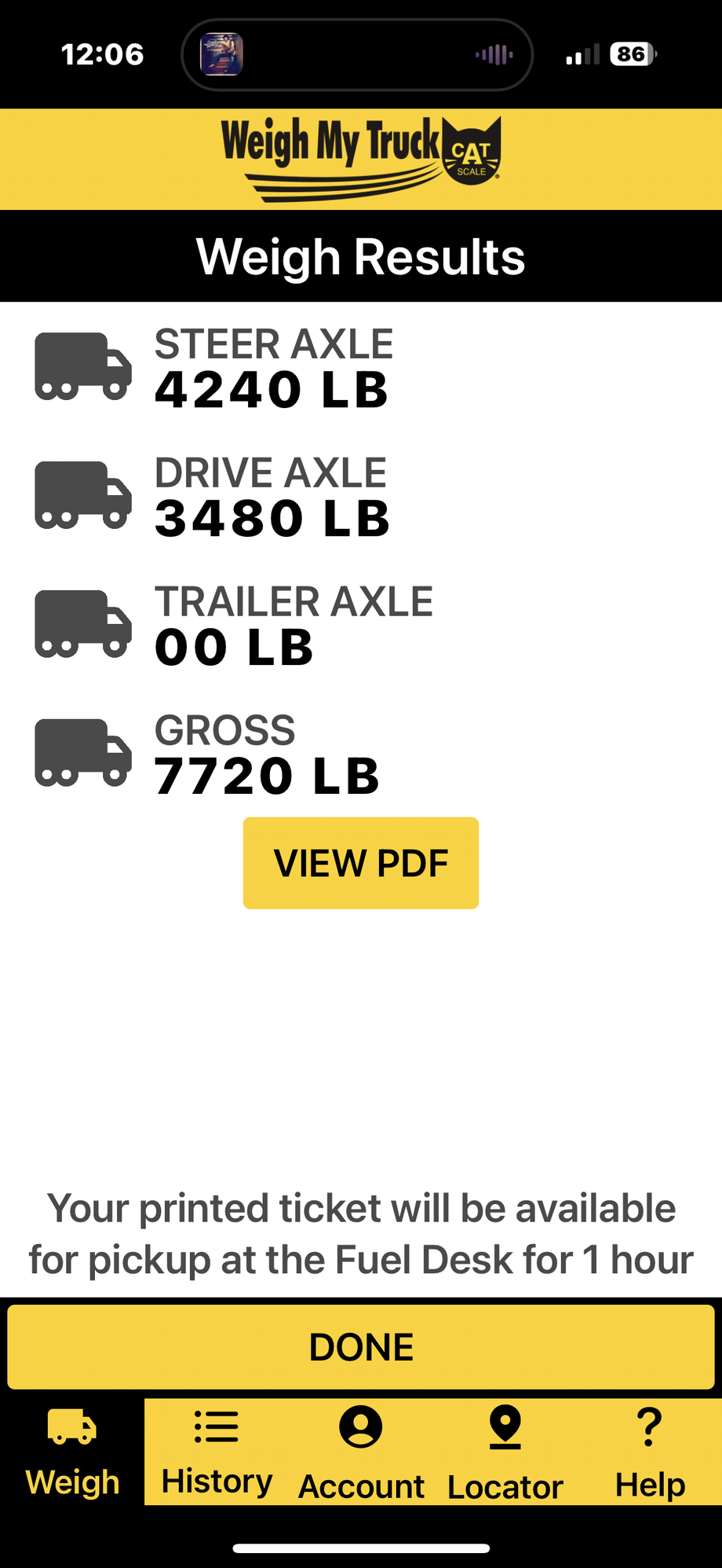

2023 weigh ticket below. F350 with full tank, Retrax bed cover and aftermarket wheels and tires and one 185lb driver in the truck. Maybe 100 lbs of tools. Short box, Lariat Ultimate (no sunroof). Payload sticker says 4,038 on door.
This 7720 gross is with diesel engine or 7.3?
