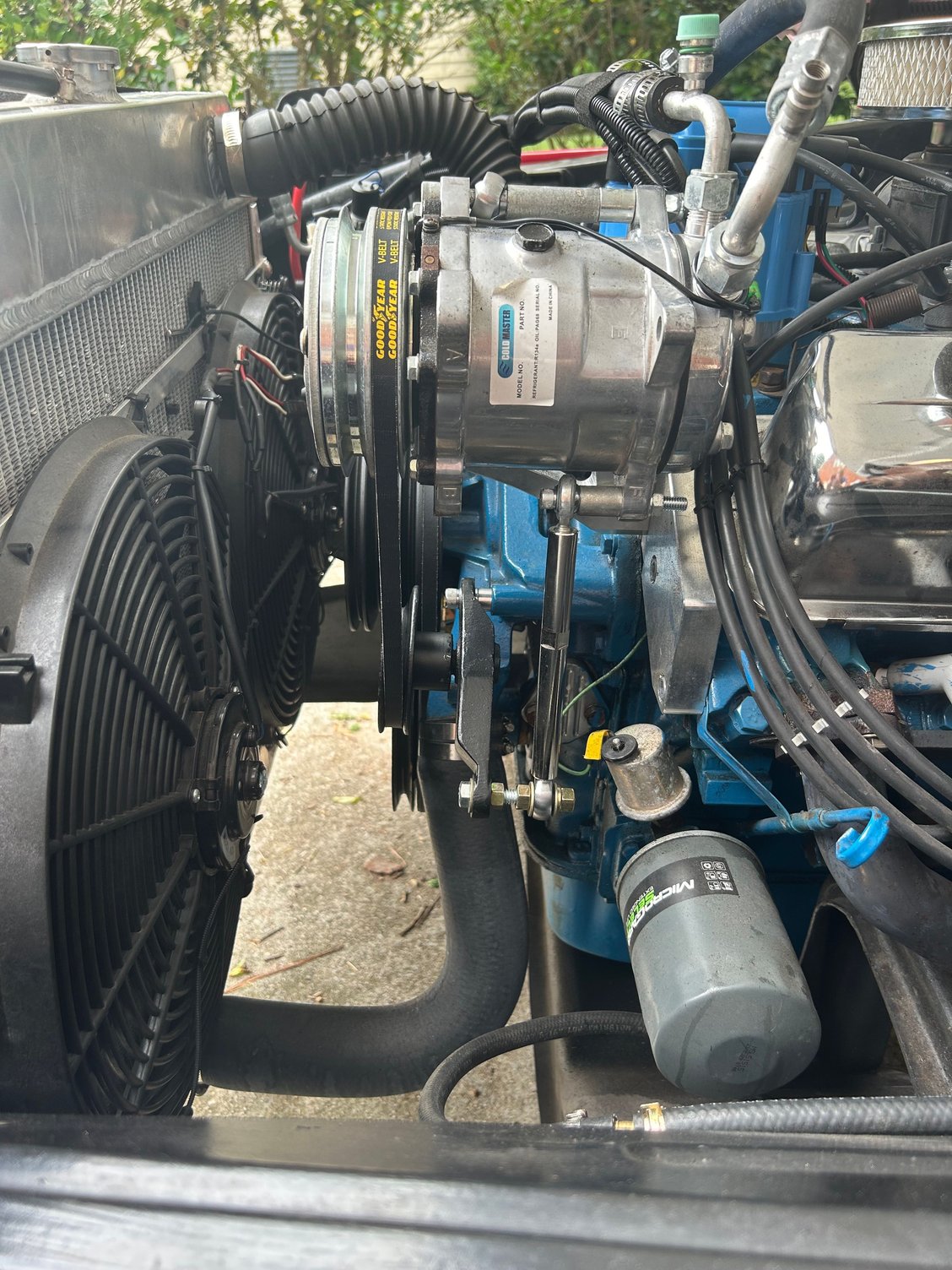

Photos? Is there an idler pulley? Pulley sheeves in good alignment?

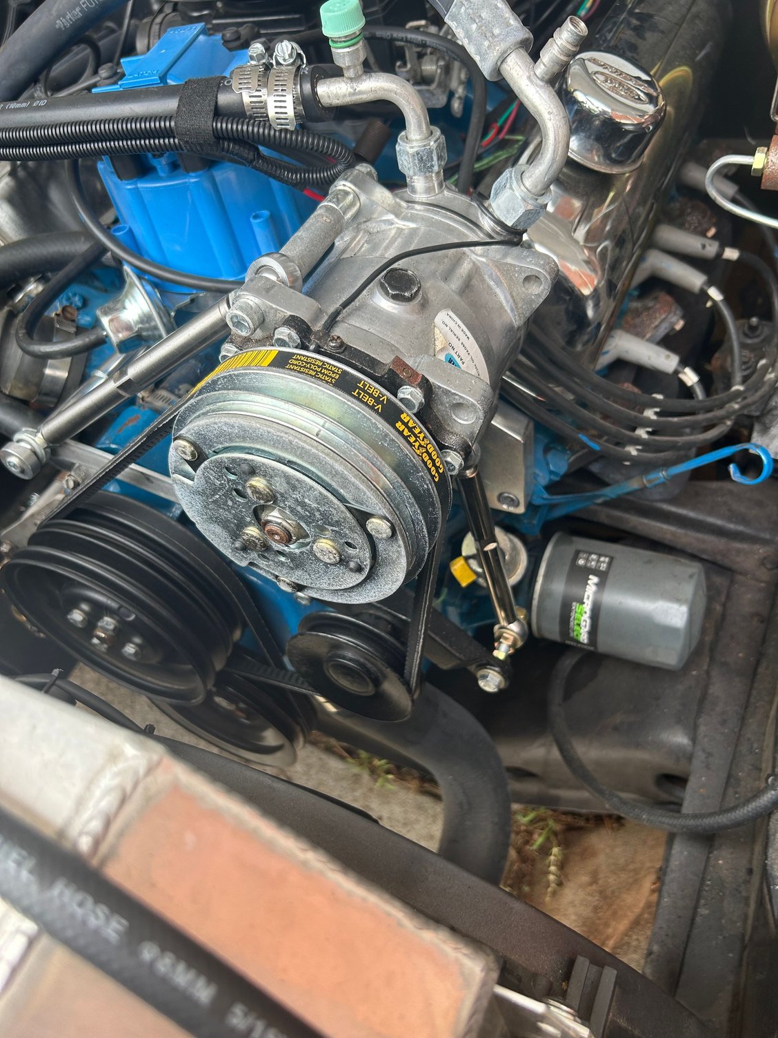

Here are the photos.

Looks like you need another belt,there’s dual sheeve on your compressor, and the truck. You also need a dual- sheeve idler pulley, I’d say.

The outer pulley on both don't match up. The water pump pulley has a the space between the outer and middle groove. This is a universal A/C system and the closest thing I could find in the year of my truck for the water pump pulley. I also had to figure out how to have an idler pulley. Its like the one on post 13 in thread https://www.ford-trucks.com/forums/1...d-pulleys.html

Unless it is an optical illusion from the angle of the photo, I would say your problem is 100% a belt alignment problem. The idle pully is not in alignment with the A/C pully. I can't tell if the water pump pully and the A/C pully are in line. The belt will make a noise when under load if there is a lot of side load from misaligned pullies. The pully appears to be way out of alignment on this setup.

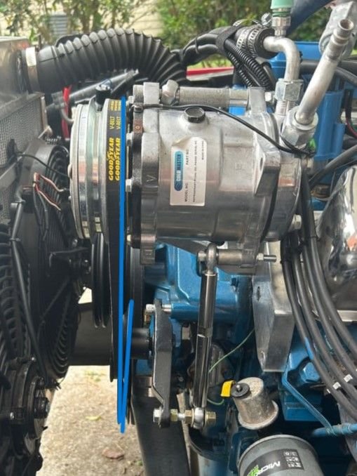

Run a straight edge along the back side of the A/C compressor pulley. The straight edge should run from the top of the A/C pully to the bottom of the idler pully and make contact with all four points (top and bottom of the A/C pully, top and bottom of idle pully).
The blue lines represent the extended line of the existing pullies. As you can see in the photo, not only are they not in line, but the idle pully is tilted back several degrees.

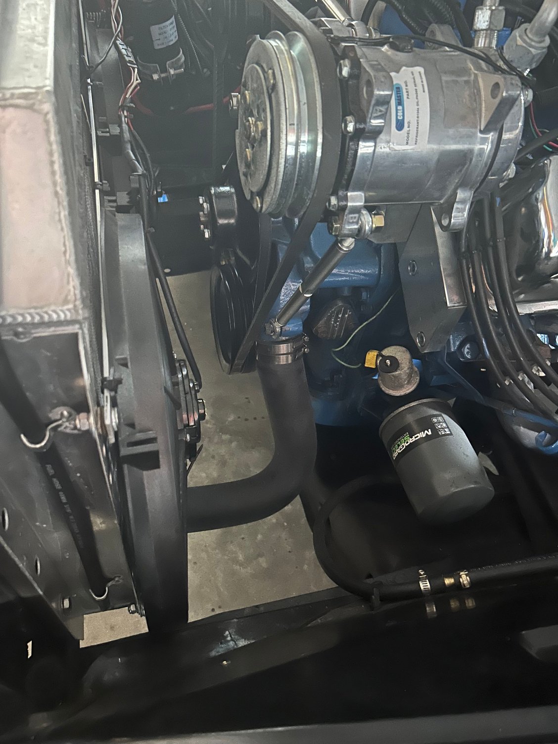

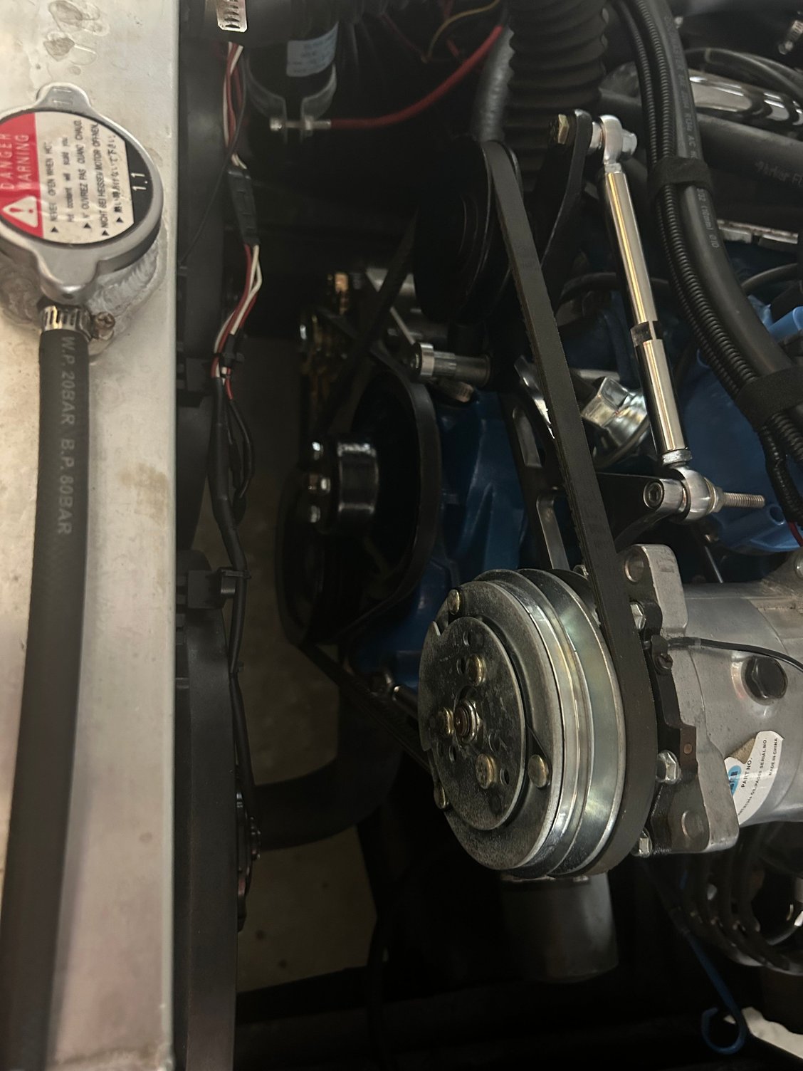

I worked on it this weekend. I found a belt routing diagram for the motor on a mustang forum. That with what y’all said I think I figured it out. I finished and found no belt squeaks. We will see how well later this week when I take her out for a ride. I appreciate your help.
