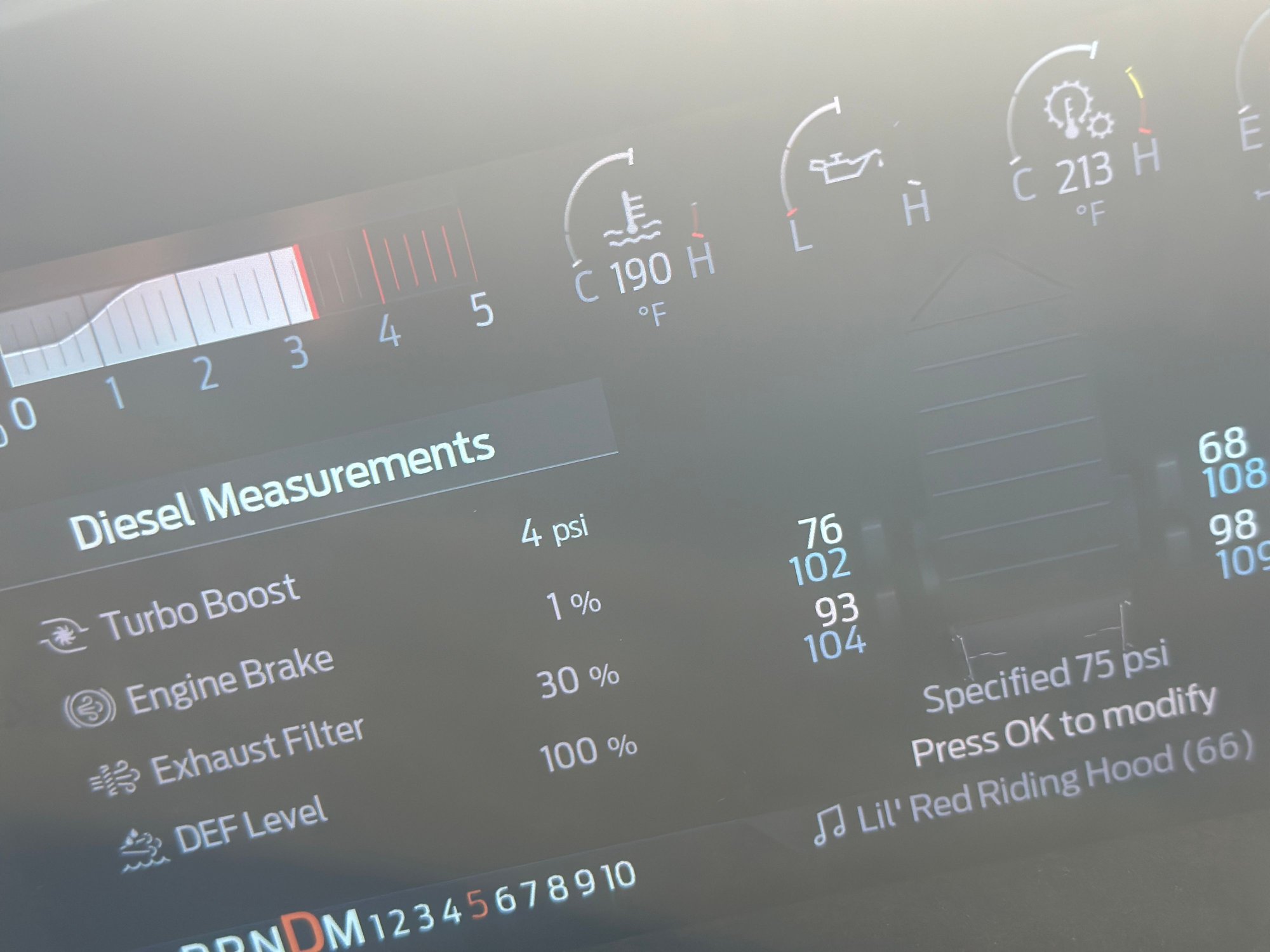

You can see here my typical Exhaust Filter % at 30% when truck usually goes into Active Regen
