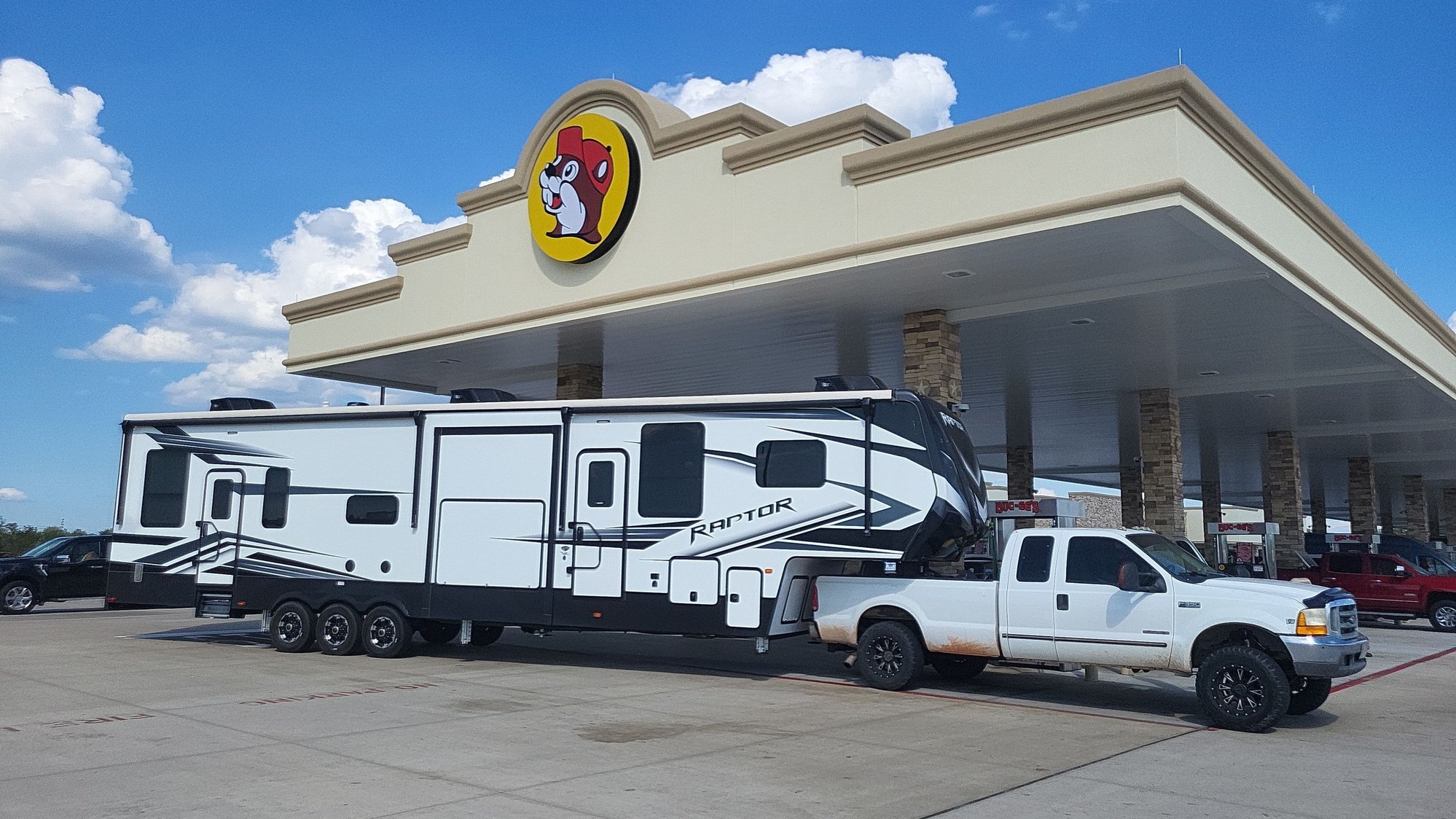

After doing the balanced assembly, disconnecting the wastegate, fixing all the exhaust and boot leaks and using phps 40hp tow tune, I towed my 5th wheel about 2000 miles from New Mexico to New England, the truck and trailer loaded came across the scale at 30klbs. EGTs were never an issue except a few hills they crept up to about 1225ish before coming back down. I was very happy with the trucks performance but felt like I was running out of fuel on the bigger hills and with my foot on the floor HPOP pressure was sitting at around 1800, would only hold 3k if I wasn't on the pedal that hard, I didn't have a way to monitor ipr duty cycle, any recommendations on what to take a look at? or is that normal with the 15 degree pump with stock injectors
Squatting a little bit with 7500lbs on the rear axle
Thanks again for all the help,
Jacob

You scaled at 30k total? How'd it feel with that load? Braking?
What boost numbers were you seeing?
As for ICP pressures, you've got a problem. One of a few things usually. O-ring leaks in the injectors, ipr valve or hpop getting old, bad ICP sensor or lpop not keeping up. Or fuel pressure being low, will tax the hpop trying to make up the lost volume of fuel.
If you're gonna keep that load, look into air bags to level out the squat. What trailer is that?

30,100lbs total and the brakes were great the trailer has brakes on all 3 axles so no issue there, The highest boost I saw was 32psi at 3k RPM but usually id try to cruise at about 2400 where boost was about 20psi, we were moving cross country so everything was in the trailer so I wont be loaded that heavy next time and its a 2021 keystone raptor 423,
I did notice that my ICP plug was wet with oil so ill probably start there but its hard to get it to show as I only see the drop off on hills pulling that trailer
