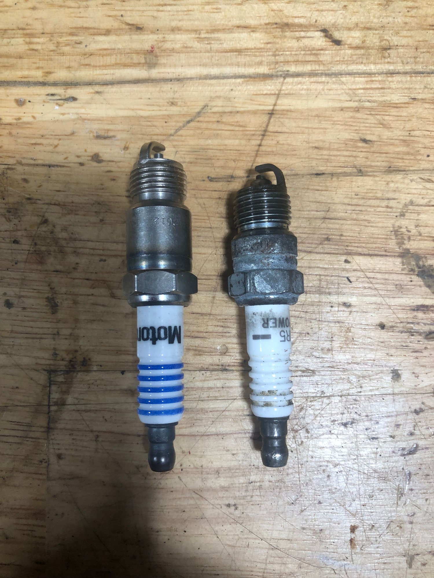

The spark plugs aren’t even listed for the engine and they’re black. I’m used increasing the gap, not decreasing it.

Just removed old plugs.
