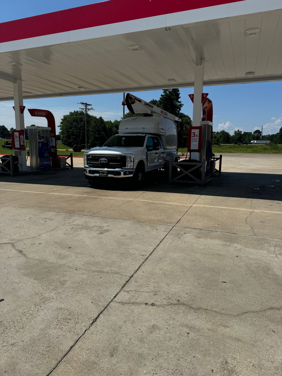

This is what the manning looks like. Feels a little off with the hitch. Elevation off grid is different but they also shorten the frame for the introduction of the bed and liquid spring, thus using a different hitch setup. You can see the patch panel (spacer) if you look forward of the bed behind the cab.
